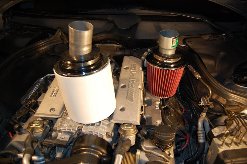

Another subject ive been debating about is the intake. I really dont see the point in spending 600-700 bucks on the dual intake kit (sl55 kit). is it really wirth it. i was going to just replace the stock air boxes with K&N's but then i feel like the emgine will be sucking in hot air since its not connecting to the inlets in front of the car thats getting cold air. Any suggestions?
This is what I did for around $100 dollars. Top it off with a black paint job, and it doesn't look so bad. I wouldn't recommend PVC as I used. Find a metallic enclosure. Heat shield it all, and your good to go. Dyno results showed a 20WHP/20WTQ gain.
Doesn't seem too stock or stylish, lol. But it looks like it does the job and keeps the incoming air cold. have you done a DIY?
