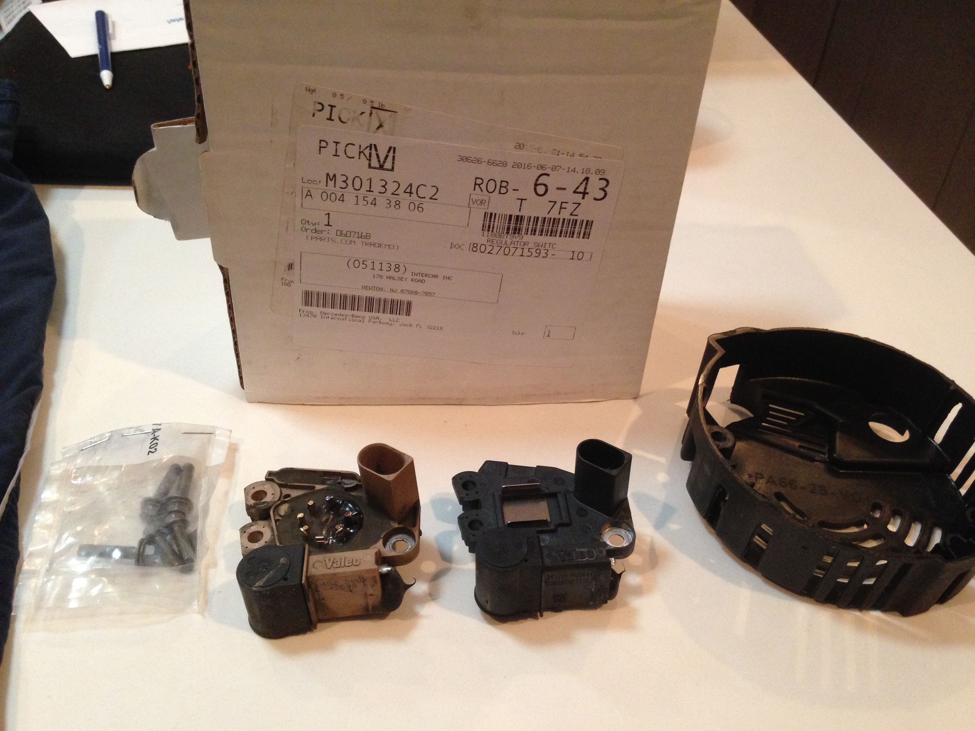

SAVE SOME $$$ - Valeo Voltage Regulator Replace
lots of high mileage c32s that will probably have a alternator quit as my valeo alternator did go out at 115k miles on my 2003 C32 and hope you guys dont waste big bucks buying a new valeo to replace your dead unit.
i researched several posts on our alternators and most posts report you cannot replace the voltage regulator on the valeo alternators which usually is what goes out on these alternators as the brushes in the VR wear down and dont make contact on the slip-ring.
the cost for a new Valeo from the MB dealer is around $1000 and reman units are around $500. there are other very cheap reman units of other brands that are crap and dont hold charge which i learned the hard way installing one from a pep-boys for 300 bucks and couldnt run my AC and the headlights flickered like crazy.
I wanted to report that you CAN replace the valeo voltage regulator part #0041543806 (cost $100) which fits the OEM valeo alternator #112-154-02-02 and is a 5 minute drop in fix and your alternator is good as new.
you have to get the alternaor out which is not easy (i had a shop do that) but once I had the alternator out, to replace the VR you just unscrew a couple screws on the back plastic cover (see attached pictures) and can then see the voltage regulator. which is held in place with 5-6 other hex screws that you easily take out. when i took the old VR out you could see the brushes worn down to the nub and not making contact on the slip ring.
got the new valeo VR and screwed it in and then to ensure it worked and the bearings and everything was in working order i took the alternator to MG Auto Electric which is an alternator rebuild shop in Arlington Hights, IL and had the owner Larry (great guy) test it and he said it was good as new. had it put back in my C32 and its working great and can run all electronics with no issues (AC front and rear, headlights, heated seats, radio, defrost, etc)
some pics attached of the alterntor, Voltage regulator etc.
