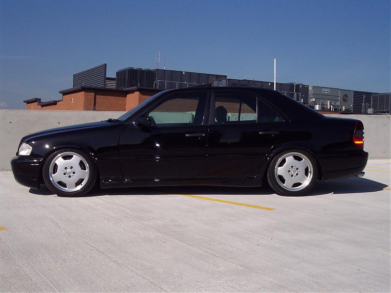

H&R Springs, #2 pads in the front, #1 pads in the rear. We measured the trim at the front and back (20" front, 21" rear) One inche of rake from the front to the rear...

I got my wheels on finally...

H&R springs with Bilstein shocks #1 pad in front and #2 in rear.
