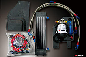

This is simple alloy primitive customize bracket, just to hold the cooler into the rear cover,,
*sensor is a good idea, prefer to put it in case of doing additional cooler/oil pump/hoses...
