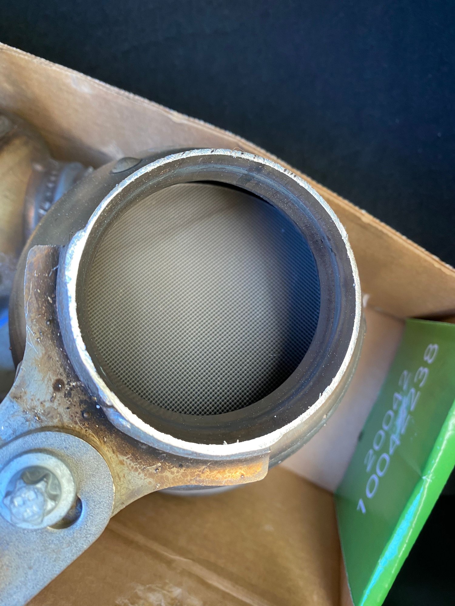

I just had secondary cats removed on my 2019 with PE.
I'm guessing if the particle filter was in the secondary cats I would've gotten a CEL right?

I really can't put into words how much better it sounds from the day I got it from the dealer. If it sounded like this day 1 stock, I would've never touched the exhaust or done any mods.
However, I'm skeptical to believe the particle filter is in the secondary cats because I think it still sounds a bit quieter than the press cars. I'd say I'm about 90% of the way there but there is still something holding it back. Also, I seriously doubt removing the particle filter would give no CEL.

When I look in the cats I just see the normal mesh material.

Here are pictures of both sides of both secondary cats, I don't think the particle filter is in there.

Looks like we've been had then? There's no other possible place for an GPF based on the full exhaust photos earlier in this thread.
If our cars do have them, then they have to be before the secondary cats.
