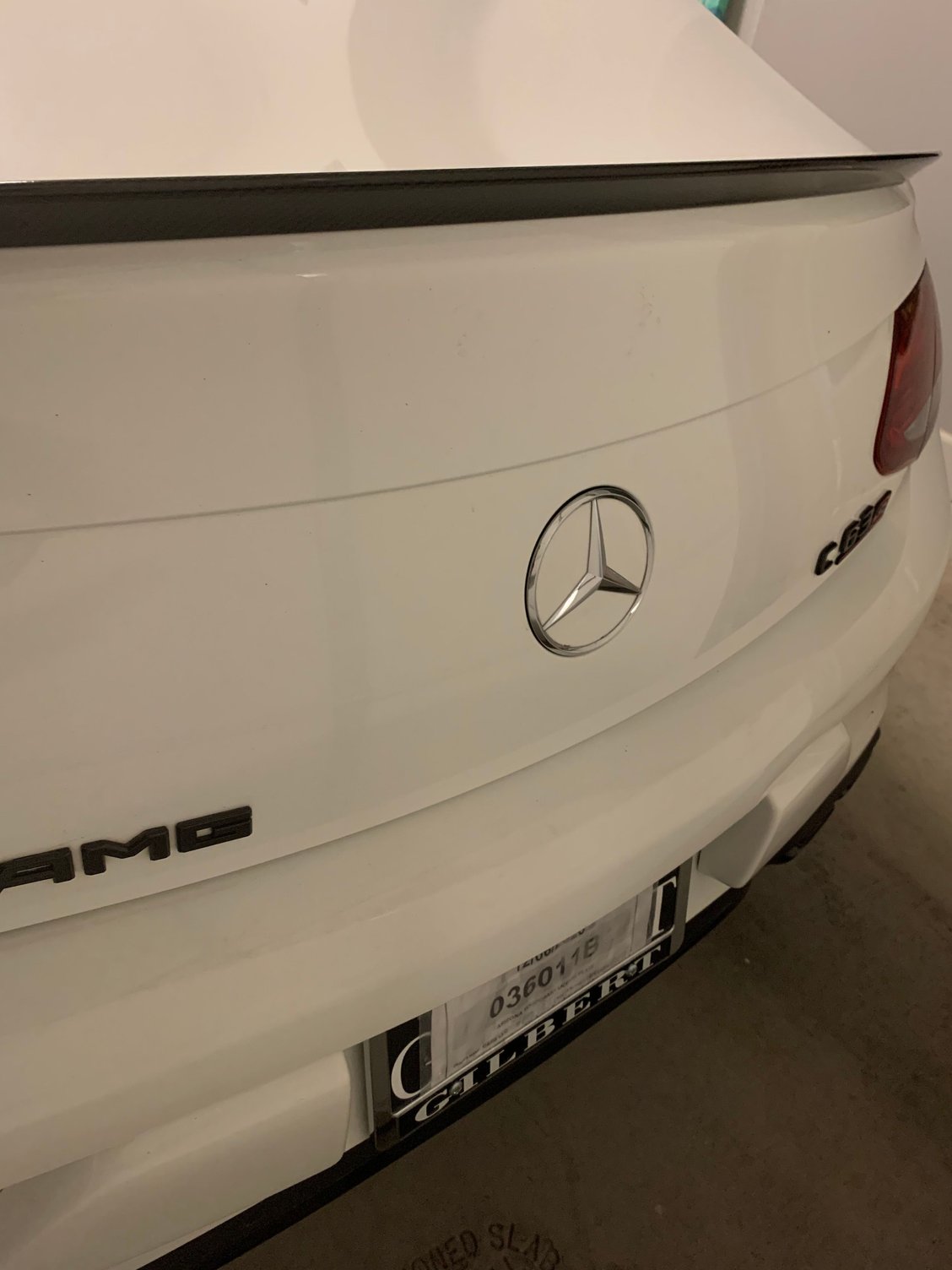

Fellow AMG folks, I had my badges replaced with black ones today, except the shop couldn’t remove the Mercedes star on the back. The others came off easily but this rebellious star didn’t budge, even with heat gun, they just couldn’t get the wire to get behind it to break the adhesive. They didn’t want to be too aggressive since the camera is attached to it.
Any idea of what I can do now??

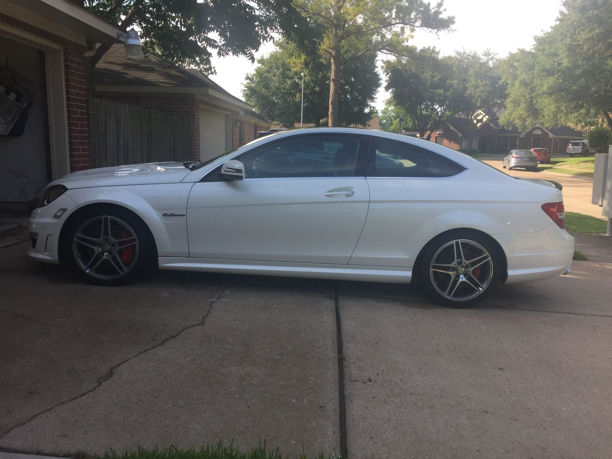

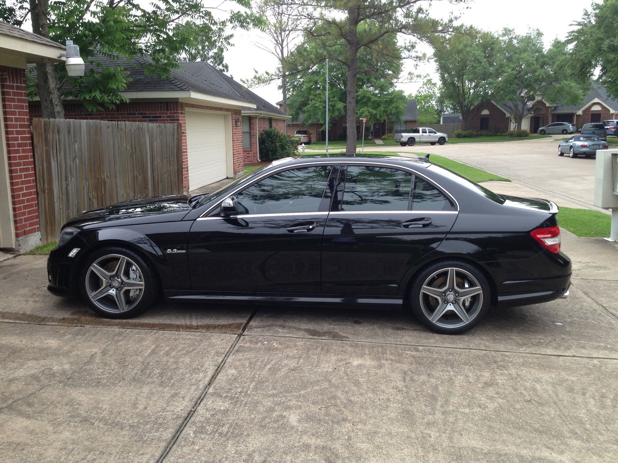

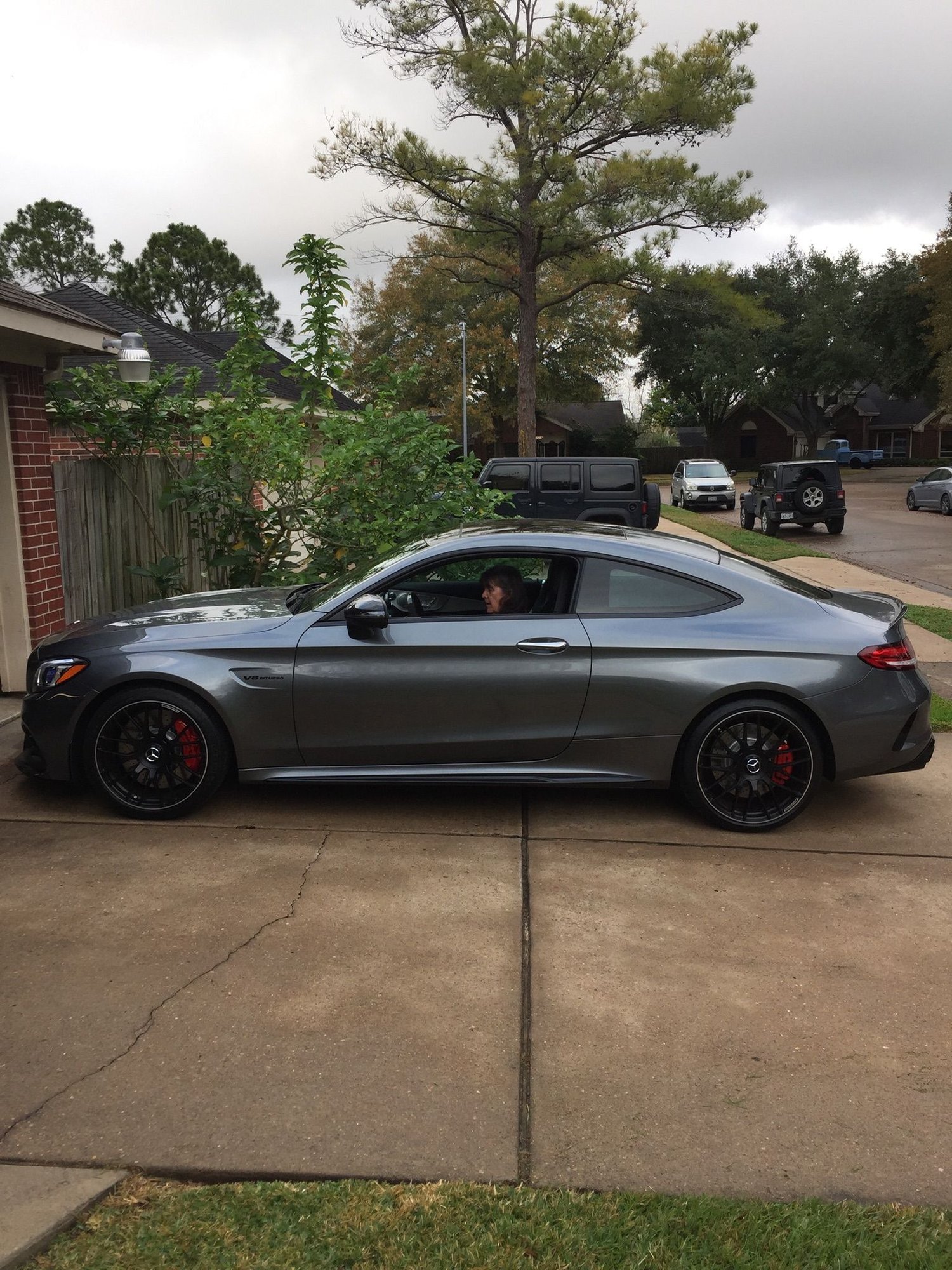

My wife turned 68 last August! It’s her third one. Each one has been faster than the previous one. Frankly she’s a great driver. However I will admit driving and riding has a different effect on my nerves. 😄
In progression...

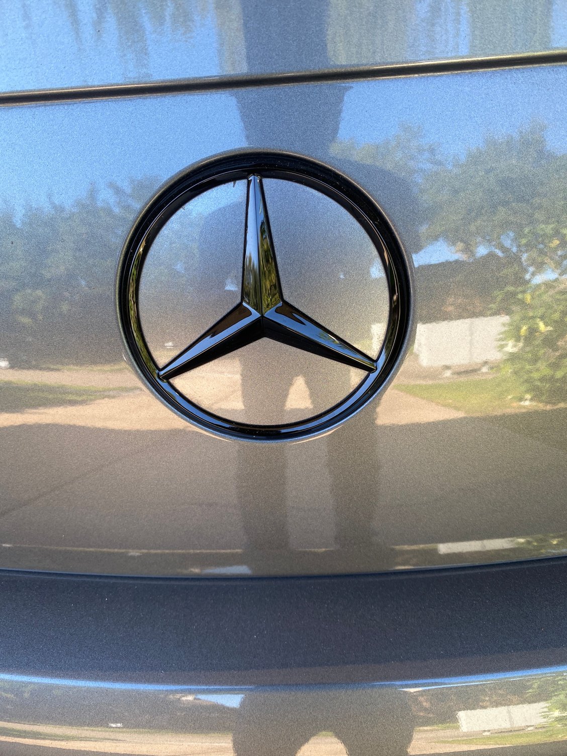

I apologize if it gives the appearance of high jacking this thread. So, back to the rear star, finished product.
If you zoom in real close you’ll see a small scratch at the top of the star. It was a bear getting it off. But worth it.
