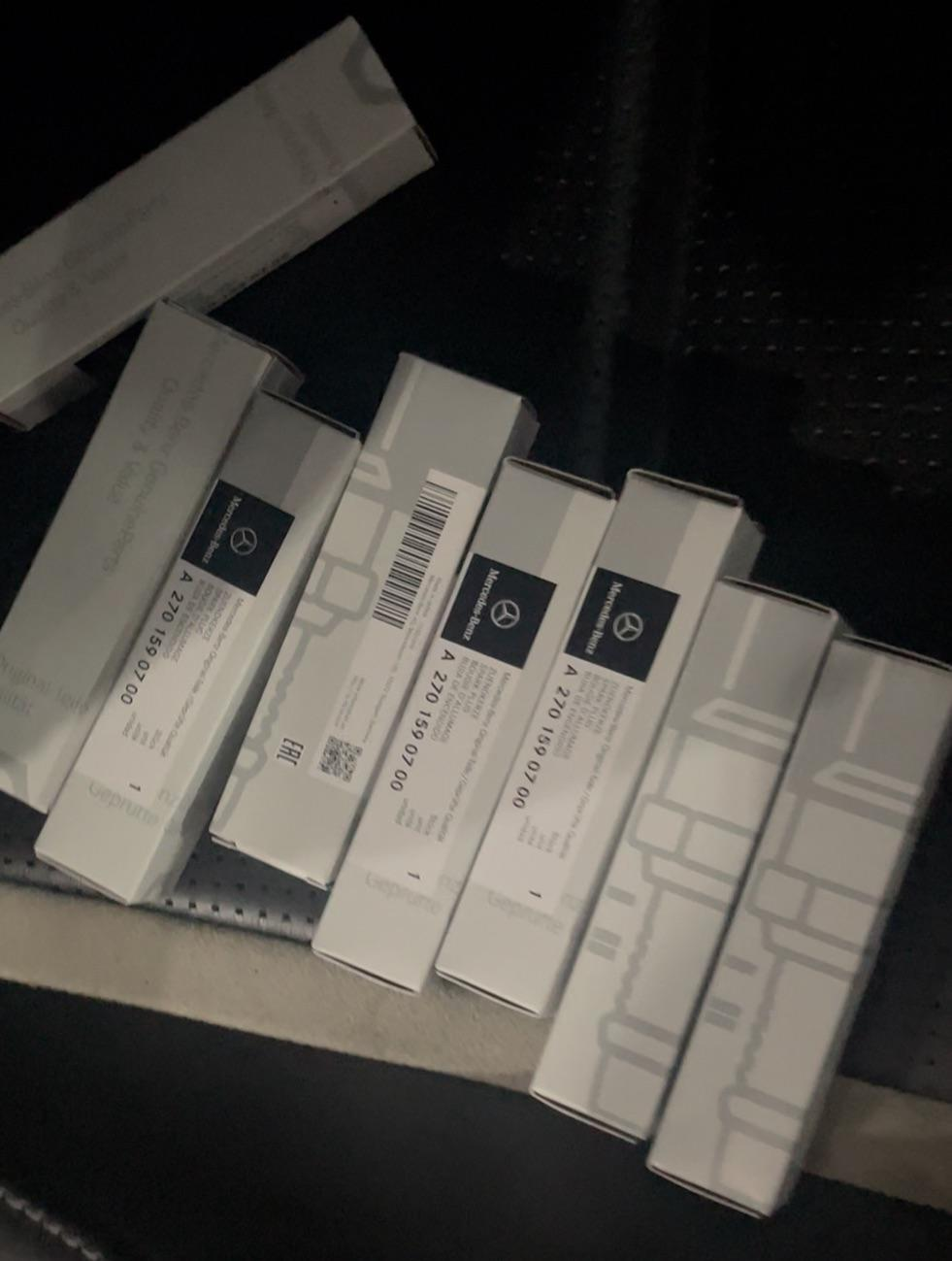

Did the dealer just give me the wrong spark plugs?
I got these spark plugs for my C63s from the dealer, and I told the parts guy my cars vin number and everything and when I googled the part number on these plugs many websites said these are not the ones for my car while the parts guy insisted that they the correct ones. so I’m a bit confused right now. Would these work on the M177 or should I return them?

Merc USA parts site say they’re for 2.0L L4 - Gas specifically in the Metris and Sprinter
Those plugs are for a sprinter van 😂
. The spark plugs installed at the MB dealership were Part# 0001590500. I have a 2019 C63s coupe. The plugs were replaced on the 5 year Service in April 2024.
Also note photo below for reference

bruh I'm cooked

uhh the mechanic installed them, but I still had my doubts. The dealer parts guy did say if they were the wrong ones I could return them even if I installed em so hopefully they will accept it lol.
That's not good man lucky you checked. Whatever you do, don't drive the car like a madman until it's got the new plugs. Dealer must take those plugs back and give you the proper ones, it's their fault.
Our cars are sensitive with the plugs and wrong ones will cause problems. Not trying to stress you but having the wrong plugs can create a lot of issues including damage to the engine as noted here. So get those plugs out and put new ones in asap.

funny thing is, I replaced those plugs cause my car was having a misfire and just bought new coils cause new plugs didn't solve the issue. Thanks for the help appreciate it

This is bad.. these aren't even sold for any eight cylinders so the fact the parts person grabbed eight is just brutal. Sorry you gotta make another trip back.

Yeah either their program is faulty or something cause they kept on checking these plugs compatibility with my vin number and their system kept on saying it's compatible. I wasn't bothered with that so the parts guy just replaced them for me and apologised lol.
