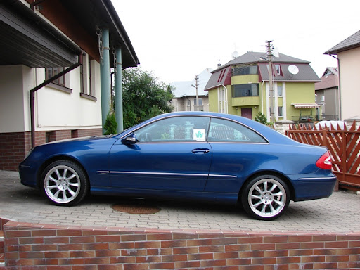

ld.Scorpion's Avatar
Joined: Sep 2011
From: Alicante
MB CLK w209 320 V6
Wheels: Lorinser Replica 18x8.5F/18x9.5R ET35 all around
Tires: BF Goodrich G-FORCE PROFILER 225/40R18 92 Y XL
BF Goodrich G-FORCE PROFILER 255/35R18 94 Y XL
Spacers: None
Suspension: None
Attached Thumbnails ***Official Wheel/tire/stance Fitment Thread***-dsc06648.jpg   ***Official Wheel/tire/stance Fitment Thread***-z_e46ec0ce.jpg
