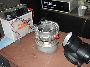

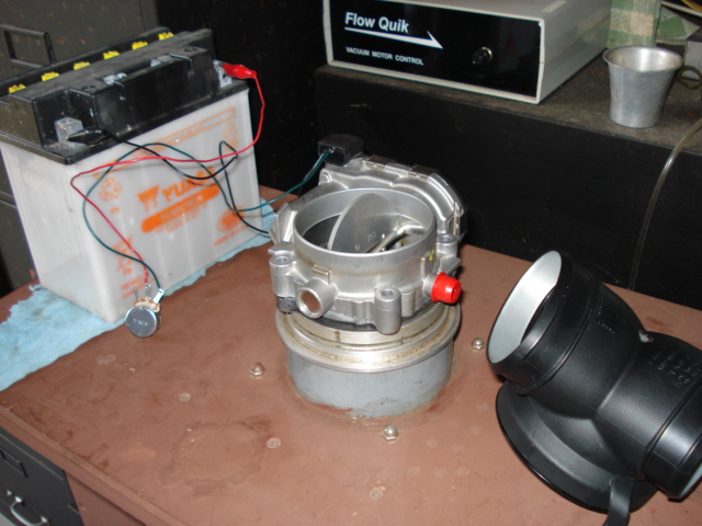

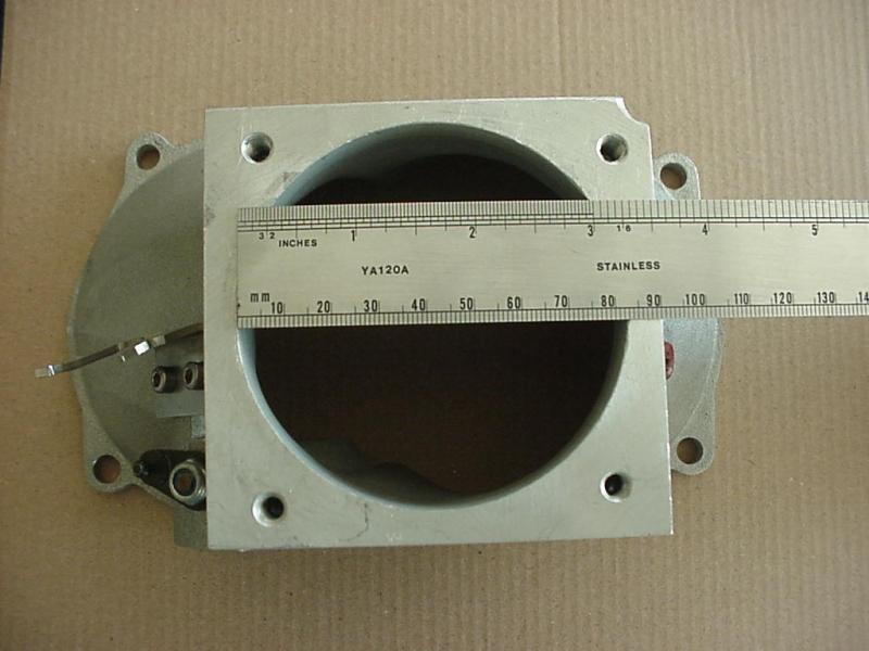

Last Saturday I had some time to stick a 82 MM T-body on the flow bench.
It Flowed 930 CFM. Then I installed the Y from a 80 MM set up. It Drop to 850 CFM. That is a 80 CFM drop? I'm looking to install this type of set up on my klee blower. I need to do more fabrication.
I did this a while back And I'm looking into Needs wings setup

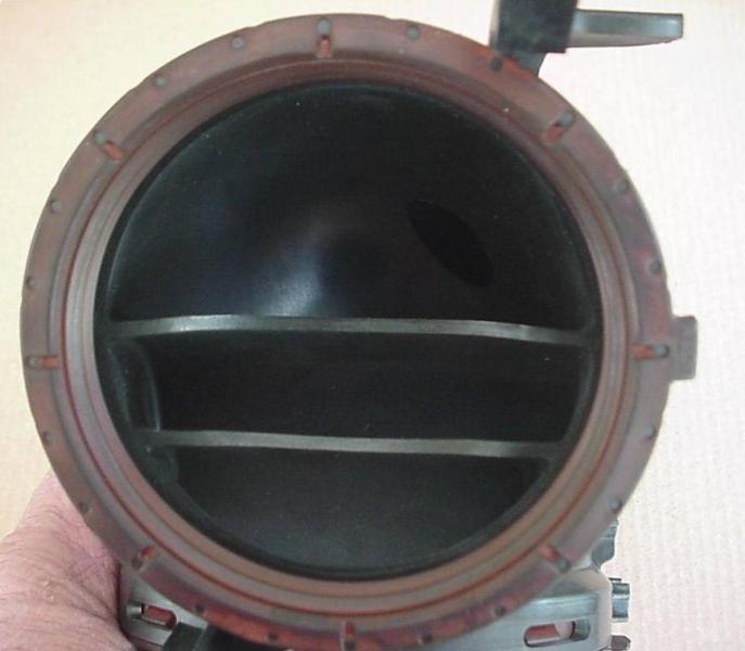

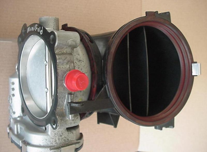

So because of fire wall clearance , I went to the CLS 550 Parts. The elbow is oblong. I'm trying to stick with OEM parts , If you notice in the 4th Picture & Grafted a MASS air Flow mounting boss from a round barrel to the Oval barrell . Cheers _PTEngineering
Attached Thumbnails THE blower thread-mvc-005s.jpg   THE blower thread-mvc-006s.jpg   THE blower thread-mvc-007s.jpg   THE blower thread-mvc-008s.jpg   THE blower thread-mvc-011s.jpg

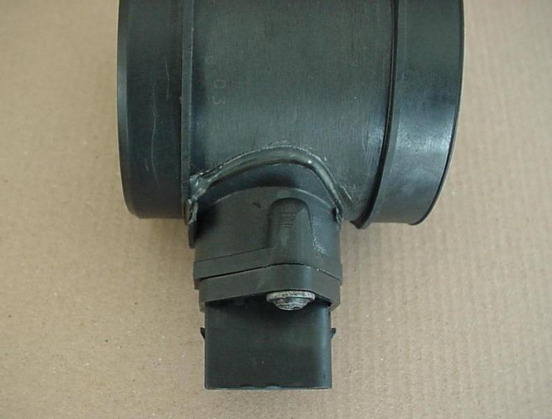

1. Tried another new MAS sensor (this is #4 MAS) and it reads over 5 volts under full load just like the others, so now I'm convinced it's not bad MASS probes, but rather pegged MASS AIR METER.
2. My earlier runs were in 40deg F air, and AFR up to 11.8-11.9. This AM 68deg F Air AFR up top 10.8-10.9 (I suspect rich due to air cond).
3. I learned how to reset adaptation for sensor and mixture using DAS... super easy. I reset the values and went for a 1 hour ride in varying loads. My LTFT's slowly crept up to 1.16 on each side. Came home hooked up DAS and found the 1.16 fuel trim is in same place as before... lower range of part load adaptation value.... upper range of part load is same as before. +/-1 (Good).
I'll drive the car for a few days and monitor/log LTFT's with this #4 Mass Air Sensor and see if it stays around +16%.... if it does I'll just drive it easy until I figure out a new MASS AIR PIPE solution that does not peg above 5 volts.
Another side note.... MASS AIR SENSOR#4 is a $35 ebay special, I'm trying just to see the diff. You can see physical diffs upon inspection, but so far it behaves close to the bosch units. I plan to data log MAS VOLT / RPM or TIME of the ebay MAS VS the Bosch MAS to see if there is indeed a diff. If no diff...... at the rate these fail the Ebay $35 units might be viable. More to come.
A caveat on the ebay MAS.... inspect it thoroughly..... I found a metal splinter in the wire mesh in the meter housing that would have been sucked into the motor at startup.... not good...... but I'm not using the cheapo housing.... only the sensor. FYI.
I measured my TB it is around 75MM.
I took out the ported TB elbow which had the vanes removed and put a stocker back in.. NO change in MAX MAS voltage.... still pegged. so these vanes don't seem to effect upstream MAS flow..... and perhap don't offer any perf advantage.
My next step will be to codger up some type of al tube larger MASS air body housing with the new Al MAS flange coming to me from fleabay. I'll try a 3.5" OD tube with my stock TB and stock e55k y-pipe to see if I can stop the pegging issue.

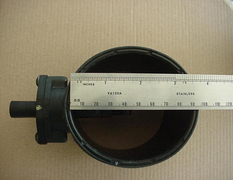

My stock MAS ID is 3". I've got 1' of 3.5" OD thin wall tube coming which I'll weld on the MAS Adapter flange. This will increase the ID of the MAS from 3" to 3.37" which just may be enough to keep my MAS from pegging with my current tune. The Al pipe is only $12, and flange is $25... so this is any easy test.
Stock MAS cross-section-area = 7.0686 sq-in
Al MAS cross-section-area = 8.9197 sq-in (OR +1.85 sqin.... which is 26% larger).
