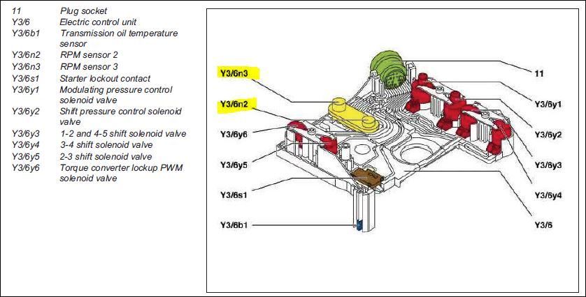

OBD p2784 = speed sensors. Sensors are incorporated into conductor plate odd replacement is causing this code. Possible defective CP, current part # is 1402701161 (need VIN to confirm).

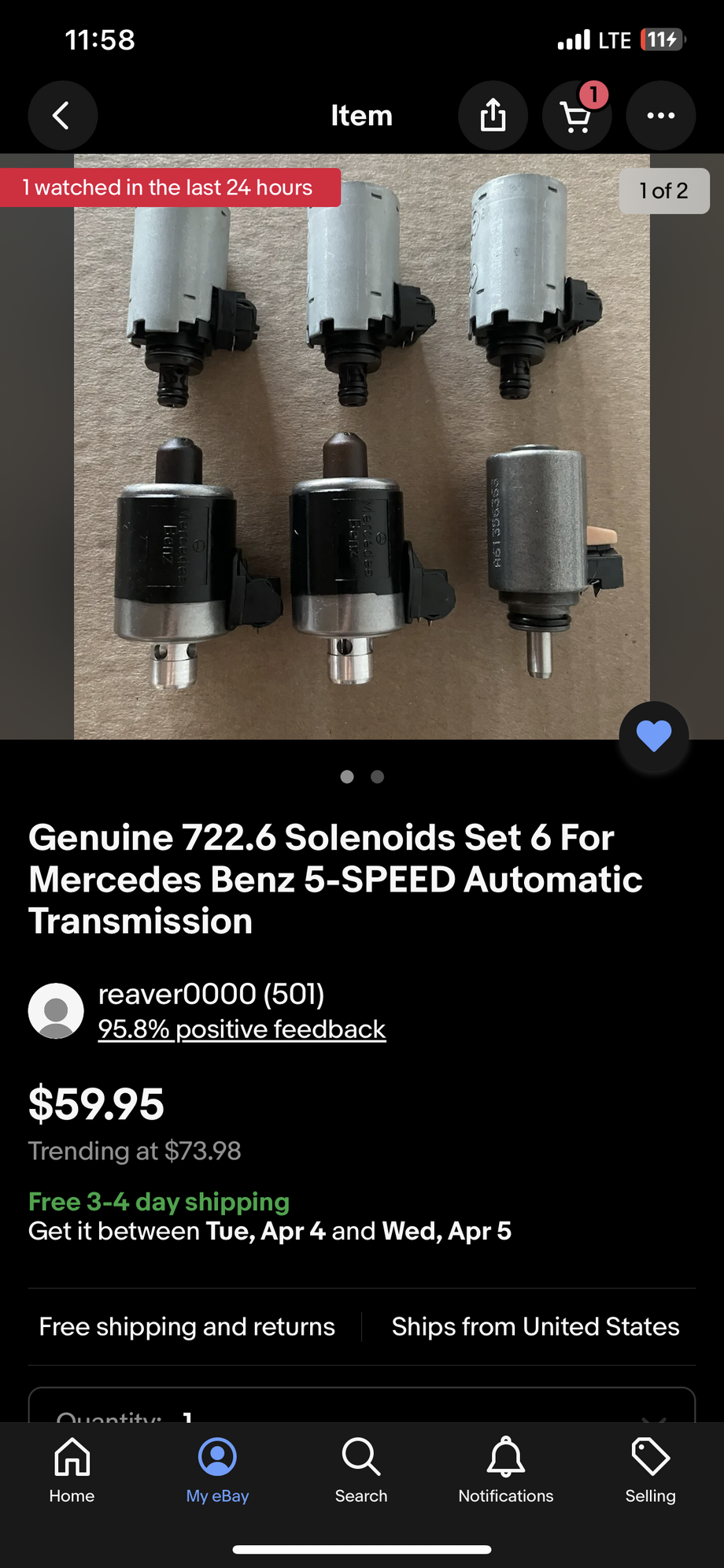

I wud need these right

If steadfast on replacing solenoids rather than revisiting conductor plate itself where problem resides.

so I shud look at the conductor plate instead of replacing the solenoids is wat u saying

OBD code 2784 = speed sensors. Speed sensors are built into conductor plate (CP) and not replaceable separately. You said you replaced conductor plate, unless I misunderstood, so two choices. CP needs to be replaced again possibly being defective or pull codes using Xentry (MB diagnostics).
Ok I understand now and yes it have been replaced I got it off eBay but this time ima get one from the dealership instead
