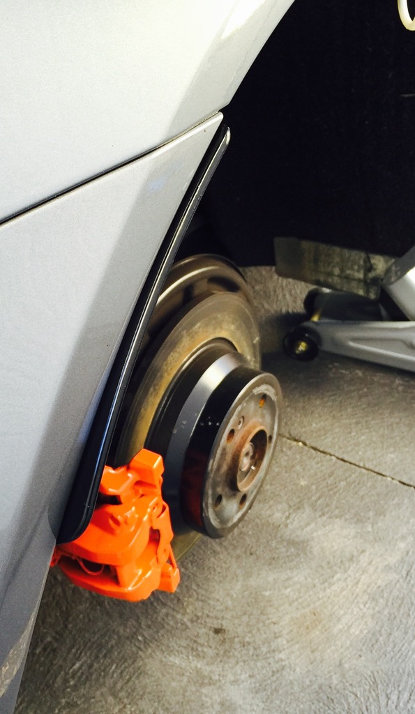

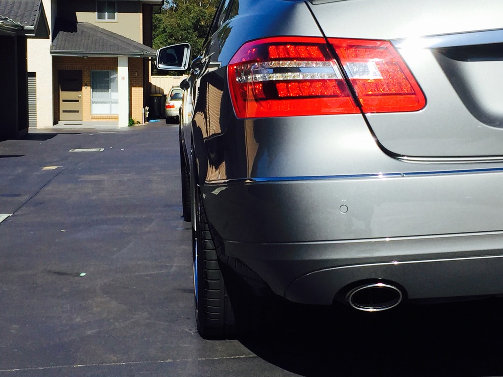

Im not too sure with the 4matic but heres a quick snap...
Its stickin out probably 2mm so i added this "mud guard" from the facelift model...

Nice can barely tell, super sick ride, seems with 10.5" on the back!! Is the mud guard needed? Does it throw up that much water off the tire?

nah, the mudguard (if you can call it that) doesnt help with the water, it just looks more aggressive for me. its barely noticeable but looks good. imo at least.
