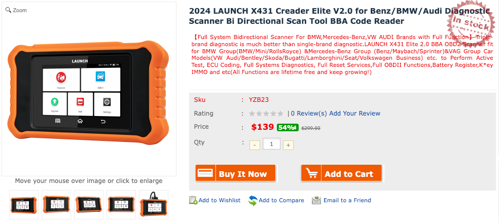

A free MB scanner should best be included with these cars.
Buy yourself a LAUNCH ELITE codeREADER

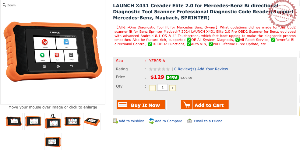

Jan 23, 2025 | 07:19 PM
Quote: im thinking for a long time to buy some budget scanner and yet didn't pull the trigger..
thank you for the simplicity as well, so i guess when i unclamp ground for short period from the engine till i have to clamp it again i should leave it somewhere where have no touch with metals just in case? : ))
exactly: don't let the loose GND clamp kiss any besides plastic. (It's a zero volt GND... but live not referenced to chassis).
A lot of us seriously enjoy using $150 LAUNCH CREAFER ELITE MB ... the reports are very useful to understand faulty modules interactions.
Without a comprehensive report, cryptic faults are misleading.
Reply 1
Jan 23, 2025 | 07:23 PM
As Cali says, ">> ​​Don't be "caught with your pants down."
Currently, the best small yet powerful Mercedes scanner is the LAUNCH Creader Elite 2.0 BENZ! At approximately $160 on Amazon (and only $129 on KingBolen), there is absolutely no reason not to have one.
Reply 3

LAUNCH does offer the BBA version where you get Benz, BMW, and Audi programs included. It's $10 more on KingBolen.com.
If you connect to a car without its program, you can still use the generic OBD function. Alternatively, you can download the vehicle program through the Mall feature. However, extra vehicles run about $60 per year subscription. That's why if you have a BMW or Audi, as well, it pays to get the BBA version since those programs do not require a subscription.
https://www.kingbolen.com/2024-launch-x431-creader-elite-v2-0-for-benz-bmw-audi-diagnostic-scanner-bi-directional-scan-tool-bba-code-reader
https://www.kingbolen.com/2024-launc...ba-code-reader

good to know thanks very much, probably would pick it up from this website so i can be sure i order right one

super deal
JR! $139 is a great price for the combo unit.
This is an excellent tool to get a complete PDF report without dealing with XENTRY complexities.

Back during the holidays, it was at $109 and I couldn't help it. So, I have the BENZ only version for the C350 and the BBA version for the SL400. I keep one in the Rear SAM cubby of the C350 and one in the storage cubby behind the driver's seat in the SL. I keep the Version 1.0 in my tool bag.
