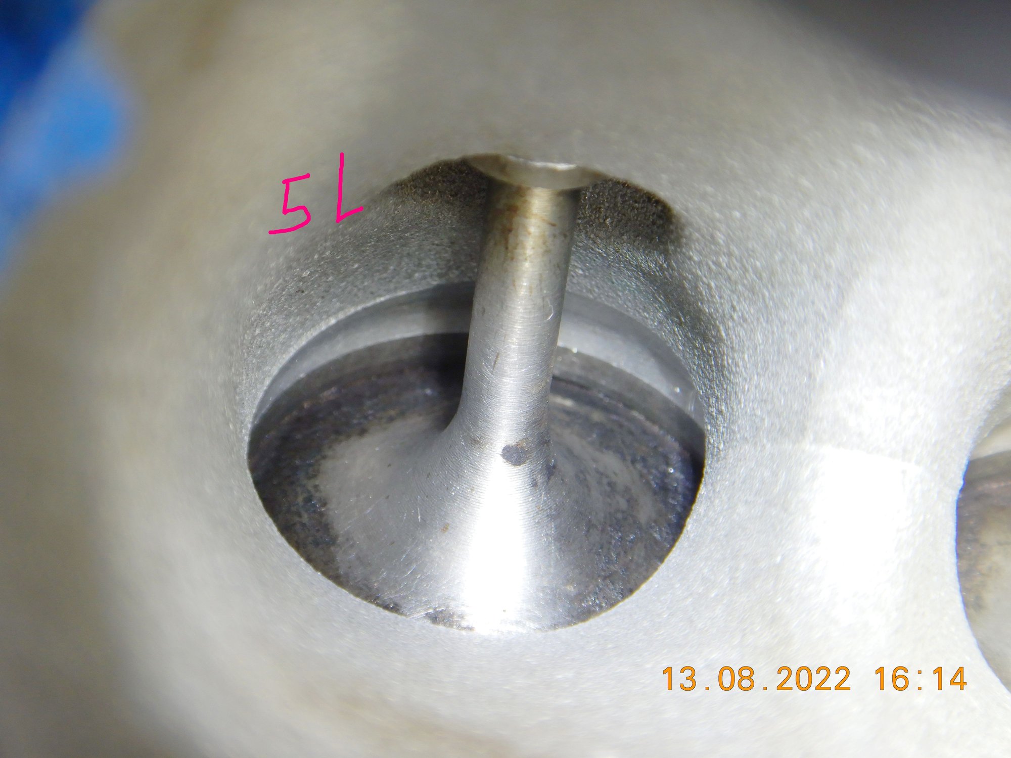

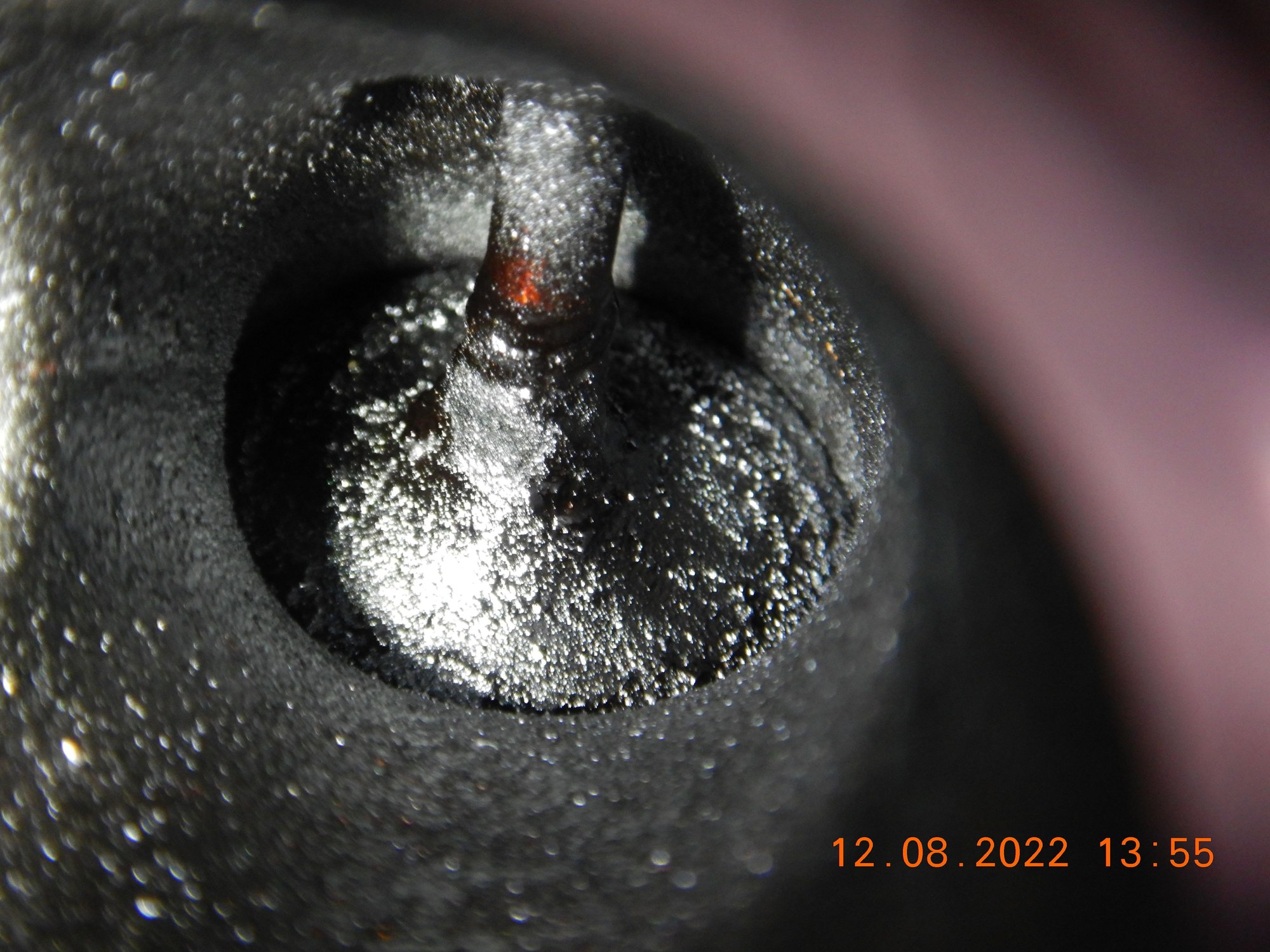

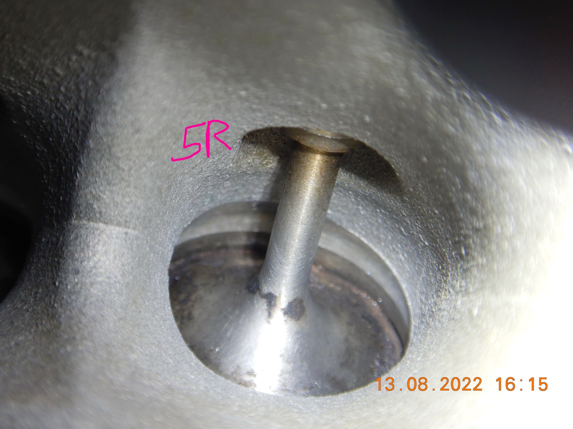

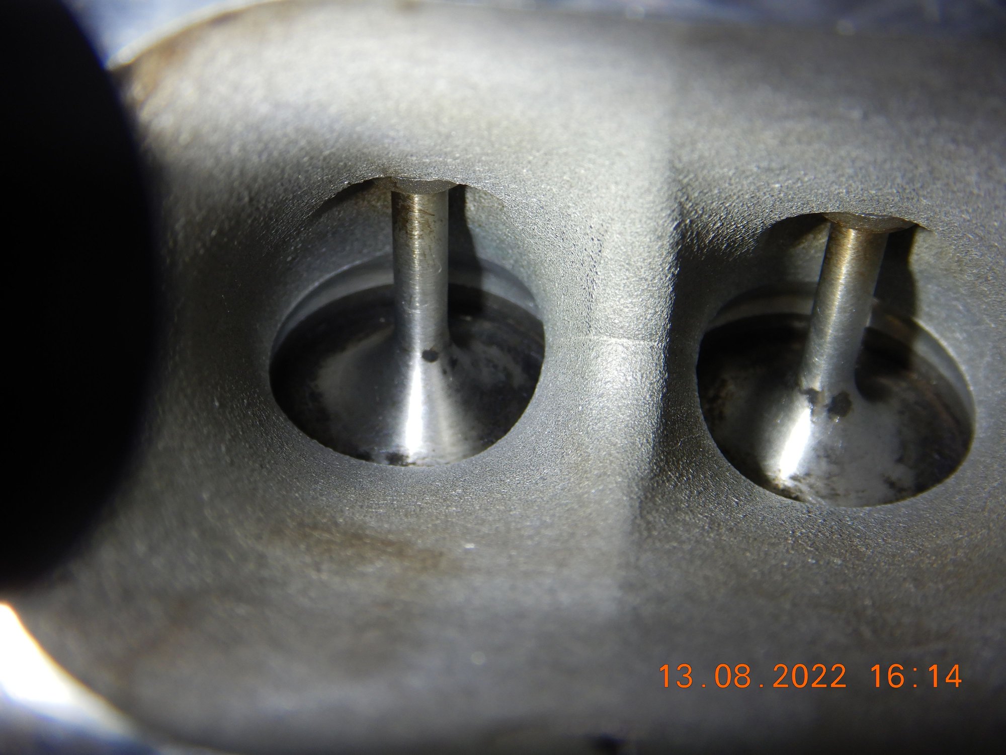

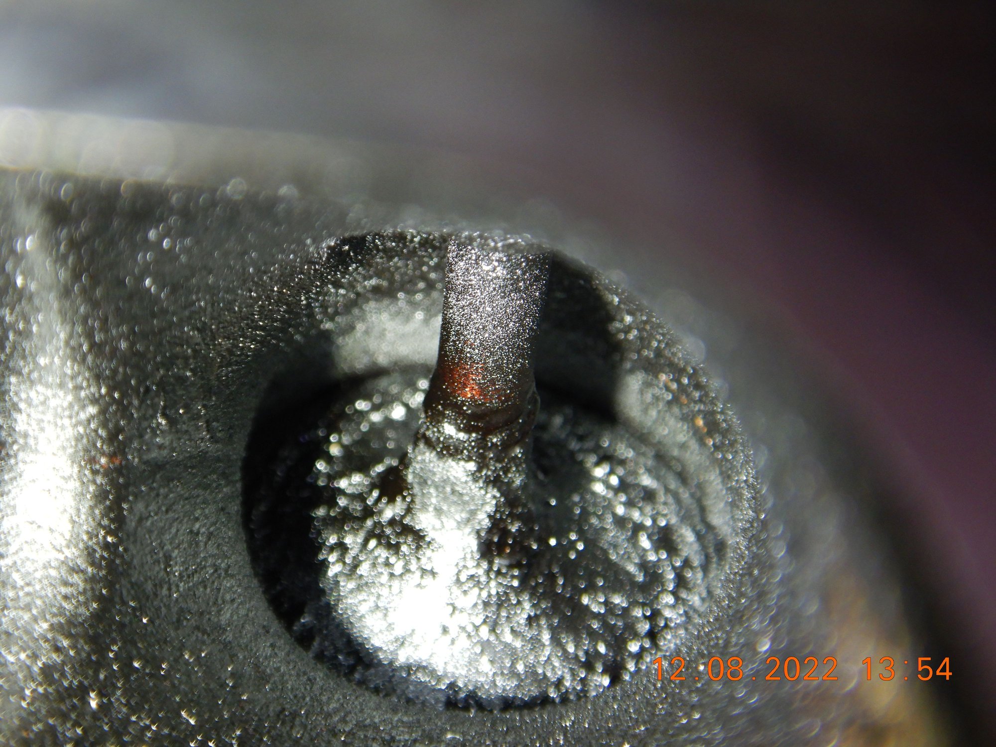

Using boroscope with 90 degree side camera and elbow grease to spin main pulley, you can see a bit of the intake valves opening and the carbon built up, not the greatest view but decent.
Cylinder 5 as per 26th June 2021 , no more than 32,000 KM for sure.
Cylinder 5 with intake manifold removed, as per 12th Aug 2022. No more than 34,000KM for sure.
No walnut machine, purely "hand job" , sweat and tears.

Nice job, @S-Prihadi . Were the first two pics using the borescope through the spark plug hole? How did you clean your valves? Scraping?
Old Nov 25, 2024 | 08:00 AM
S-Prihadi's Avatar
Joined: May 2018
Posts: 6,600
Likes: 6,547
From: Jakarta-Indonesia

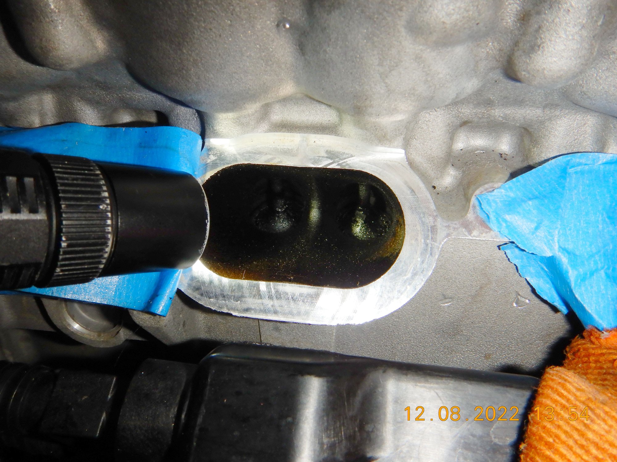

Yes, spark plug hole. Thus must be the twin lens/camera, where the 2nd one is the sideview.
An articulating boroscope can't do it.
Articulating one is good for piston and valves face
Front and side camera type.
Side camera boroscope, if without aftercooler blocking the main pulley ( M276.8xx Turbo ) and we can spin main pulley easy and see more of the valve back side. This is cylinder 1
Cylinder 1
Cylinder 2
Aha, it was 36,000KM. Sorry, I recalled it was 34,000KM
Yes, 100% scraping by hand...duggghh.
The job is described here : https://mbworld.org/forums/e-class-w...eaning-p2.html
