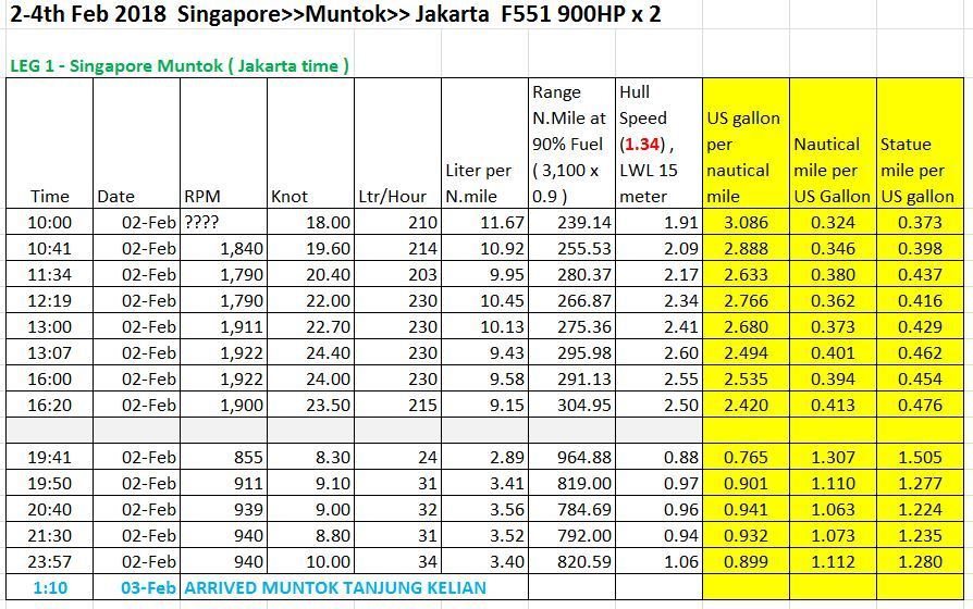

Here is my log from 2018 yacht delivery. 1,800 HP combined power, 55 footer size. Weight approx 29 metric ton or 63,000 lbs.
Above yacht top speed approx 32 knots, if at 2,300 RPM.
Look at the HULL SPEED column. Planing is the process where the yacht breakaway from Hull speed 1.0 , to about 1.3 to 1.5 and this jump needs about 300%- 400% more horsepower,
thus you see the MPG is very bad once at hull speed 2.0 ish vs 0.88 hull speed.
