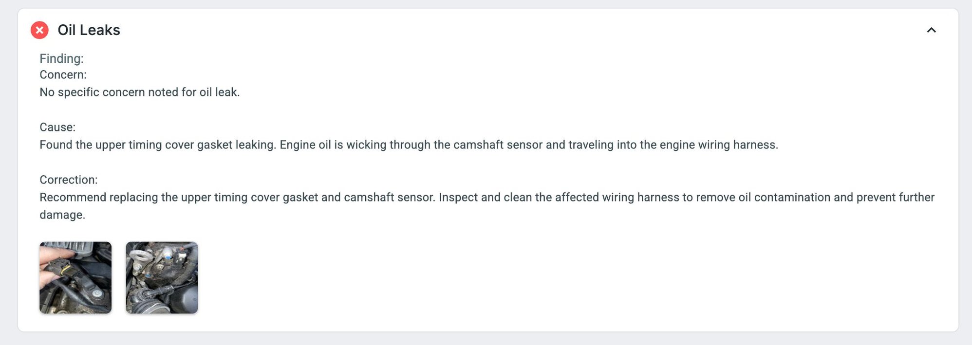

I just went to my local indy shop in New England (USA), and they found the upper timing cover gasket leaking oil onto the camshaft sensor. (Pics attached)
They recommended that I replace the gaskets themselves, along with 4 cam magnets, 4 cam sensors, 6 upper intake gaskets, 6 lower intake gaskets, along with the sealant spray.
With parts and labor, they quoted me $~2,000.00 USD in total.

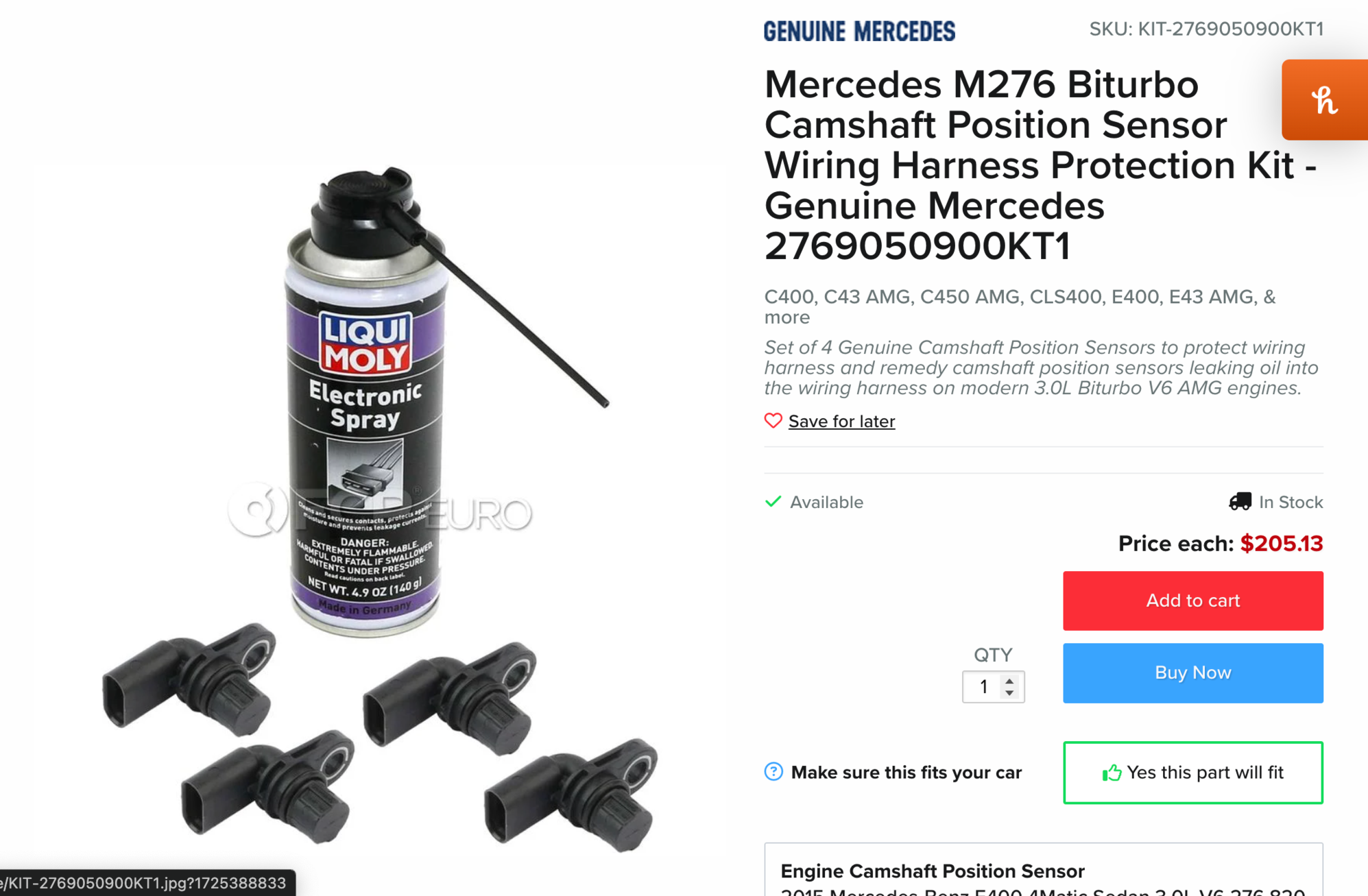

- FCP Euro sells two kits: The Camshaft Sensor Wiring Harness Protection Kit (which contains the 4 sensors, [Part #2769050900] and Electronic Cleaning Spray from Liqui-Moly)

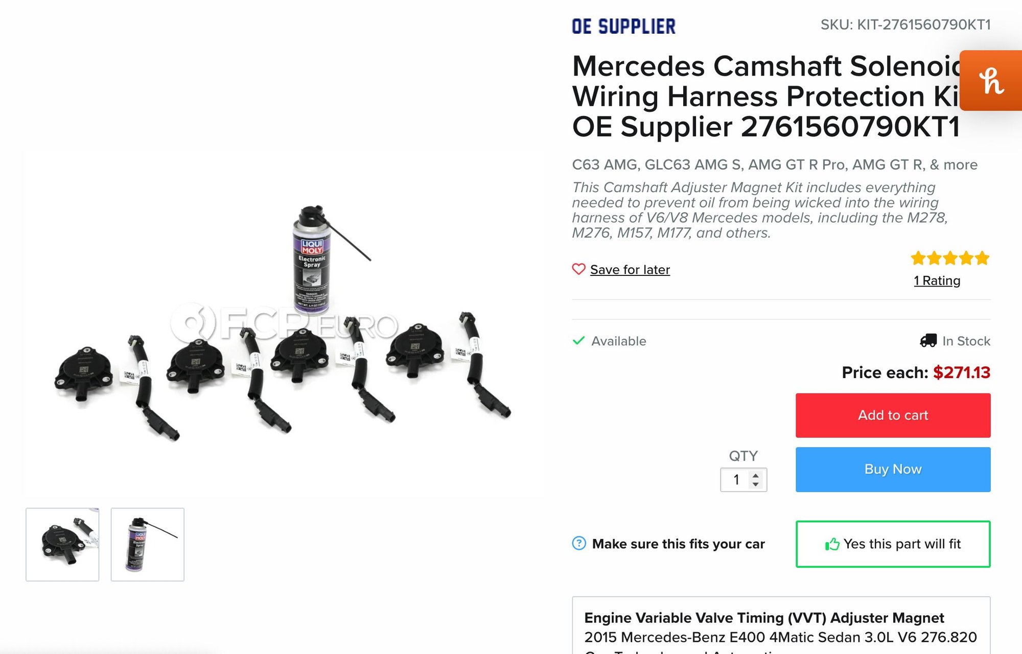

and the Camshaft Solenoid Wiring Harness Protection Kit (which contains the 4 cam magnets, [Part #2761560790] and Electronic Cleaning Spray from Liqui-Moly). [Pics attached]

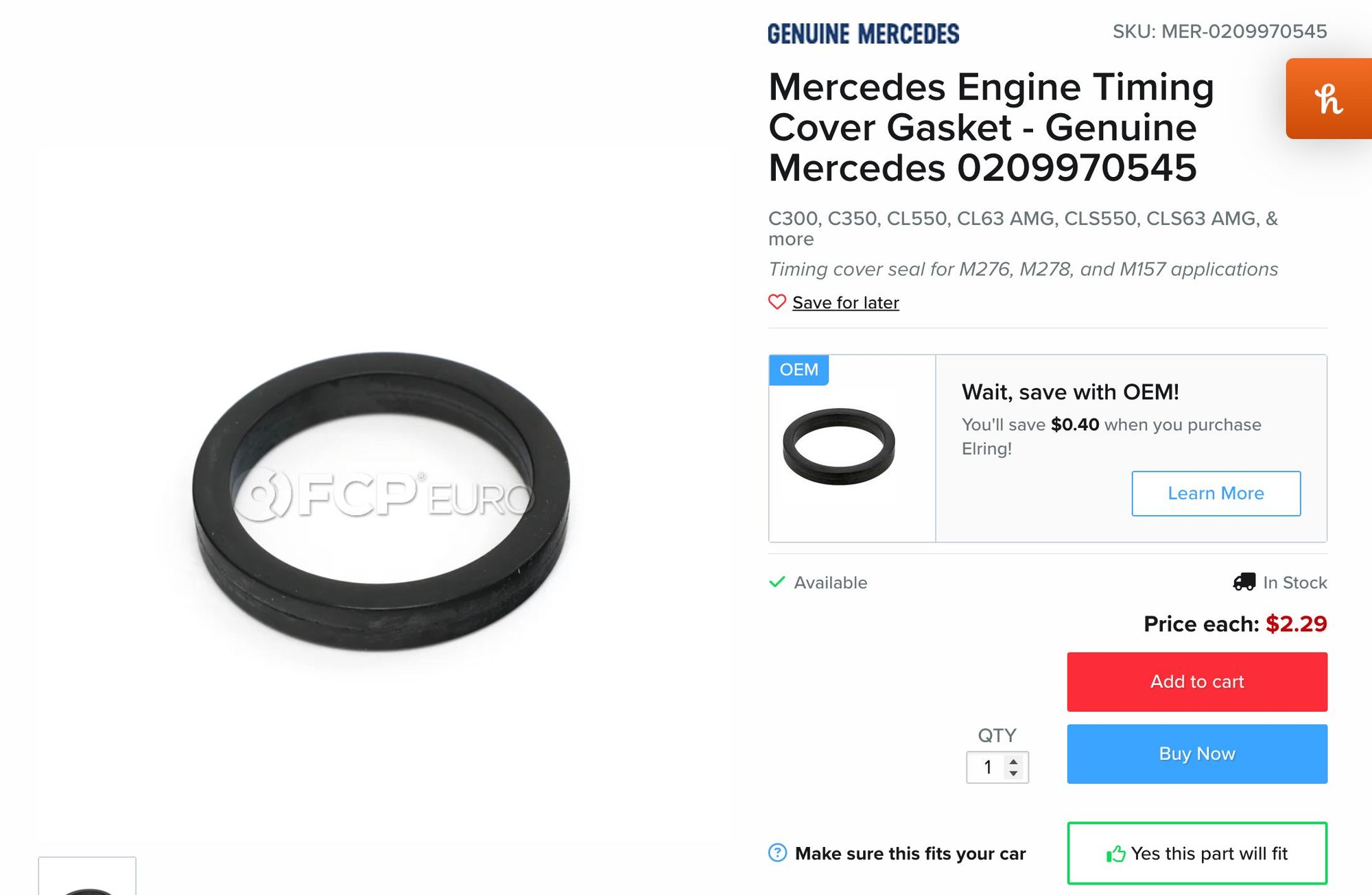

- 2nd question: Aside from the parts listed above in the two FCP Euro Kits, I am looking to identify exactly which gaskets I would need to replace. On FCP Euro, one is L-shaped and has the part number #2761840080. They also sell another one for my engine that is circle-shaped and has the part number #0209970545. Do I need to buy both of these gaskts? If so, how many of each should I buy?

First thing I would do is to get a couple of cans of cleaner and get all that dirt and oil off the various parts of the engine so that you can see where the leaks actually are. No use fixing something if it isn't a problem. Look particularly at your alternator for any signs of oil leakage. I paid $1202 to an indy shop this year to replace the cam magnets, wiring protection harnesses, (I supplied both of those), sealed the cam covers and installed the cam solenoids, and cleaned the oil off of the alternator.that covered all the existing, visible leaks on the engine. I did not have the engine timing cover resealed, not a problem on my engine. Keep in mind that my car is not a turbo..

Exactly what @Sunnyslope48 said clean the pig to see where are active leaks... don't use water. Connectors seals are NOT waterproof!!
Beware of internal leaks: "$10k oil in harness" is worse than oily ALT.
Inspect "magnet" solenoids for leaks
Install new sensors at CPS with extensions pigtails.
If upper timing covers seals must come open at least replace the cheap Tensioners and test VVT locks while CPS are out. No need in redoing most of this next month, right?

@CaliBenzDriver Got it. How many of each of the 2 timing cover gaskets that I had screenshots of do I need to purchase? 1 of each? 1 of the first one, 2 of the second one? etc

Not to be confused: there are 3x timing covers....
  1. two upper timing covers (always leaks)
  2. one main timing cover (major work)
I think here you're concerned with the uppers.
-- They do not use a pre-made gasket but instead use a liquid silicone applied by hand.
-- The fasteners are aluminum screws tightened with two fingers...it always leaks!

> When you pop TIMING COVERS do...:
  • replace CPS + pigtails
  • new chain tensioners
  • (check intake VVT locks)
  • (check solenoids plug for leaks)

Your oil leak is the common one............ read here : https://mbworld.org/forums/e-class-w...lant-work.html
The culprit, aside from the VVT magnet o-rings and camshaft position sensors and its o-ring............
One time use VVT magnet bolts, do pay attention.
