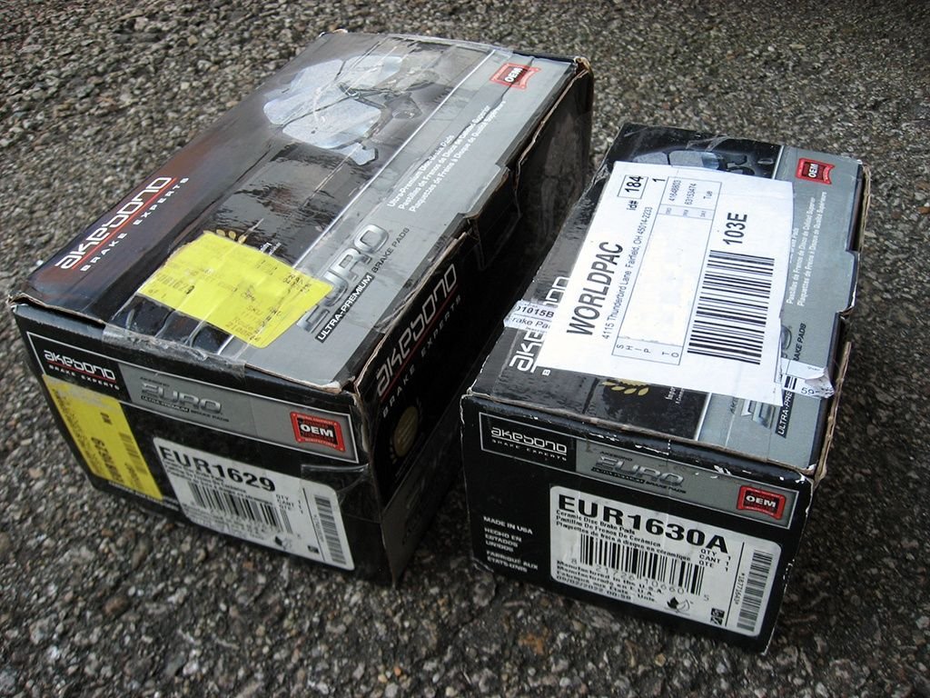

While inspecting the vehicle, the techs noticed the corrosion on the brake pads, and one of the inner ones was delaminating. They showed it to me when the vehicle was up on the lift, and it was really separating. The pads were also getting worn down. According to the service records, the rotors had been resurfaced when the brake pads were replaced under the previous ownership at the dealer, so they were also getting thin. The brakes were due, and I wanted to replace the Genuine Mercedes brake pads (the OE manufacturer was TRW, I believe) with the Akebono Euro pads, which were on sale (the complete set of front and rear pads was on clearance and cost less than $85 in total). For the rear pads, the SUV takes Akebono EUR1630A (corresponds to brake kit Mercedes Benz part#: 007-420-83-20, which has been replaced by 000-420-99-04), and, for the front pads, it takes Akebono EUR1629 (corresponds to brake kit Mercedes Benz part#: 007-420-81-20, which has been replaced by 000-420-13-05). The Akebono rear pad kit comes with wear sensors and anti-rattle springs. The Akebono front pad kit comes with just the wear sensors. When I was looking up parts, I checked the Mercedes parts catalog, but it seems that the rear anti-rattle springs are not available separately from the Genuine Mercedes kit (I couldn't even find separate part #s from Mercedes). None of the U.S.-based parts suppliers had any either, but I think one might be able to find compatible aftermarket ones from vendors in Europe (or on eBay). Had to clean and reuse the old ones, since the ones that come with the Akebono rear pad kit don't fit correctly.

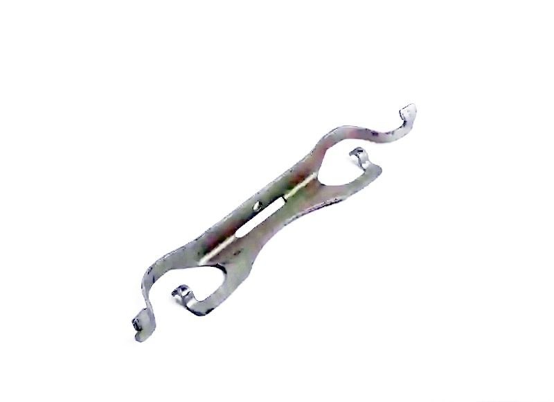

The spring clips for the front brake pads are available separately from Mercedes (possibly the same as those used on other makes and models), so I picked up a set from a dealership to replace the rusty ones on my vehicle (we're in coastal northern New England...).
The coating on the Genuine Mercedes rotors that came with the vehicle had held up well in our salty environment, and we were OK with their braking performance, so I decided to just get the coated rotors from Brembo, the OE manufacturer for the Genuine Mercedes rotors (both manufactured in the U.S.).

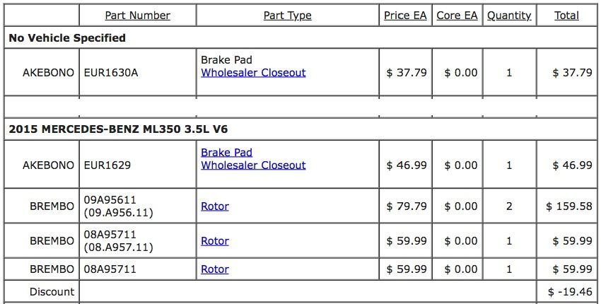

The parts prices with the sales discounts applied were pretty reasonable, I'd say:

Great upgrade combination of Brembo rotors & AKEBONO ceramics.
There's a simple step to make your brakes work twice as good for normal driving.
crazy strong spring
crazy-strong stock SPRING jams caliper...
That anti-rattle caliper spring is responsible for poor braking. It keeps the caliper torqued 90° perpendicular to sliders with too much force...
caliper is unable to center over rotor on lubed slide pins as they should.
Only inner piston pad wears out while outer does nothing.
Tweak the spring tension to allow caliper to slide normally - Better than new firm brakes will result with a nice short pedal... not spongy long stock pedal.
