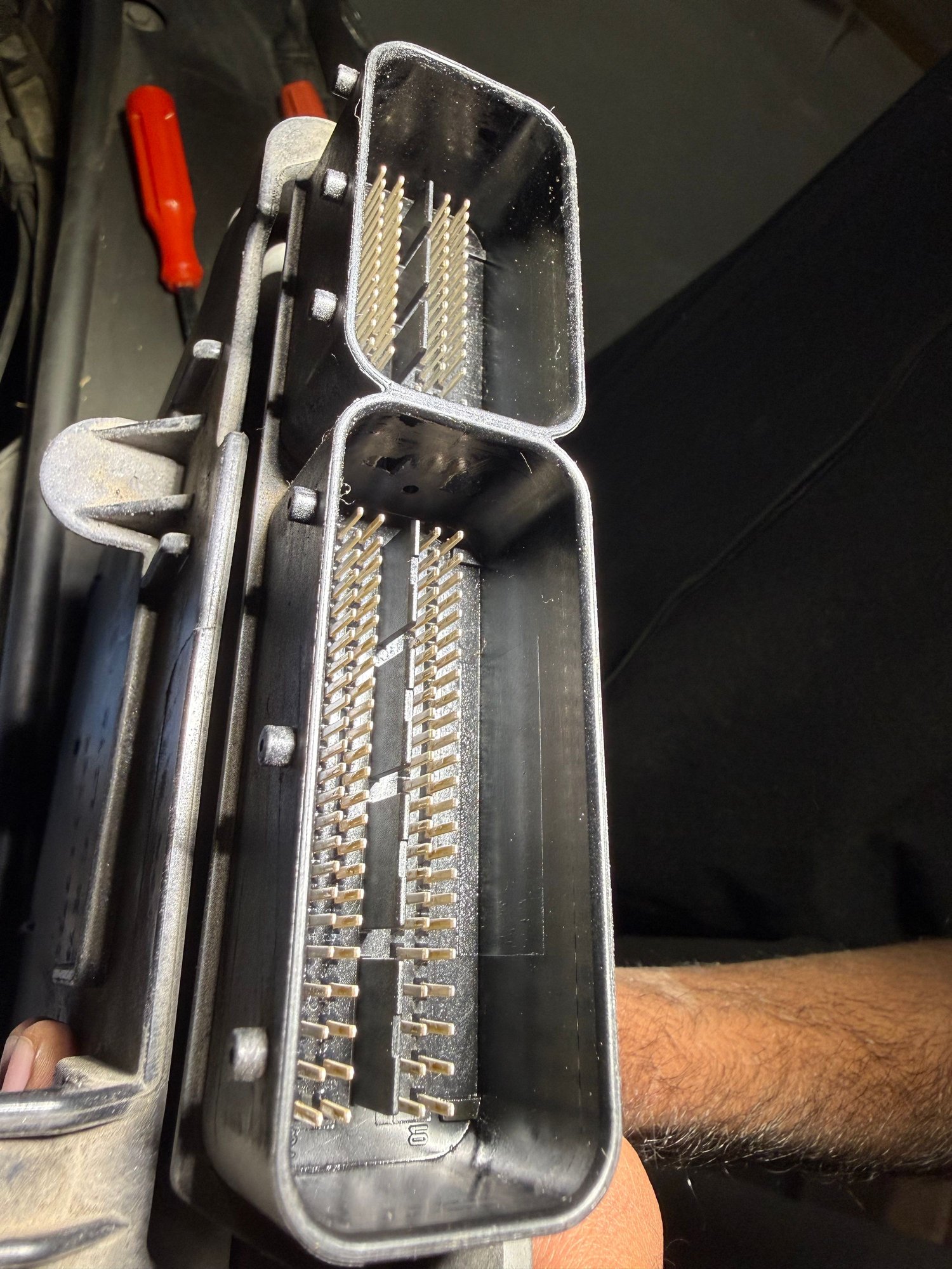

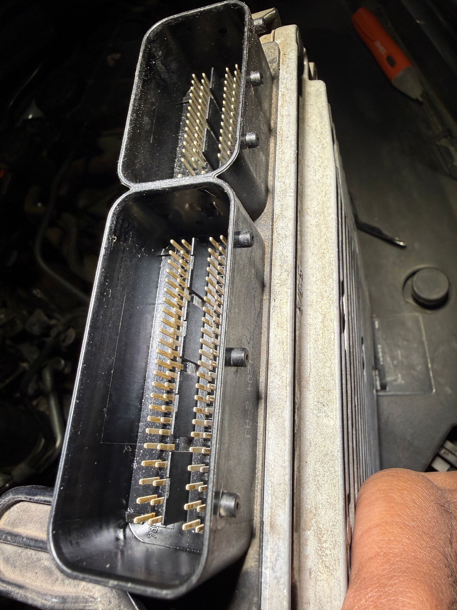

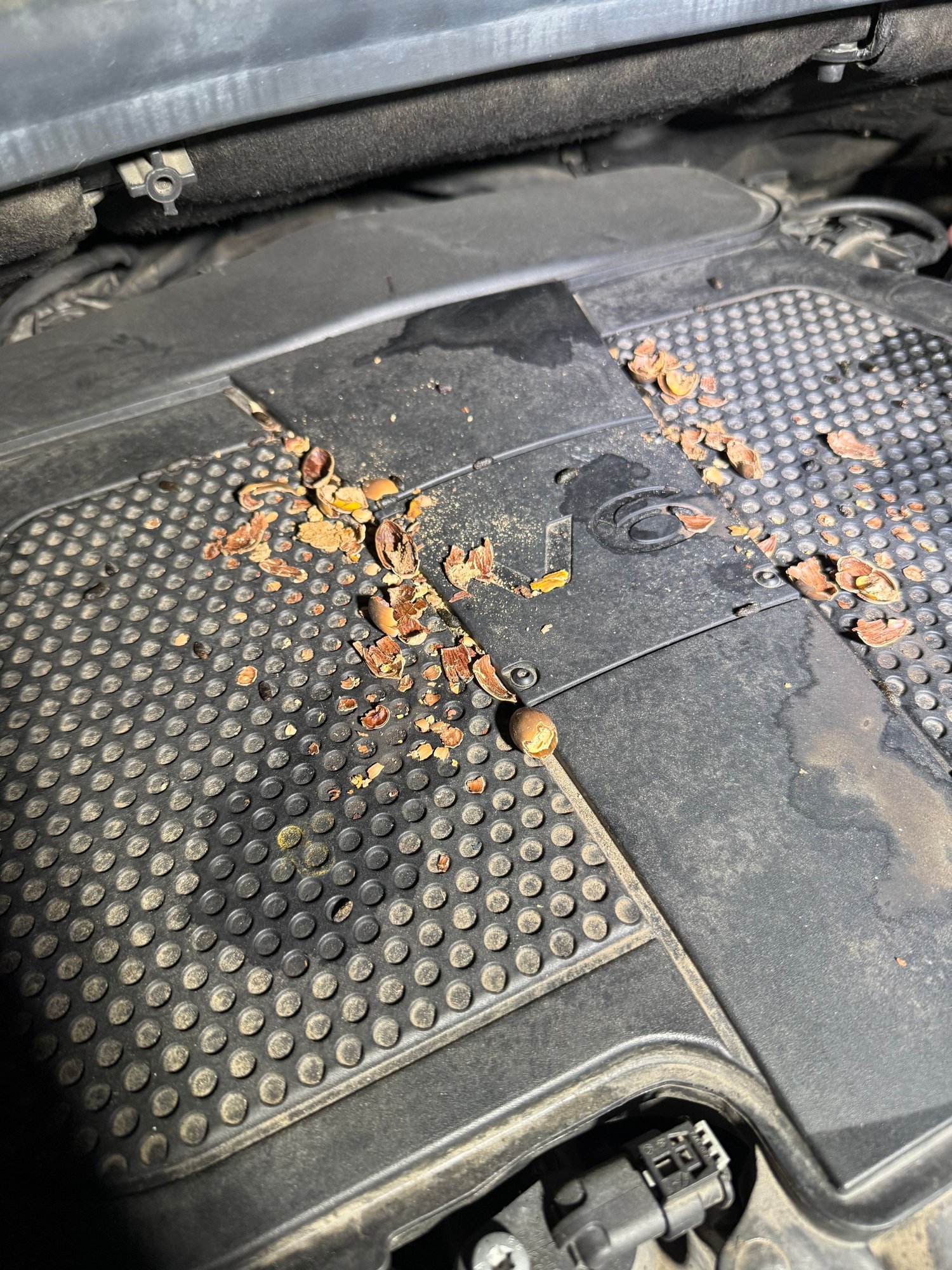

Just got a new bosch coil and made sure it was oem. I'm swapping the old coil with the new one for cyclinder 6. Along the way I opened the ecu wiring harness but couldn't tell if there was any oil leakage. Also I noticed some droppings which is concerning me, and I don't believe I have rats, in fact the cars been driven basically everyday for the last year. Do you think the mice/rats could get into the interior or would they stop at the engine? I checked my X7 as well and there was droppings but only 1 or 2. Weird thing is both cars have been stored in different environments so I'm wondering why both have droppings. I would appreciate any feedback.

Your ECU connectors look perfectly clean.
I don't think we have evidence of rodents involved with your No6 misfires.
Lets see if coil does fix No6
else you can swap/inspect the spark plug itself.
