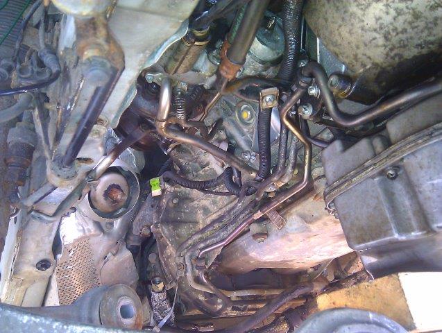

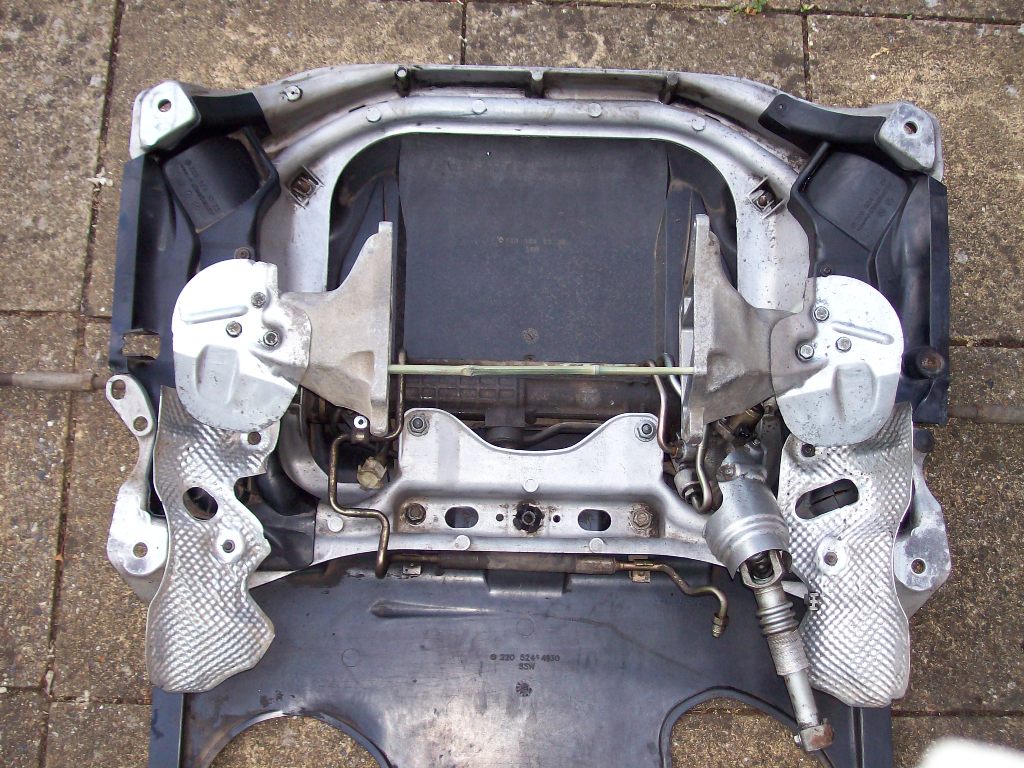

Originally Posted by EXECMALIBU
2. Remove the the complete lower Sub-Frame while supporting the weight of the engine from above. Then remove the mounts from the bottom. They say this takes a little bit less time but because of the size and extreme weight of the Sub-Frame with suspension parts it is more difficult. Two people are required to support and lower/lift the parts.
That's exactly what I did with my car. On my own, in my garage.
The subframe is actually very light - lighter than a single front brake rotor.
Removing the subframe makes access very much better, but its still a difficult job. The upper forward motor mount arm bolts are difficult to access.
