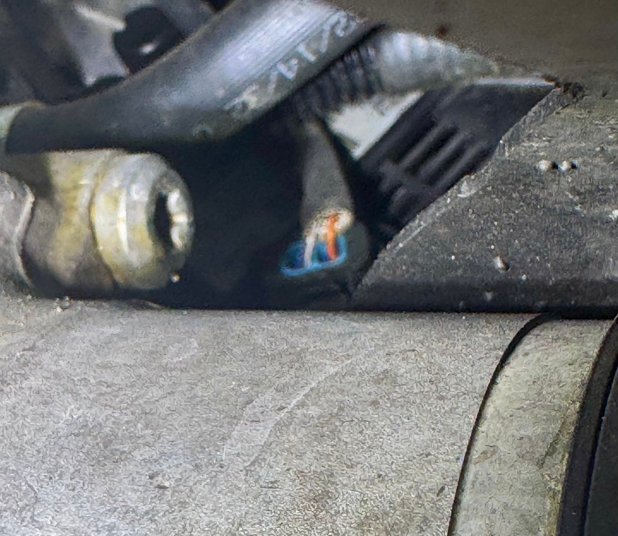

Old Jan 15, 2025 | 07:16 PM
Jaybird123's Avatar
Joined: Mar 2018
Posts: 485
Likes: 153
From: KY
2015 E63S Sedan, 2014 E550 coupe
I’m still unable to perform this mod due to the curious second wire on my alt plug! 2015 e63s sedan.

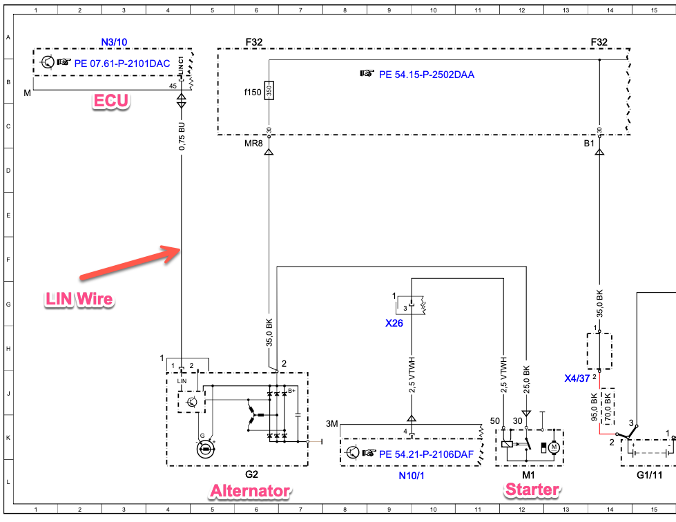

That is curious. I wonder if looking at a wiring diagram would help figure it out. PM me (or post here) your VIN and I will try to find it in the WIS.
@Jaybird123 here is the wiring diagram for an E63 (212.277). It shows a single wire going from the alternator to the ECU. With your specific car model, I could make sure I am looking at the correct diagram.
EDIT: Also note that the single LIN wire is BLUE (BU). The connector in @Jaybird123 photo shows an orange and white wires. Maybe that is a picture of the wrong connector. I can't find two wires like that in any of the schematics.

me too!
you can test one method then the other to accommodate freezing weather constraints.
Besides BATT-LIN will be a different fault in a different module: the Rear-SAM.
Options offer good flexibility....
SMOG Test : ECU fault free while ALT-LIN plugged back and BATT-LIN pulled temporarily.
True, good to have options. Sticking with ALT-LIN problem is my back will complain at me I will see what can I do or if I can figure out how to do it from the top ill post it and share but if not I will need to just go from the bottom.
Old Jan 15, 2025 | 09:26 PM
  #50
W205C43PFL's Avatar
Posts: 32,342
Likes: 6,318
me too!
you can test one method then the other to accommodate your constraints.
Options offer open flexibility....
Thanks for bringing this mod to the attention of us forum members, these quality of life improvements are nice to have : )
