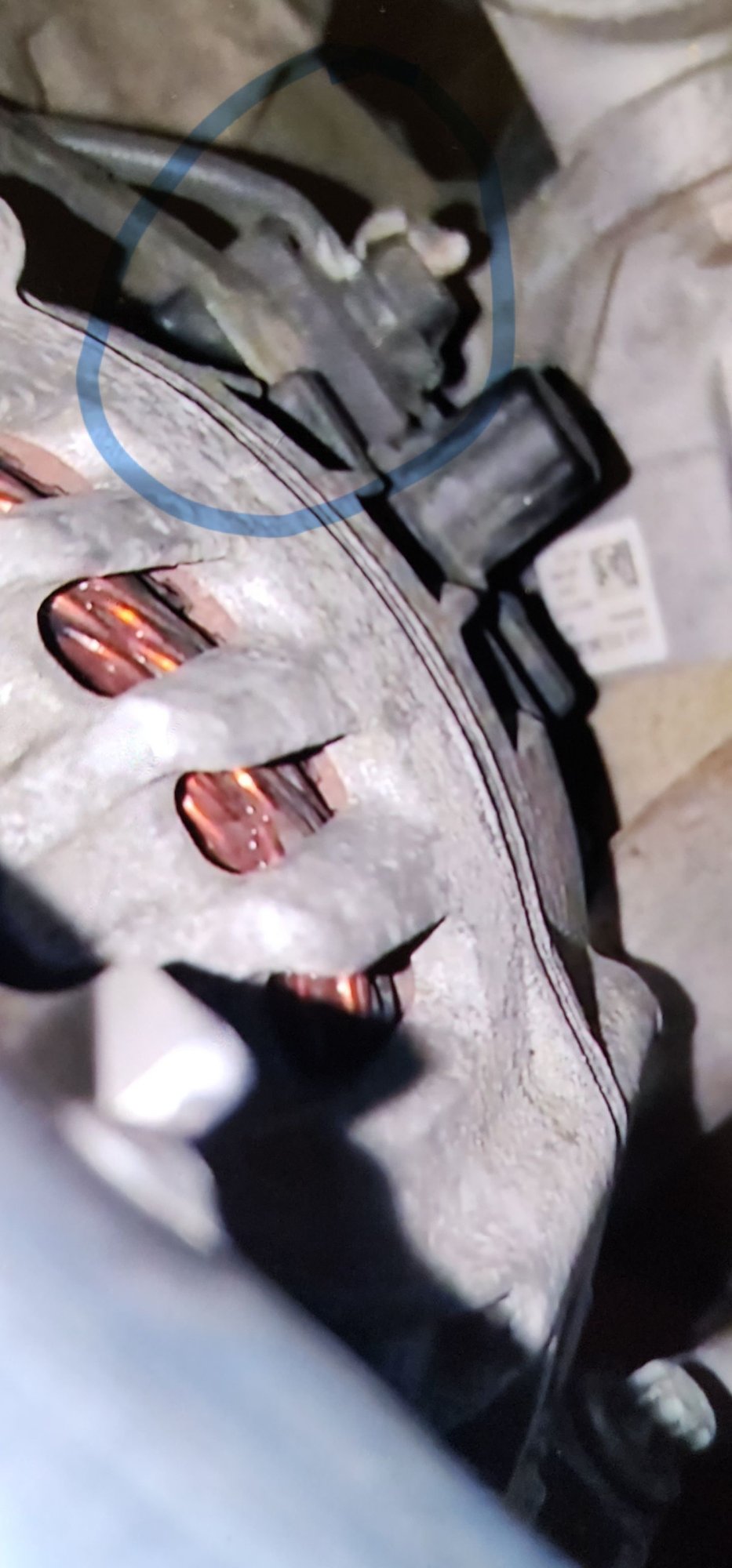

There you have the blind extraction of ALT-LIN.

I need more assistance : (, I am confused, what is this thing? I don't see nor feel any connectors pictured in the thread, viewing from the top with phone flashlight: (

BLINDLY PULLING BY FEEL
yes you got it, I think this is your ALT-LIN connection
Some alternators models have it Located Near The Edge at the rear like yours.
Feel your way around that skinny wire...
Feel the lock lever
Pull it out
.... procedure above
>> Not to be confused with the tall plastic cap over the ALT/BATT output: ALWAYS 12VDC LIVE POWER (Dont short this! - Don't mess with it - That part is built to be reliable)

I think this is your ALT-LIN.
Some alternators have it located near the edge like yours.
Feel the lock lever
Pull it out
Not to be confused with the tall plastic cap over the +12V output ALWAYS LIVE POWER.
I thought that was my ALT-LIN too as that is the only wire coming off from the alternator other than the round 12v one but the wire is not blue and it is nothing like the connectors ever shown in the thread, I wonder if MB changed it to a permanent connector since the W205 C-Class, if so that will be unfortunate.

@Manny_c450 Is that how your connector looks like as well?
look up your ALT spare part on the Internet .... it will show you matching connector style.

Old Jan 16, 2025 | 02:42 PM
  #71
CaliBenzDriver's Avatar
Joined: Apr 2019
Posts: 12,058
Likes: 6,848
From: Silicon Valley
W212 MY'14 M276-3.5NA @75kMi
similar latch...
and... the connector looks completely different.
do you see the latch tong?
same
similar
Now you can see where the latch is facing
I don't think it is different... the connector you pull out covers the whole alternator male/female piece
Old Jan 16, 2025 | 02:43 PM
  #72
W205C43PFL's Avatar
Posts: 32,666
Likes: 6,417
https://cimg2.ibsrv.net/gimg/www.mbw...93efbaf4b7.jpg
similar
I don't think its different...
Me neither it is strange, I don't think it should be different either.
It is not there...
Old Jan 16, 2025 | 02:52 PM
  #73
Joined: Apr 2019
Posts: 12,058
Likes: 6,848
almost there...
It is not there...
my connector would fit your alternator!!
  • Now that you know where latch is facing
  • reach in and feel your way to identify latch
  • pull it
  • then off it goes
done! big hand
Old Jan 16, 2025 | 02:54 PM
  #74
W205C43PFL's Avatar
Posts: 32,666
Likes: 6,417
You know where latch is facing, right
pull it and off it goes
done! big hand
Mhmm, the latch would be further to the back of the alternator so in the image shown I uploaded it will be further back towards the bottom, except there is no latch, unless someone broke it before but doesn't make sense, I bought this 2017 since new. I will try again, appreciate the pointers, thank you again
Old Jan 16, 2025 | 03:07 PM
  #75
Joined: Apr 2019
Posts: 12,058
Likes: 6,848
FREEING YOUR ALT-LIN CONNECTR....
if you need more confidence look at pics of the connector you're trying to remove.
In particular the tinny plastic lock at the top... be gentle it's undersized German plastics
if you want to save time, just look at CPS connectors: same tiny lock style.
-- It uses a "dual-latch" just like CPS connectors
-- Pull back the fragile lock from the top edge by hand
-- Gently rock the lock to release connector while you pull out tocking side to side.
