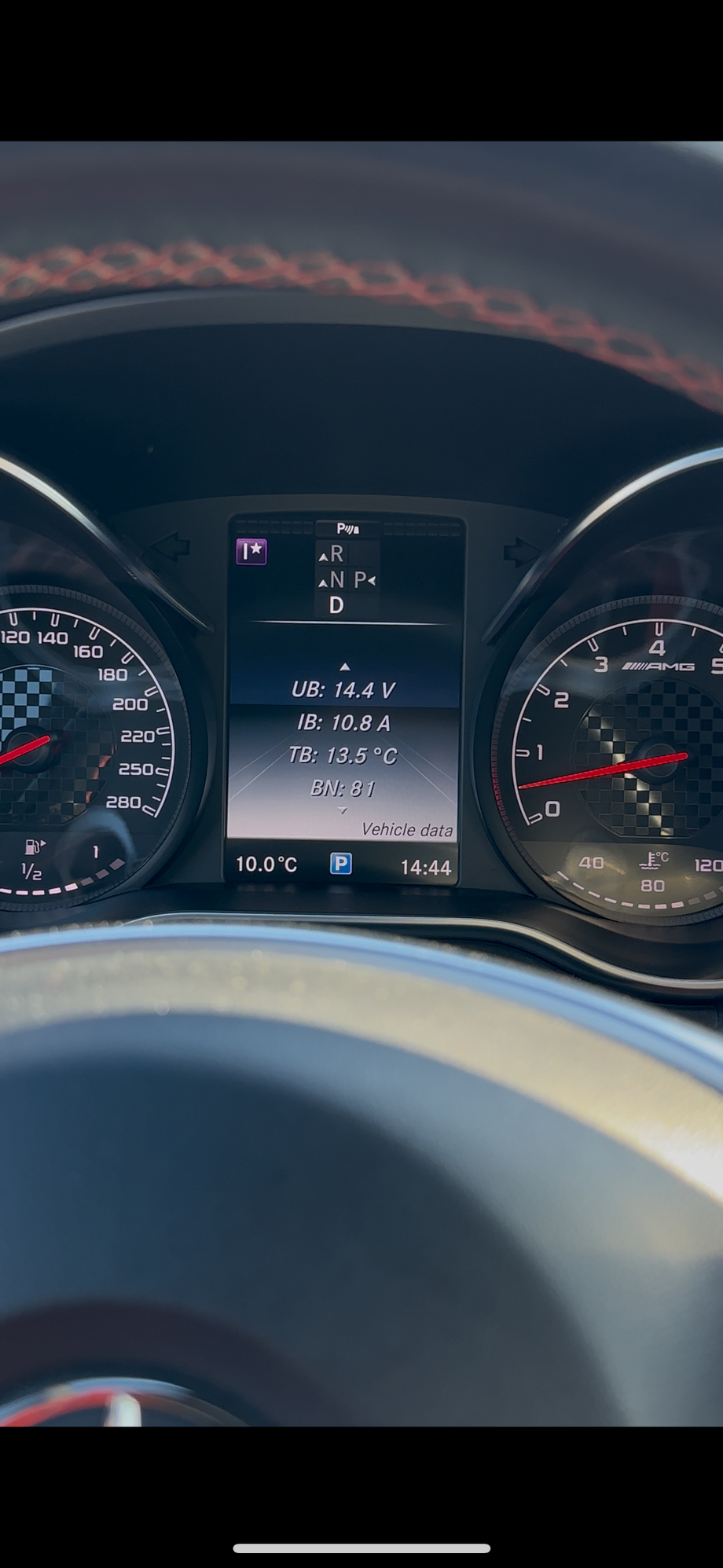

Thanks to @CaliBenzDriver for this valuable thread after the Oil mod, so after reboot the chassis we should expect the IB: X Amperage to be as low as possible which we benefit from more smooth tranny + more responsive throttle?
Today I've a look at my car what is shows and currently stays above 14V and the Amperage was floating between 7-11 while im waiting on street light and didn't pay attention when i drive how it behaves
Will try next week to see if I can unlpug this socket from the alternator
I want to bring something which i notice to happen for several times, 3 weeks ago my car behaves a bit strange the tranny wasn't so accurate when to downshift etc. i didn't drive the car for 2 days then I notice the car did more accurate downshifts and a bit more accurate when i accelerate
today: i didn't drive the car for 3 days and today the car behaves even better than the last time when i didn't drive for 2 days, which means even more precise and accurate when i accelerate OR when i stop the downshifts are more better (so i can't explain what might be the reason, some reset of the modules or what could be), so i can't imagine when i reboot the alternator how much better can be..?
Thanks again and will post when i do have any updates (will try to make photos for @W205C43PFL ) and for the members as well if i manage to find the cable that i have to unplug
P.S. @CaliBenzDriver i saw above that you mentioned after you unplug the alternator when you stop the car your tranny stays at 1st gear no matter of the engine mode (E, C, S), but isn't designed to be in 1st gear only in Sport mode and for the Economy/Comfort to stays at 2nd gear, so if this was the design then why appear after the MOD to stays at 1st gear (im just bit confused)
P.S. 2
I want to bring something that i made as kind of "improvement" as I get tired of changing my vacuum pump valve (with the famous stupid orange membrane) so i purchase a check valve (cost me 2$) I cut in the middle the vacuum line which goes into the pump valve and i plugged my valve so that way i will stop bothering with this membrane if it's gone
P.S. 2

I forgot to state the obvious... if unstable voltage does not affect your chassis, don't do anything experimental to it.
My E-mode D2 gear transformed into D1 without any firmware update and without playing will paddle shifters to help train TCU.
overnight stay, 1mn after start to low idle: IB=5Amp.
overnight stay, 1mn after start at low idle: IB = 5Amp.
overnight stay, 1mn after start to low idle: IB = 5Amp.
tmrw will when i do the cold start will take a pic what it will shows but for sure it will be a twice on your figures (A)

Here's my C350 post startup and at idle.
