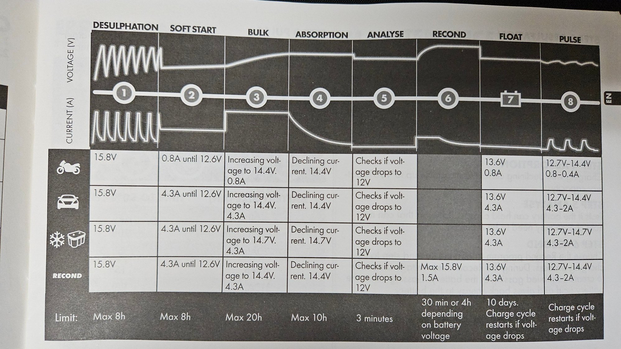

BATT FLOATING...
Do you mind posting the steps to how to properly float the AGM (your way?) so there are no confusions? Your reboot thread is helpful just confused about the float part : )
Ideally we want the most stable voltage with fewest amount of ripples. It's not mandatory but floating will help your bottom line as it did for me.
Best electricals come with the AGM acting as a large capacitor with its low internal impedance.
The 12VDC chassis electrical has dynamic caracteristics. It's not quite AC but charging ignition coils with current involves impedance and frequencies, no longer DC only. Some voltage spikes are our friends for ignition, while most other spikes are undesirables (this calls for taskforce study of ignition harness! MB left no stones up turned ).
The bottom line for a great power supply is you want the least resistance to get the lowest impedance.
You can float your main AGM battery "regular mode" in circuit or with "AGM Mode" out of circuit.
The chassis sound amplifier uses barebone 16V capacitors that are not too friendly with 15V. So personally I try not to AGM Float in circuit.
Floating a lead-acid battery equalizes cells voltage to lower internal resistance... it makes battery act new again!! I use a CTEK charger for this purpose.
description of charging modes and steps
"Regular float" mode in circuit
"AGM Float" while REBOOTING your chassis when batt is disconnected out.
A healthy battery takes 1-Hr only
An tired battery takes over night
Floating rejuvenates the battery so it will work better and take less time to absorb float charge.
If $170 AGM battery was ECO cycled and drained... its charging capacity will be reduced. I retired my main AGM at 10Yr mark (No ECO, No Yoyo!)
+++ QUICK STEPS ARE:
This procedure best combines [reboot + Floating]
-1- Disconnect main/aux batteries
-2- Float main "AGM settings" (AUX if you want as well)
-3- Reconnect batteries (using jumper cables if you care!)

Ideally we want the most stable voltage with fewest amount of ripples. It's not mandatory but floating will help your bottom line.
The 12VDC chassis electrical has dynamic caracteristics. It's not quite AC but charging ignition coils with current involves impedance and frequencies, no longer DC only. Some voltage spikes are our friends for ignition, while most other spikes are undesirables. (this calls for taskforce study of ignition harness).

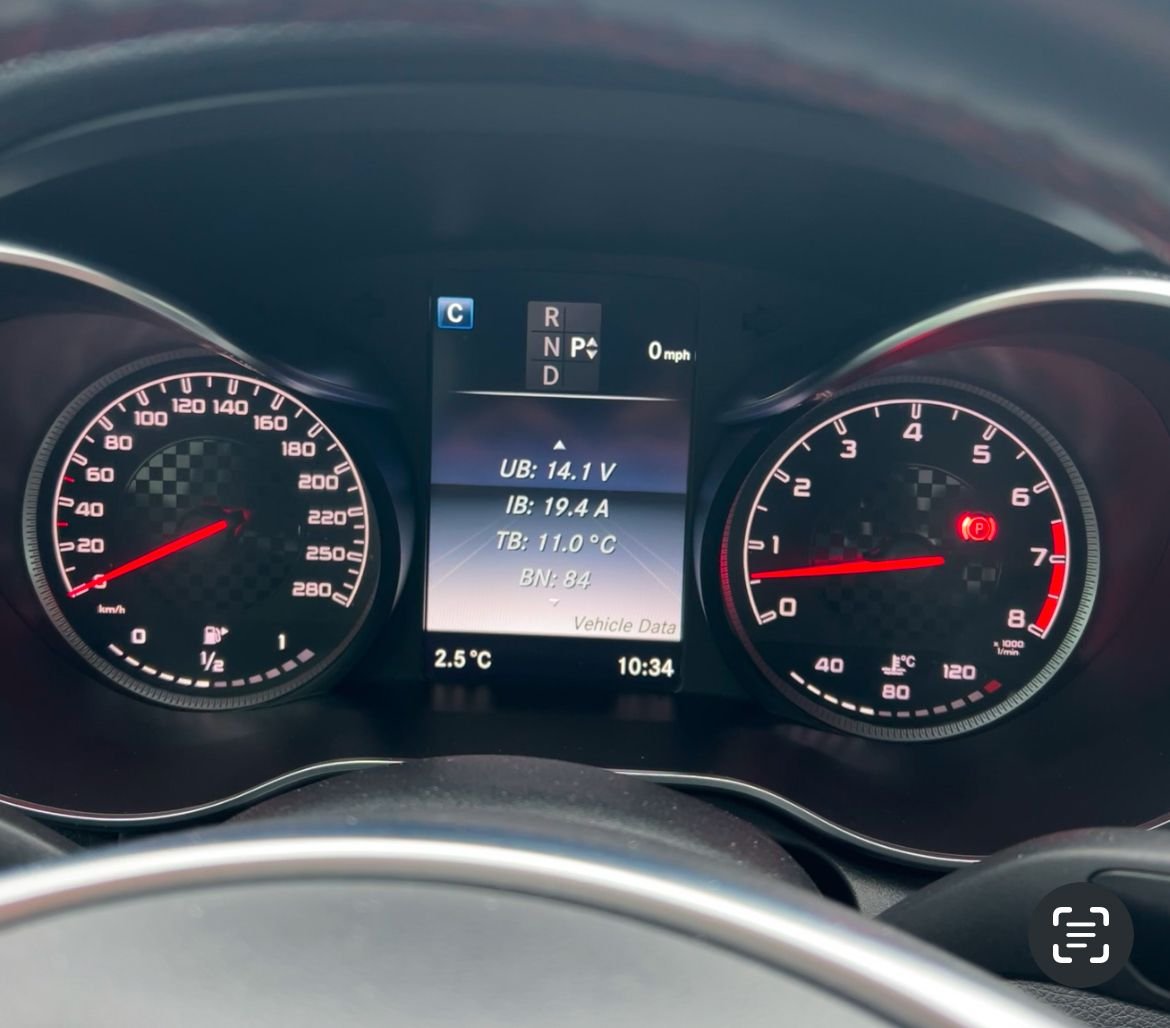

Here's a short 2 minute video of my voltage and amperage after a cold start of my SL400. The voltage holds true at 14.0V-14.1V and the amperage drops in a controlled manner from 17.0A to 4.9A when I ended the video. Amperage continued to drop steadily. The car was idling, so next I will try to get a video while driving.

you're in good shape: this test shows your battery is absorbing charge quickly
