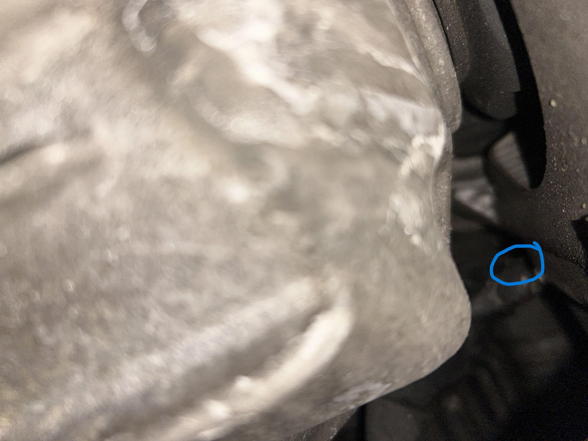

Did you have to cut the ziptie and the cone shaped thing? What did it look like from the bottom?
Old Jan 17, 2025 | 10:24 PM
  #152
Manny_c450's Avatar
Joined: Mar 2022
Posts: 79
C450
you can see the alt in connector from the bottom using a flashlight.. I was unable to get a clear pic due to my camera not focusing. There is a tab and it is black so I took a long flat screwdriver and put it on the tab and sort of tried yanking it, the connector actually just slid out easily after a few tries with the driver LOL. Then I buttoned it all back up.
just a black tab very visible pointing towards firewall(rear of engine). It took longer to button the covers on than the actual disconnect. Also I forgot one stupid bolt for the bottom cover so I will install it tomorrow LOL.
The connector should wiggle out with a long flathead and then you are set. I did not cover the alternator or connector. Probably will leave it like this.

Really? Cool so the actual connector is different than forum member JettaRed's, our is just a slide on plug and I can just yank out?
Correct. I don't even think it's a tab like the typical connectors we have on the timing covers. Just sort of a sticking out permanent tab that you pull on to slide connector. Was not hard at all.

Don't forget about me, I am on the same runway but pretty far from the finish line. 30 hours and counting.
don't worry, now you know it is doable. Let me see if I have any clear pics and will post if they are.
That will be helpful thank you!
Old Jan 17, 2025 | 10:46 PM
  #167
W205C43PFL's Avatar
Posts: 32,676
Likes: 6,419
Even if it is out or focus I am pretty sure it is much much better than the painting style image I uploaded last time of the cone shaped plug.

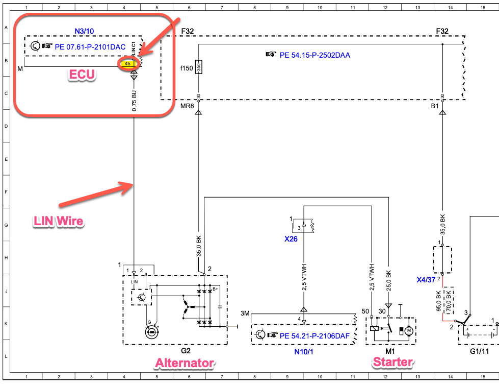

I know you're in the pipe... attack that thing gently don't let it win...
you too deserve more torque and better mpg for free.
Like I said... cutting ALT-LIN in M-connector is faster!!
Then you get to solder a concealed on/off switch to easily wipe ECU Code on-demand... no belly pan dealings ever again.

That said, can you still show me how to do it? Where to cut?
Old Jan 17, 2025 | 10:52 PM
  #171
Manny_c450's Avatar
Joined: Mar 2022
Posts: 79
C450
so there is this notch you see pointing towards the back.. it is what I used my flat head screwdriver on to yank it until it slid out. Took like 4 to 5 tries.
Old Jan 17, 2025 | 10:55 PM
  #172
JettaRed's Avatar
Veteran: Army
iTrader: (1)
Joined: Nov 2016
Posts: 7,847
Likes: 3,498
From: Maryland
Once again, the ALT-LIN is pin 45 on the ECU connector.
Thanks for the image! Looks like I am back at it again then tomorrow thankfully tomorrow isn't too cold.
