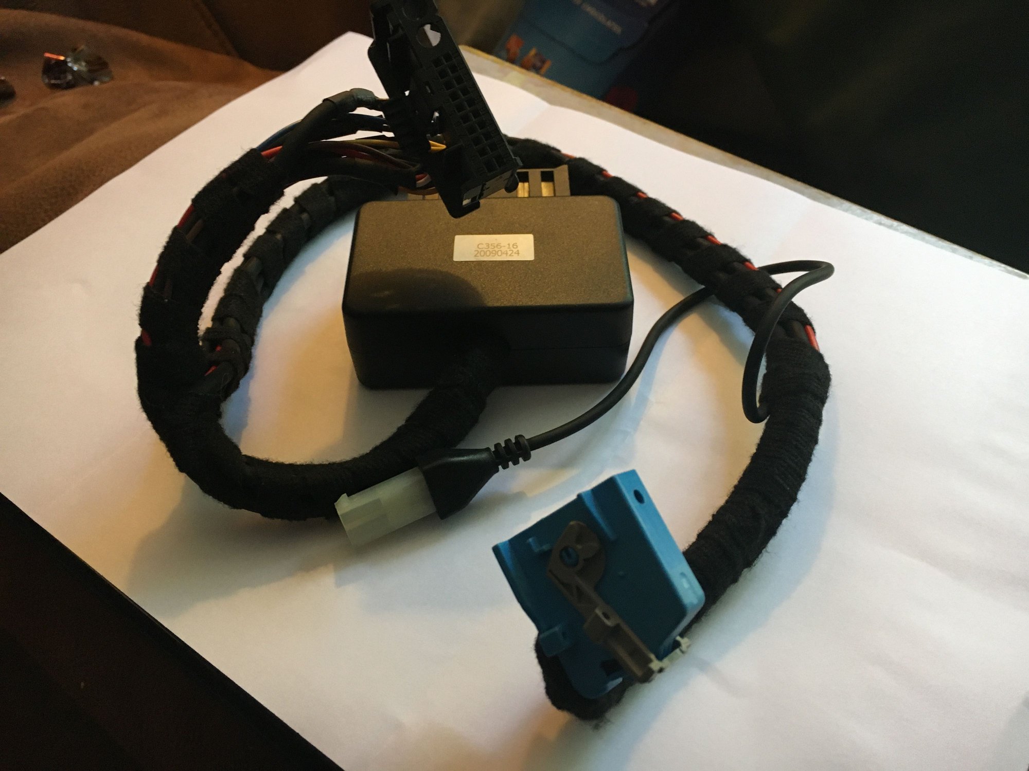

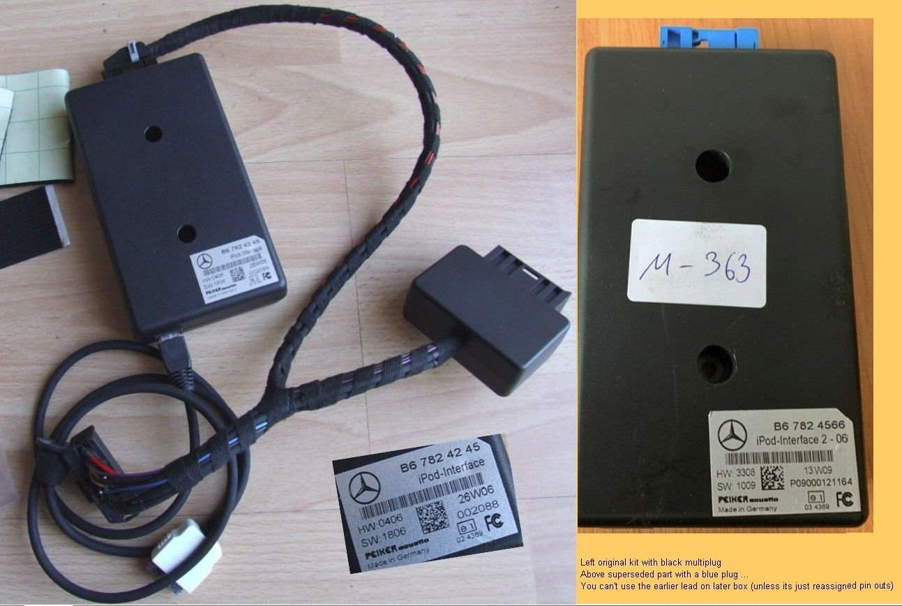

I have the old decrepit add on of the ipod 2 and then on my ipod secretly stashed in hidden settings you can convert all your tracks to vastly higher quality .WAV files and the sound quality of this vs MP3 is about 20 fold better
with the later tech out there for not much can you get lossless stuff to play - you likely want this (or similar)
https://www.aliexpress.com/item/1005007329090344.html?
the extremely rare v2 goes as loud as ALL other sources (after toggling a secret menu) and has a few more options to confuse via its idiot interface and allows the rear view camera night vision to operate (blue plug and later box of trick versus the earlier black plug) - check out how the later cable is almost twice as thick... and with an additional power connector - allegedly to supply later apple stuff with 12V vs the original apple stuff that was 5V only
