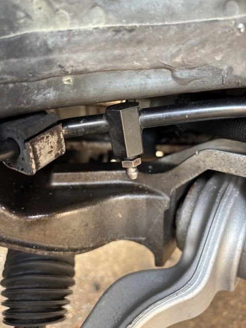

Oh, did anyone figure out what these are for?

2005 SL 500 R230
Bleeder valves for the struts. But you shouldn't need to use them; the system is self-bleeding. Rodeo or drive the car and raise and lower it a few times then all the air is out of the system.
You should take all the pressure off the struts by letting the wheels hang, or crack the bleeders before working on the valve block or the rest of the system, to relieve fluid pressure. Ask me how I know that...
Ha, its even more fun to open one when the engine is running. Resulted in a high pressure wide-cone spray which completely drenched me as I tightened it back up. I had a stubborn problem and hoped this would help, but it did not. As mentioned, the ABC system is self bleeding.

Quite simply the bleed valves are used when replacing components within that circuit. For bleed valves there’s one for each corner. If you have to takeoff or replace a shock or accumulator, lift the car and open the bleed valve and go from there. Same thing if you have to replace a section of pipe.
never ever open a bleed valve when the car is on when the pump is pumping because a 3000psi spray can really damage you by blinding you or ripping off skin.
