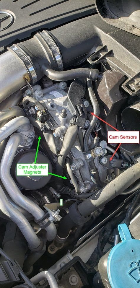

There is an “isolation” harness fix (for leaking magnets: see pic below too). It goes between your cam magnet and wiring harness. It’s a sort of sacrificial harness. So if the cam mhagnet leaks the oil is supposed to get trapped in that “jumper” harness.
it’s a well documented issue do a search for: oil harness cam sensor, and you can read all the horror stories. This is just one:

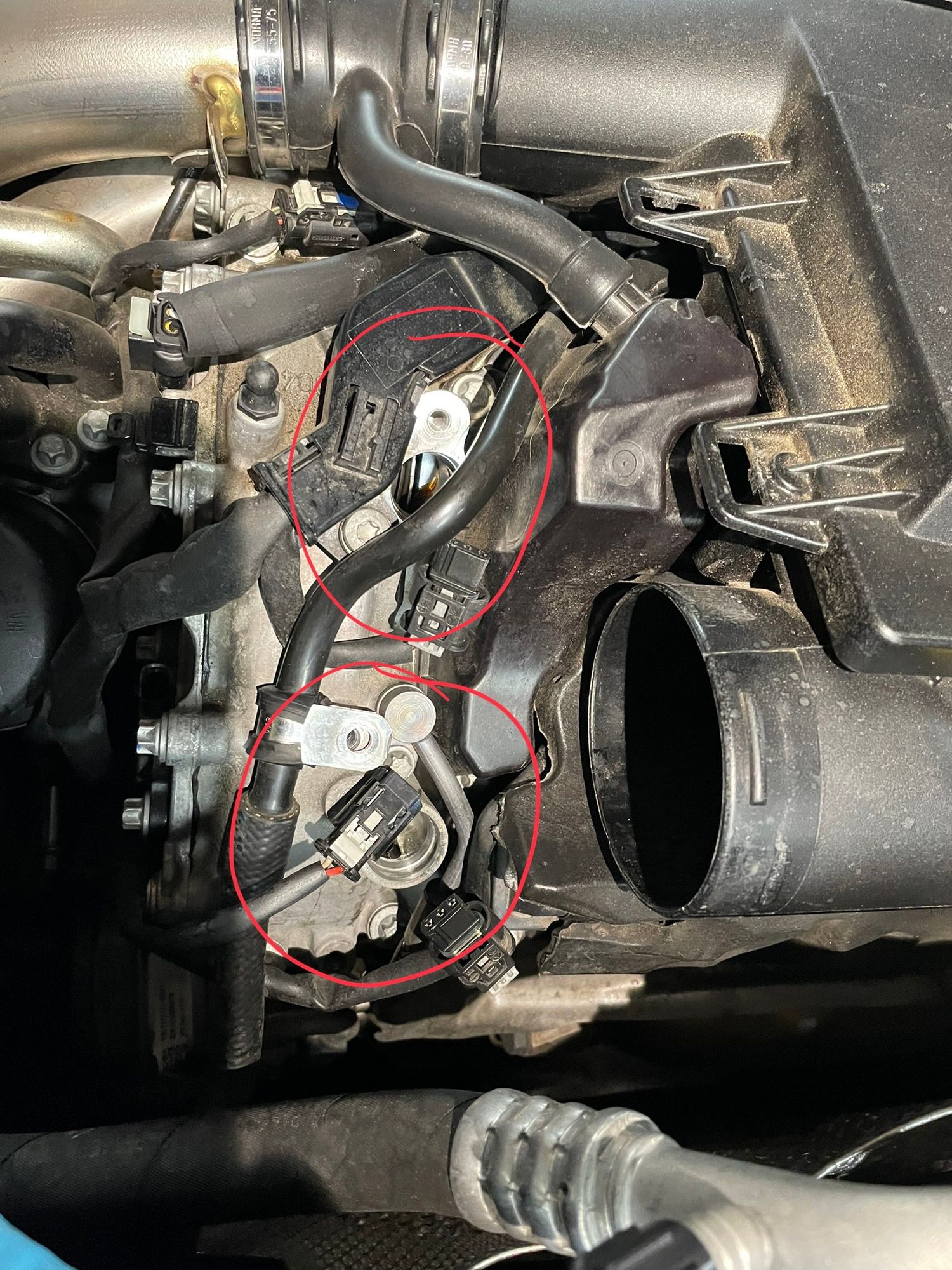

I should mention cam sensor oil leak as the issue?
Depends on your dealers competency and willingness to perform preemptive maintenance. Unfortunately I don’t think there is a current TSB to reference. There is a TSB for the older M271 which had the same/similar issue.
Access to the harness isn’t bad once you have top covers off.
see locations in pic

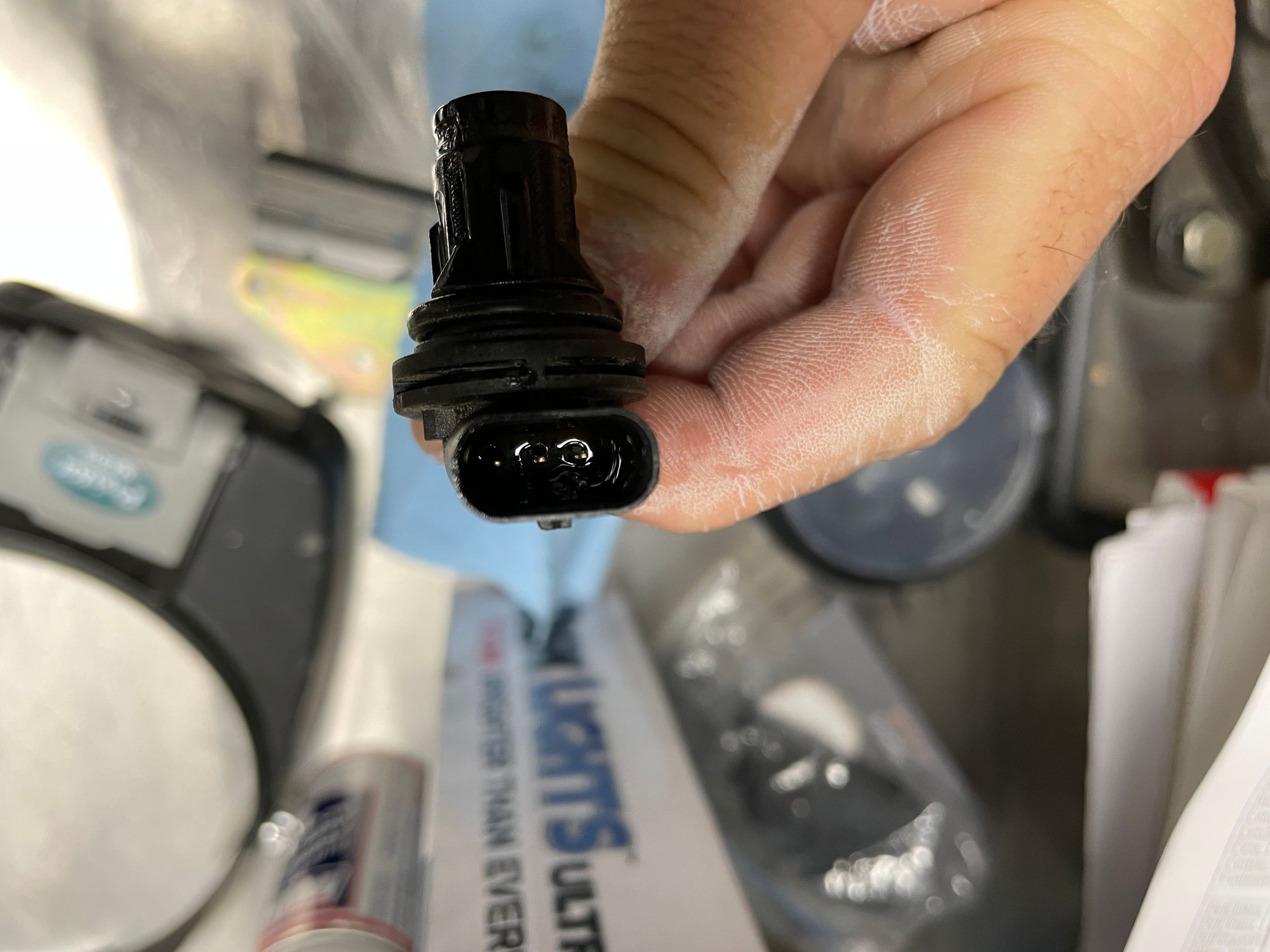

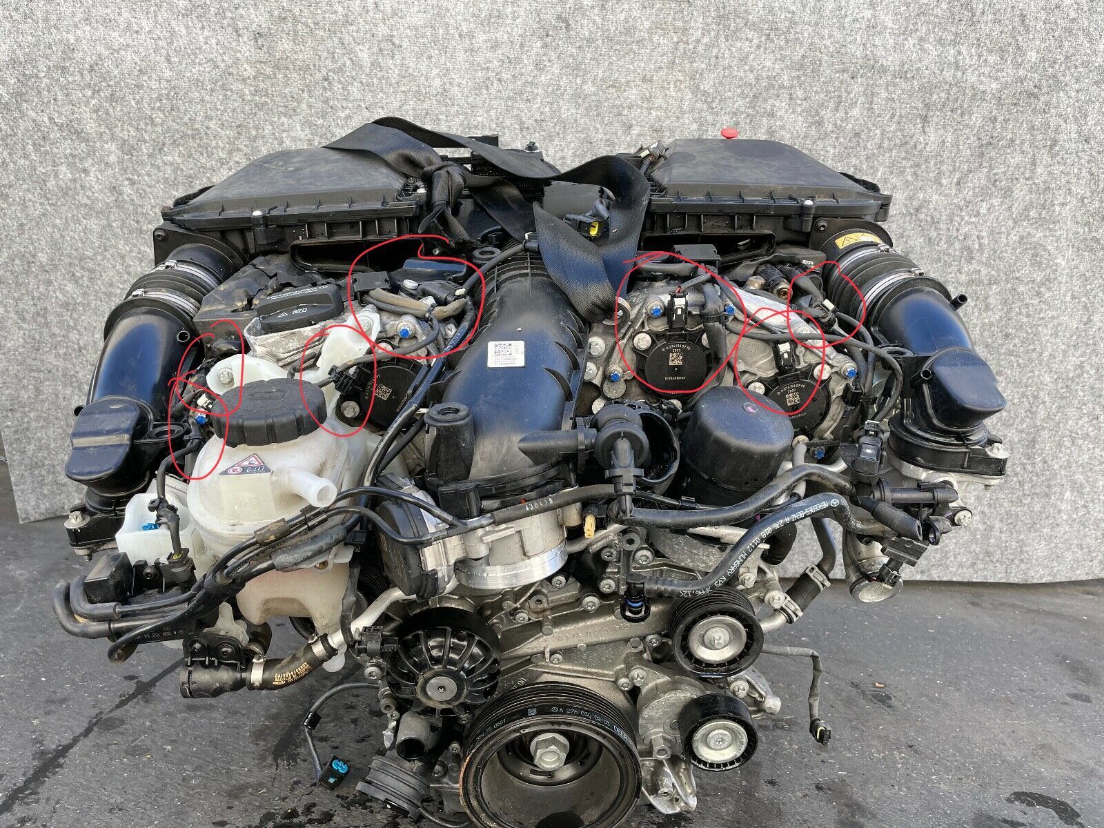

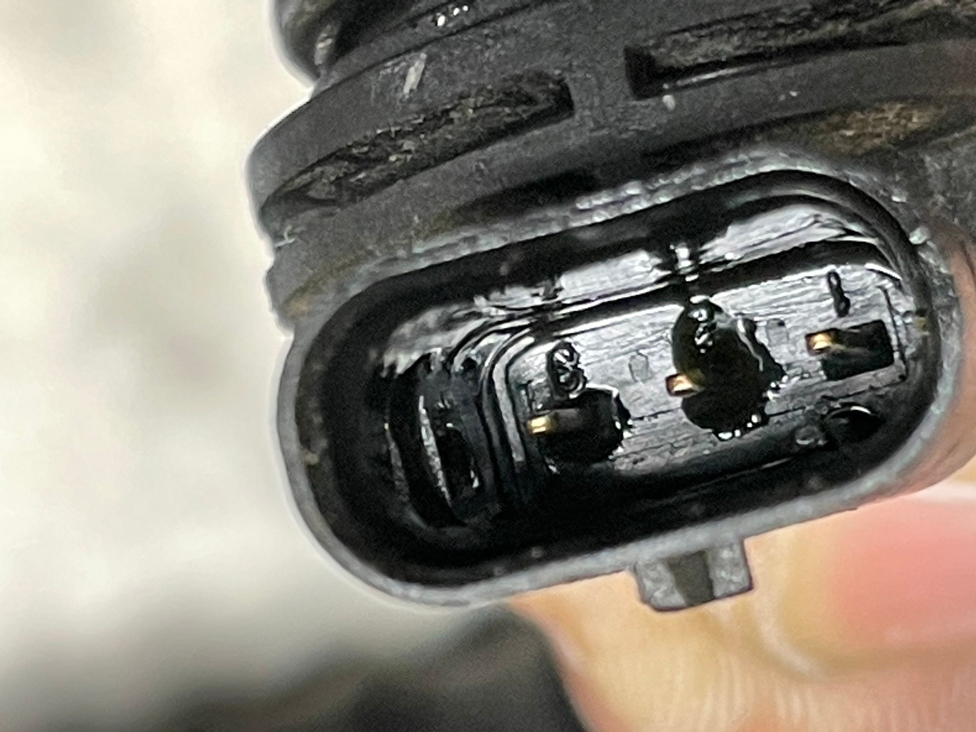

Just to help clarify a little with some better pics.
Here’s a car I recently did with leaking cam sensors. 2013 sl550 in the 45,000 miles range. (bottom 4 pictures)
The connectors at the bottom cam sensors were soaked with oil on both sides 😟
The cam sensors & magnets are the older style.
The sensors are out and you can see the placement (circled in red) It should be similar on m276
There are camshaft control valve magnetic solenoids and camshaft position sensors. The camshaft sensors are more prone to leaking. Especially the bottom ones.
Access isn’t bad once you remove air ducts and covers (M278 pictured)
