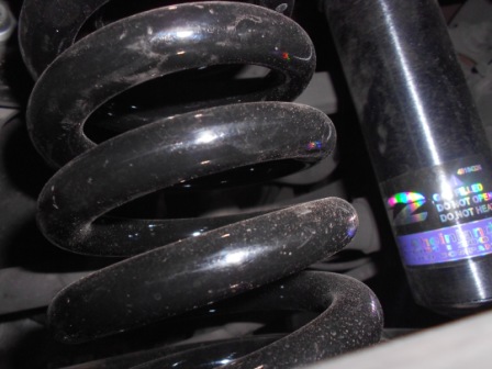

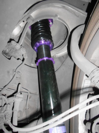

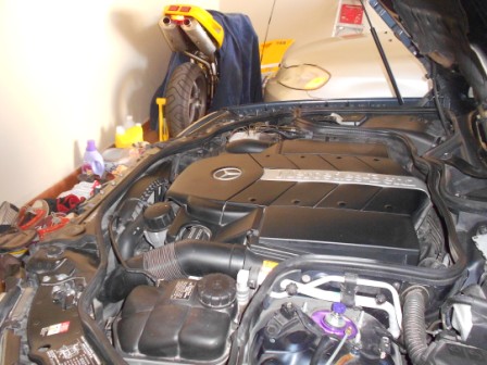

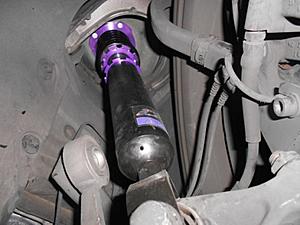

w211 e500 coilovers D2'S
FINALLY DONE!!! VERY SATISFIED....
Attached Thumbnails W211 KW Coilover Swap Part 3-dscn0251.jpg   W211 KW Coilover Swap Part 3-dscn0265.jpg   W211 KW Coilover Swap Part 3-dscn0270.jpg   W211 KW Coilover Swap Part 3-dscn0281.jpg   W211 KW Coilover Swap Part 3-dscn0284.jpg
How much did it run you total?

it cost me 2.2k parts and labor and only needed rear control arm and nuts,bolts.
