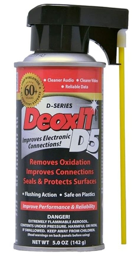

Barry, I have had very good results using this on green crusty connections.
