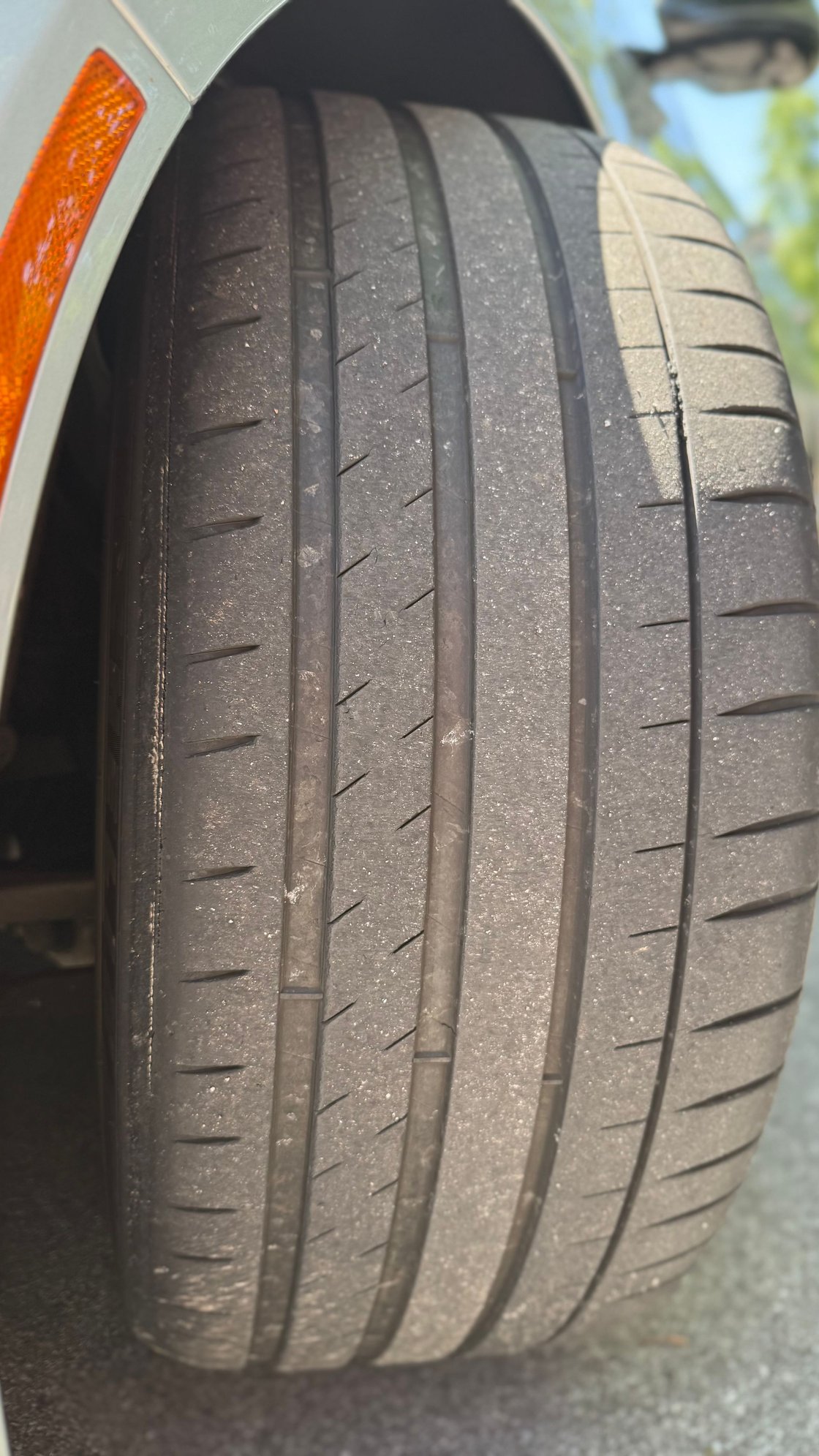

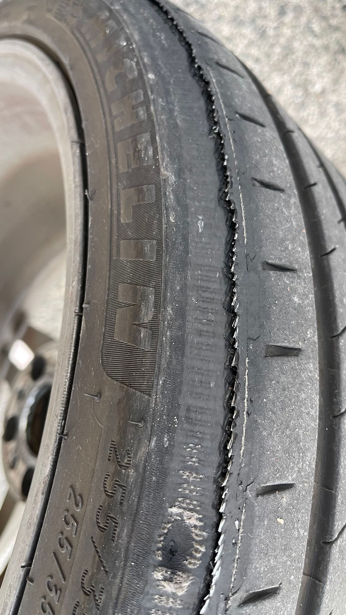

The lowrider life has done its thing and worn the inside fronts to the cords.
Even with the Cete raising to stock at 90 kph the front tires are done.
57,000 kms with half on snows = 23,500 kms, that’s only 15k miles.
Oof!
Rears still look ok.
I stopped lowering to try and stretch these to fall. That’s a lot of tire $$ just to look a bit cooler when parked…
Oof!
this is commensurate with other peoples experiences without the cete module - just the unfortunate wheel geometry of the w213 amg (and 212)
https://mbworld.org/forums/w213-amg/...ber-bolts.html
consider these tires next (ps s5 mo1):
https://mbworld.org/forums/w213-amg/...rt-s5-mo1.html

You need to replace them now, not later. Given we are in the midst of very hot weather, you sure don’t want a blow out.
I know you are right.
Old Jul 28, 2025 | 09:28 AM
  #658
I.T. Guy's Avatar
Joined: Mar 2011
Posts: 2,503
Likes: 1,579
From: Canada
2023 E63S Wagon
Wow what a 1st thread there. I thought it was "my fault" but looks like many stock cars experience the same wear.
Dang
Thank you

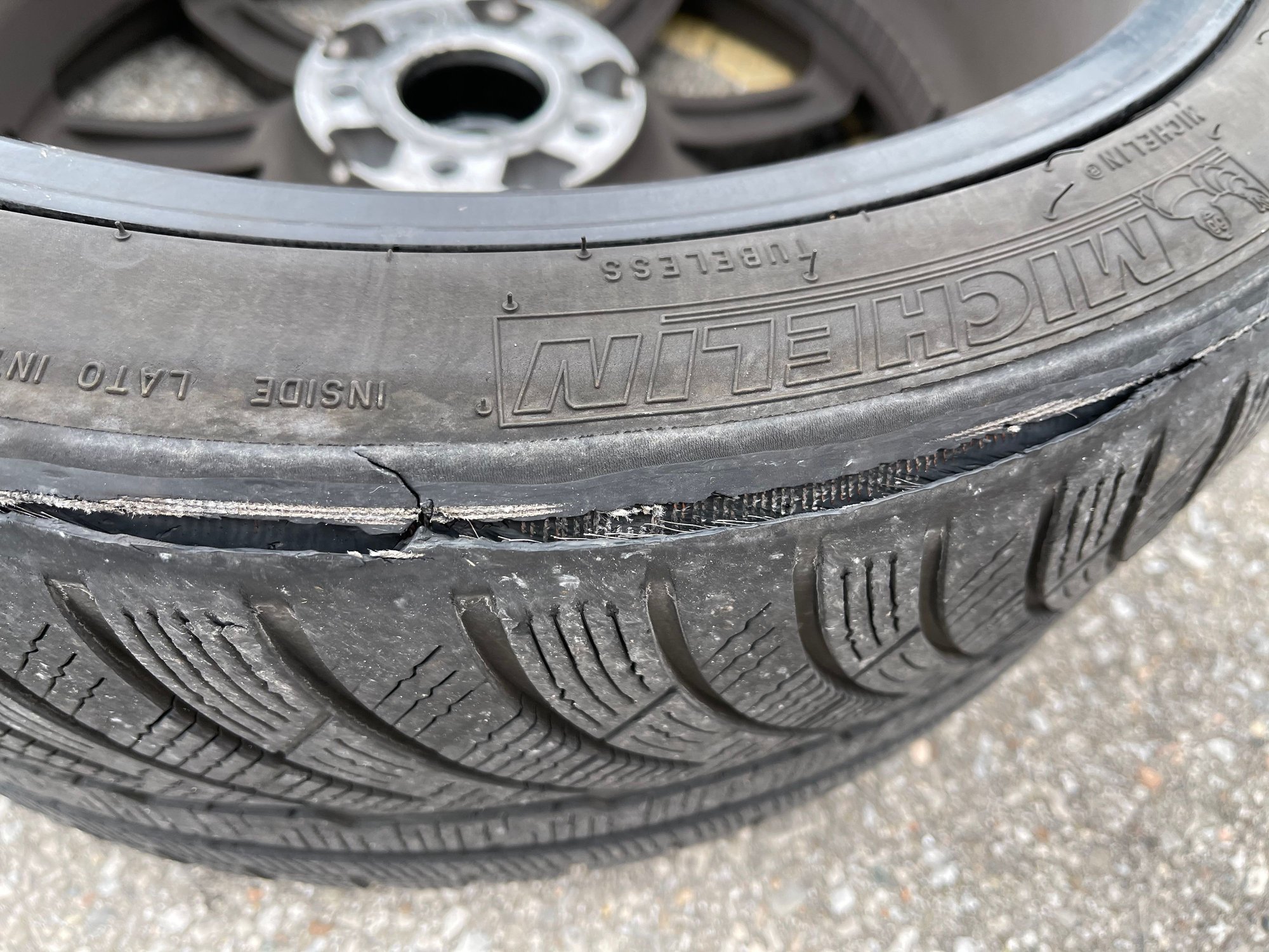

Been there done that 2x in the 212 but thought it was from KW lowering springs. I had hope the Cete raising to stock height at speed would help.
I guess these cars just eat tires.
Summer
Summer
Winter
Winter
Summer
Summer
Winter
Winter
When that happened twice, did you destroy the wheel or were you lucky?
Old Jul 29, 2025 | 12:00 PM
  #665
I.T. Guy's Avatar
Joined: Mar 2011
Posts: 2,503
Likes: 1,579
From: Canada
2023 E63S Wagon
Lucky
The winter one we were going 100kph in the left lane heavy traffic with the kids in the car full trunk on the way to the lake. The warning systems worked and I watched the pressure PSI bleed down from yellow to red as I scooted over slowing down as it approached zero. There was an offramp right there so I decided to sacrifice the rim and drive 1/4 mile to a Wendy's parking lot and safety. I went slow and rim was fine.
The summer one I was alone in the city diving slow and got to pull over right away and put the spare on.
I hate the 213 don't have a place for a spare. I have a euro spare tire, rim, bag, and tie down but leave it in the basement. Keeping it in the car makes the rear annoyingly unusable for how we live ife.

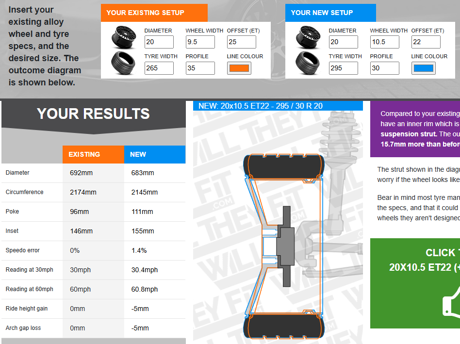

Here's my latest crazy idea for the front wheels.
A 10.5" ET22 wheel puts the outside of the wheel and tire at the exact same place all the "known" setups using 10" rims and ET10 are running at, which is the same as my stock wheel with 15mm spacer. So we know the outside will work.
The 10.5" ET22 wheel puts the inside of the wheel and 9cm inward from what the stock 9.5" ET25 setup is.
I guess I need to measure some stuff and see if the car can clear another 1cm inboard from stock.
