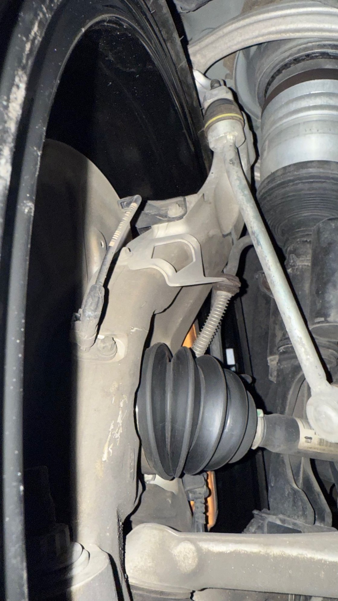

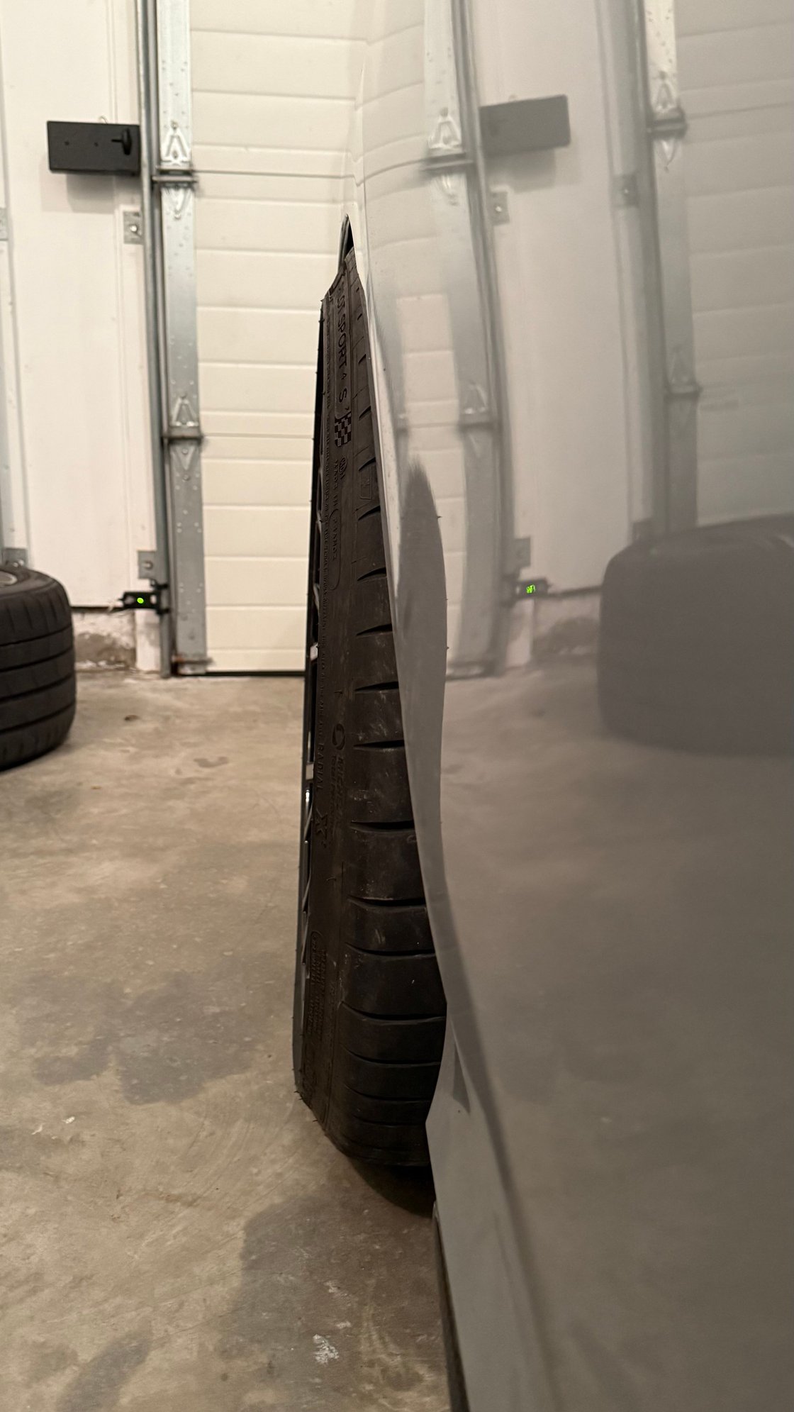

So I had some more fun with front wheels.
I tried to put the 15mm spacers on with the 285/35 tire on the stock 20x9.5 ET25 rims, effectively making them an ET10.
With the spacers the outside of the tire rubs the rear inner fender liner.
So I tried 12.5 mm spacers and the tire still rubs the inner fender liner.
I tried to slip a piece of paper between the fender liner and tire and could not.
No spacers and the tire JUST clears and I can fit paper behind.
So it appears the 275/35 tire size on a 10" rim with good ET is the max tire or it will most likely rub in the same place.
Anyone with 285's and aftermarket rims on the front? ET? Any rubbing?
15mm Spacers 285/35
15mm Spacers 285/35
15mm Spacers 285/35
15mm Spacers 285/35
15mm Spacers 285/35
15mm Spacers 285/35
Outside tire rubs rear inner fender
Spacers off - no more rubbing
Spacers off - no more rubbing and paper fits easy
Minor rub marks with spacers

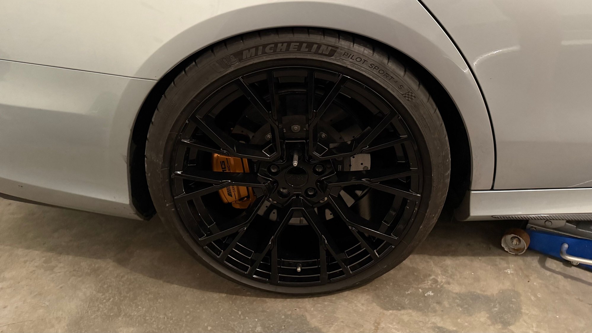

More front wheel fitment fun
For fun I got a cheap 20x10.5" wheel ET 40
With 15mm Spacer effectively making an ET25 a 10.5" wheel fits no problem.
I put the old 295/30 PS4 tire on the rim and put it on the front and left the car lowered - no issues or rubbing at all. I drove all around, hit the known dips and bumps, threw the car around, and 295/30 and a 10.5" rim fits.
Got me to thinking on my 285/35 rubbing issue. Maybe a 285/35 tire on a 10 or 10.5" rim instead of 9.5", would pull the front shoulder of the tire back 1/2" to 1" since the rim is wider in the back, effectively "moving" the tire on centerline towards the inside of the turning radius - maybe giving enough clearance to not rub?
Anyhow if anyone wants a 295/30 on the front on 10.5" rim it works like a charm. I bet if you went 10.5" ET20 instead of ET25 a 305/30 looks like it might even fit.
A 295/30 10.5" square setup would be so cool! I'm going to play with the back next when I have some time.
10.5
10.5" ET 25 with 295/30 PS4. ET20 or ET22 would be even better. Yeah I'd do ET22.
10.5
10.5" ET25 loads of room with 295/30
ET22 might even be better giving 2mm more room on the inside and making it perfectly flush
ET22 or even ET25 would be even be better giving more room on the inside and making the rim be more flush coming out a few more mm
Zero rubbing lowered and driving around
Looks great
Looks great
That cheap black rim has me thinking. Hmmm.

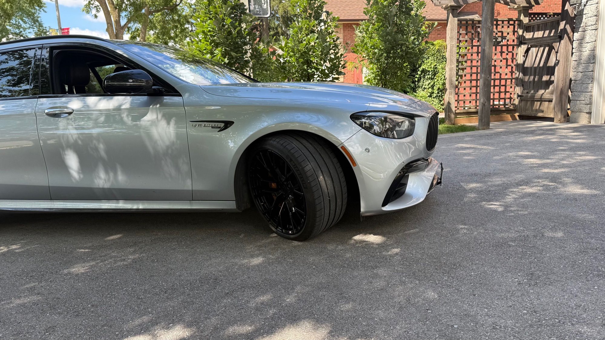

Keep going lower
-35/-35
New tires are Tucked! It’s hard to tell but there’s a good inch of tire up in the wheel wells.
Will try lower tomorrow
Zero rubbing with the big tires
Fronts are 11mm taller then stock, 5mm ride height gain.
Rears are 35mm taller and 18mm Ride height gain!
Front to Rear is 1.8% well under the 3% threshold.
-35mm Front and Rear

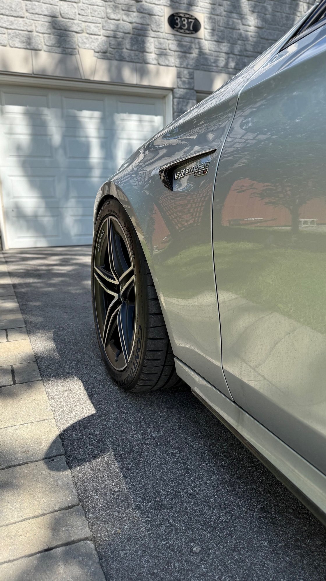

Played more with the rear fitment game.
10.5 ET40 too much poke pics below. So the Ferrada’s are out.
Is ET45 the perfect fit for 10.5’s and 295? Or is it ET50? 45 has the same poke (88mm) as 11’s in ET52. But they also have 14mm less inset which means the tire will center outward more too. But Less 5mm a side tire going 305->295. My head. Hurts.
Thinking about square 295 on10.5. Maybe just do 11 on the rear and 305/295? I dunno though, something about square setups gets me going if I can get the same look front and rear.
Oh and I hate all aftermarket rims again. Still searching.
