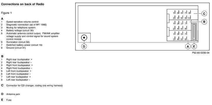

So I pulled out the radio today to take a look at the Stock wiring harness in relation to the the 70-1784 and I noticed on the stock wiring harness there is no corresponding wire for Switched Power. Do I have to tap into another source for switched power?

Mitra....here are the connector pin assignments for the standard W208 (single din) radio.
Here are the ignition switch positions corresponding to when the12 volt supply is present.
15 = switched battery power, hot in positions 2 & 3
15R = switched battery power, hot in positions 1, 2 & 3
30 = unswitched battery power.
87 = powered via (unspecified) relay.

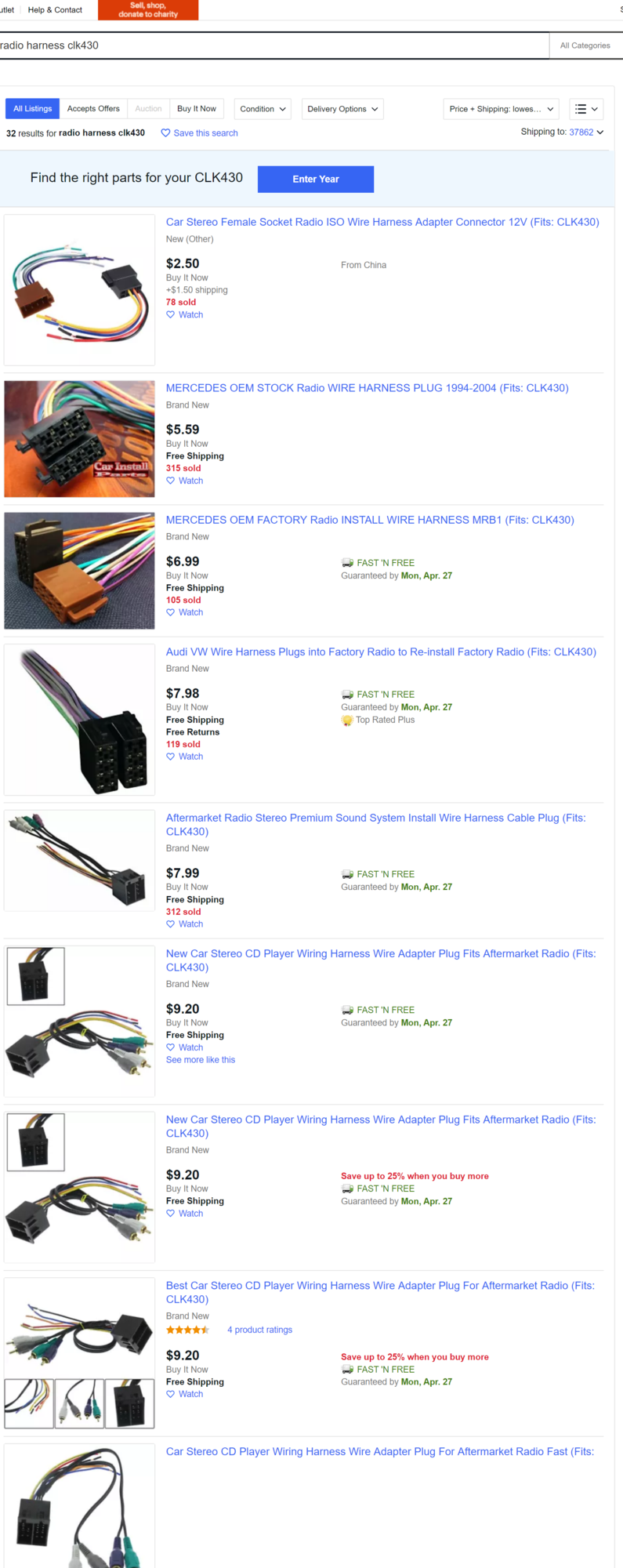

Old Apr 21, 2020 | 06:49 PM
AMD0221's Avatar
Joined: Apr 2020
Posts: 4
w208 clk430
Its a lot radio harness fow w208 on ebay in range $10 to $20 and more.

Take a look at what my stock harness looks like.
You can see the plug "C" has
Pin 4 = Battery Voltage (Constant)
Pin 8 = Ground
Pin 5 = Amp Connection
but there is no pin 7 which would be for switched power.
I have tested all wires with my multimeter and none of them are switched on any of the Plugs. Convicted, I suspect this is a difference between my 2002 and your 1998
