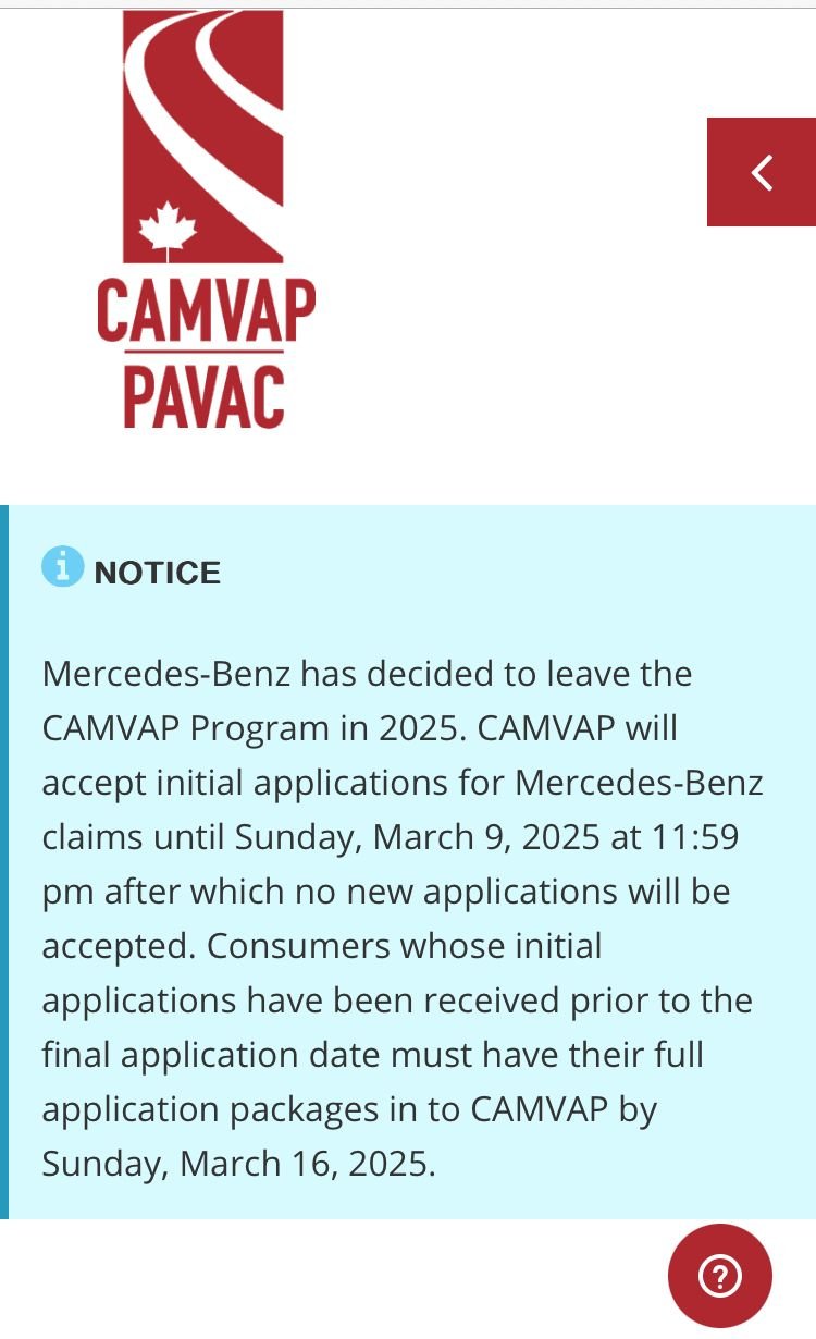

They opted out of the government of canada arbitration process just a week before our roof exploded. It would appear that the process didn’t treat them well. Other manufacturers are still part of the process.
The pictures taken by the third party were submitted to the dealer and Mercedes Benz Canada after they said they still wouldn’t cover the damage under warranty.
Insurance will cover but this is a cost all consumers bear as it should be a responsibility of the manufacturer of all brands.

Mercedes Benz Canada opting out
