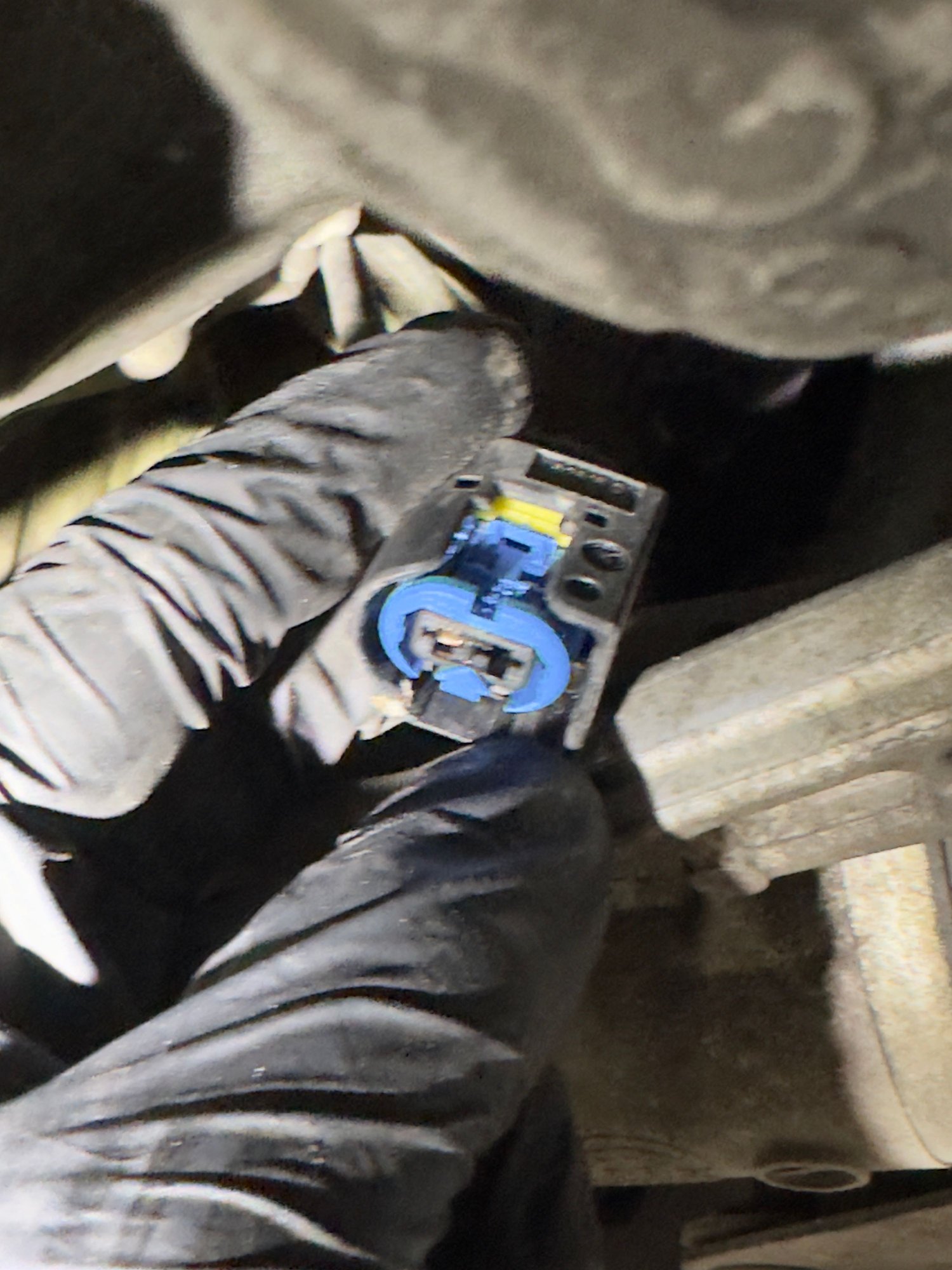

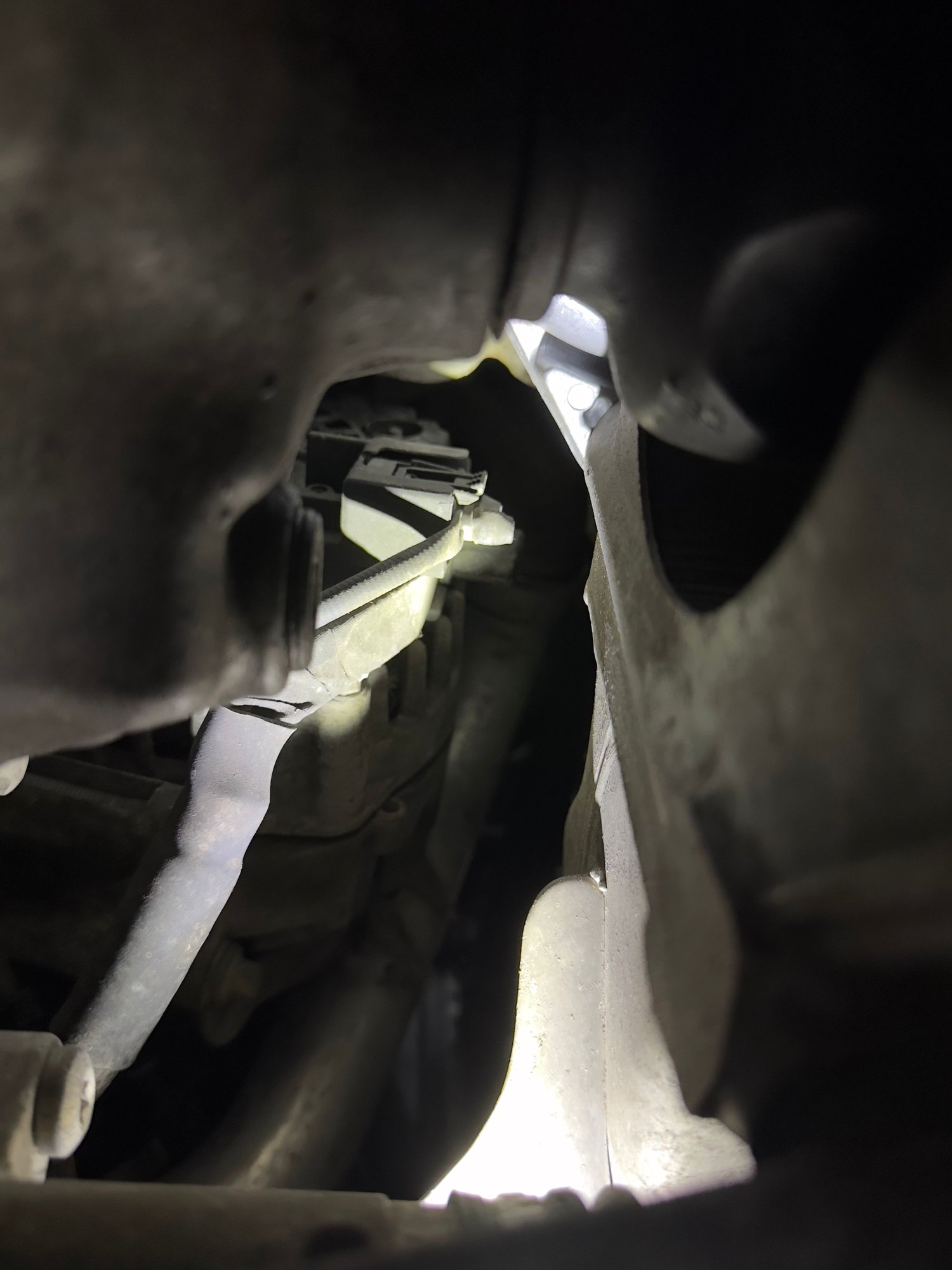

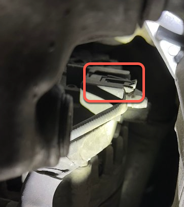

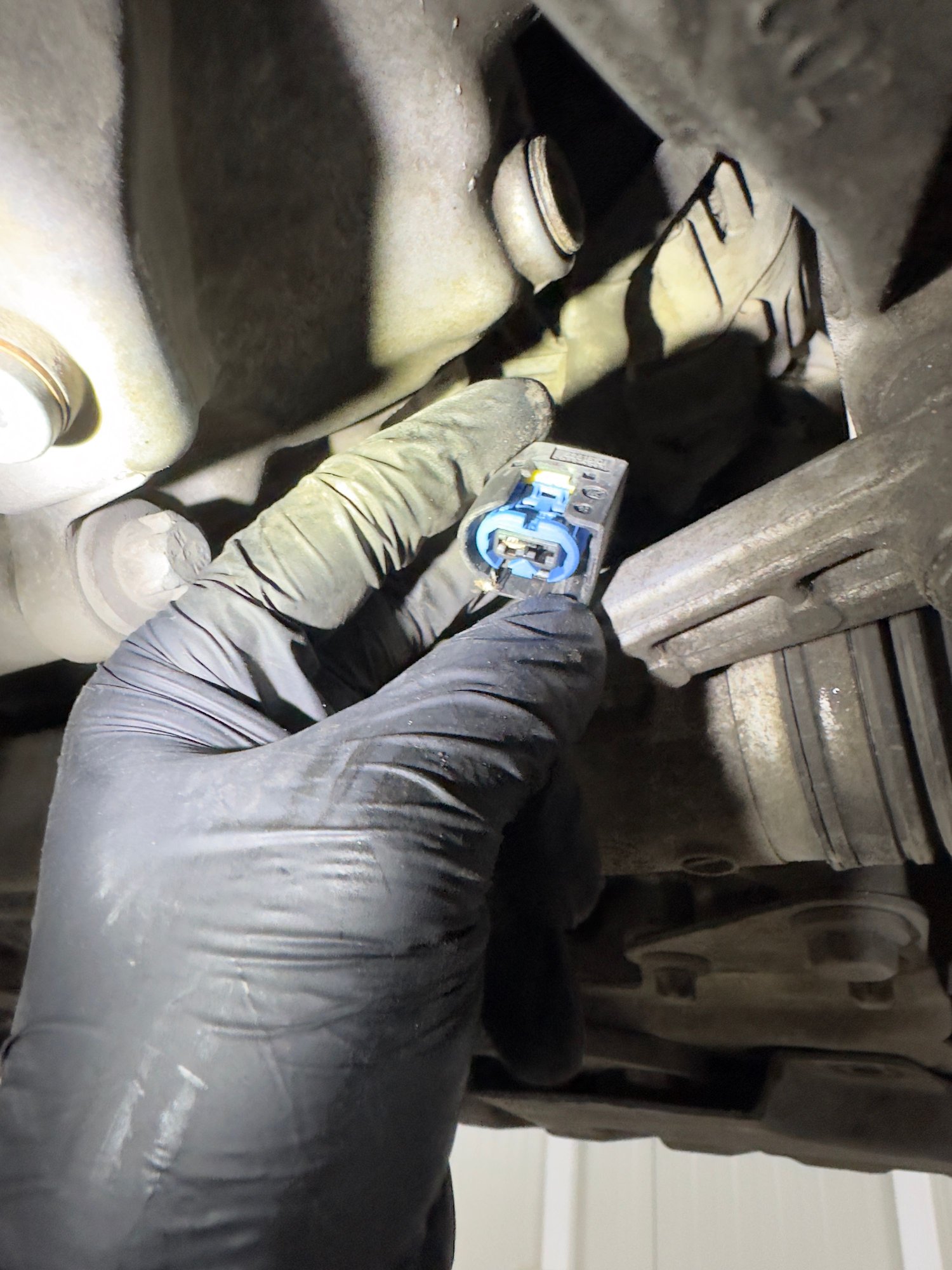

i don't look consumption, im always in the amg screen gauge but i did notice on longer distances when im not alone i drive around the speed limits chilling and compared with latest updates my consumption increased which shouldn't but anyway
i just get unplug hope this is the correct one @CaliBenzDriver ? i took photos as well for other members with m276TT and did a video of warm start
this is when you look at the bottom of the car next to passenger wheel
unplugged
unplugged
unplugged
unplugged

Definitely looks different than mine. Is that a squeeze or a pry to release the catch?
Old Jan 22, 2025 | 10:25 AM
  #314
I put flat head between there and sort of pryed the slider off.
not really sure as i went to friend of mine who have ramp to raise the car and he did it for me
@W205C43PFL @Manny_c450 did you unplug same thing?
https://www.youtube.com/shorts/_KGFyRwvy6E
https://cimg6.ibsrv.net/gimg/www.mbw...9edeb3d52c.jpg
https://cimg2.ibsrv.net/gimg/www.mbw...924fe95801.jpg
unplugged
https://cimg9.ibsrv.net/gimg/www.mbw...c4d313d91b.jpg
unplugged
Yup, identical to mine, looks like all W205 with the M276 has this style connector, again, not sure why MB changed it but hey, all good! Thanks for taking the pictures!
https://cimg8.ibsrv.net/gimg/www.mbw...42e0efba71.png
Ya, I knew it was different but all good : ) strange MB changed it though, that said in my case I just put a flat head like forum member Manny_c450 recommended and wiggled it out, took a minute or I think it was less than that.
