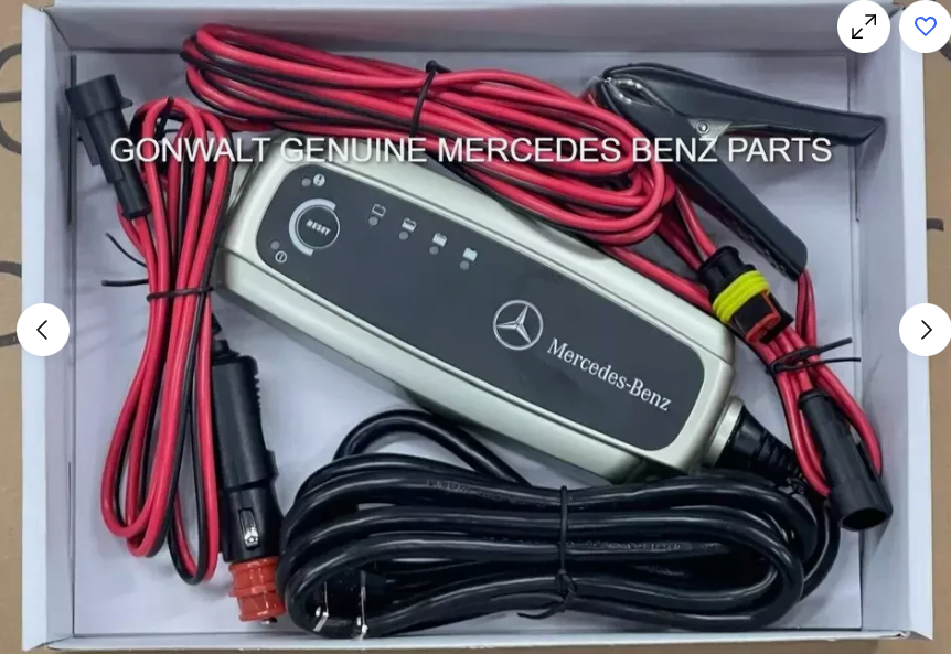

Are these similar to the Ctech charger? Maybe will purchase this one soon.
Honestly, I would just go with CTEK brand. Mercedes relabels CTEK for their chargers.

Yes, goood finds :
the NEXPEAK looks even better than my CTEK
(that NOCO does not look too special)
*** Be sure to READ THE MANUAL***
Specially about charging the battery out of circuit
Don't assume "battery in circuit" is the same as "battery out circuit" !!
The difference is the car electronic circuits are built with little tolerance for higher voltages. DISCONNECT OUT OF CIRCUIT.
(MB uses 16V capacitors in audio amplifier)
In float procedure, "AGM SETTINGS" is used while battery is DISCONNECTED during reboot.

The other question was "how long does this float procedure take? like all night usually or couple of hours?"
(referring to the step "CTEK float Batt on "AGM setting" while unplugged")
Do you know?
Do you know?
Awesome.... is not me!
it is your Mercedes with "normal" setup conditions with luxury OMG self-tuning.
> FLOAT HOW LONG :
this is a goood question that ultimately tells you about the reality of your battery health.
-- Healthy battery 1Hr
-- Tired old battery 7Hr
Do a regular float as much as you want but "AGM Float" is normally reserved for DEEP CYCLE BATTERIES with severely imbalanced cells. Don't indulge in AGM float cycle too often...
