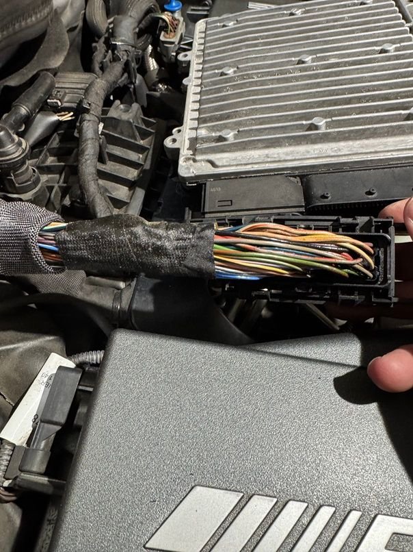

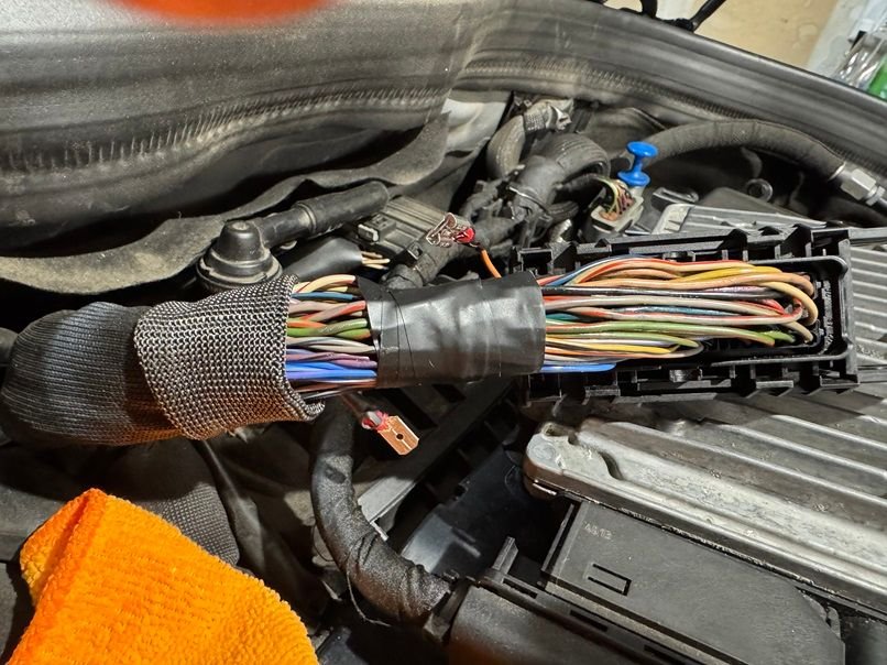

Now that MS! has identified exactly what wire this is, install a toggle switch or simply cut it inside back cover: done!
I'd leave the fragile connector pins alone. 🤞
Yeah, that's my "plan A" -- the problem is that the large ECU connector looks pretty complex to disassemble without braking a whole bunch of tabs. But, I'll give it a shot this weekend.

Ok - line on pin 71 cut in a semi-permanent way... that wasn't nearly as bad as I thought it would be

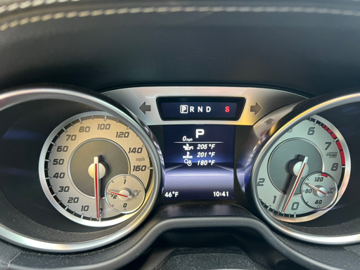

First drive was a success - but, as can be seen on the schematic, removing the ALT-LIN at the ECU also disables the oil level and temp sensor. This, in turn, will prevent me from being able to use launch control... and I can't tell when the oil is >= 176F in the AMG menu, which is important to know so the engine doesn't get pushed before it's ready... so, cutting at the ECU might not be the right move and I may reconnect it...

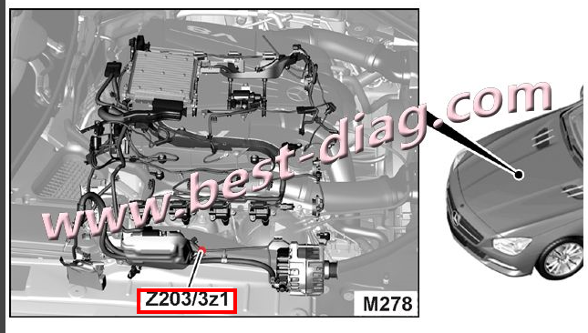

What year is your car again? I have the AMG Menu modification from @BenzNinja which basically adds the menu to the IC for non-AMG cars. It shows oil, coolant, and transmission fluid temps.

This picture (from Starfinder) may help.

HARD TO REACH LOCATION
Thanks JR!
this is the right way to locate that LIN splice where ALT branches out from oil sensor LIN.
The actual splice location may not be more practical with any better access than alternator rear connector

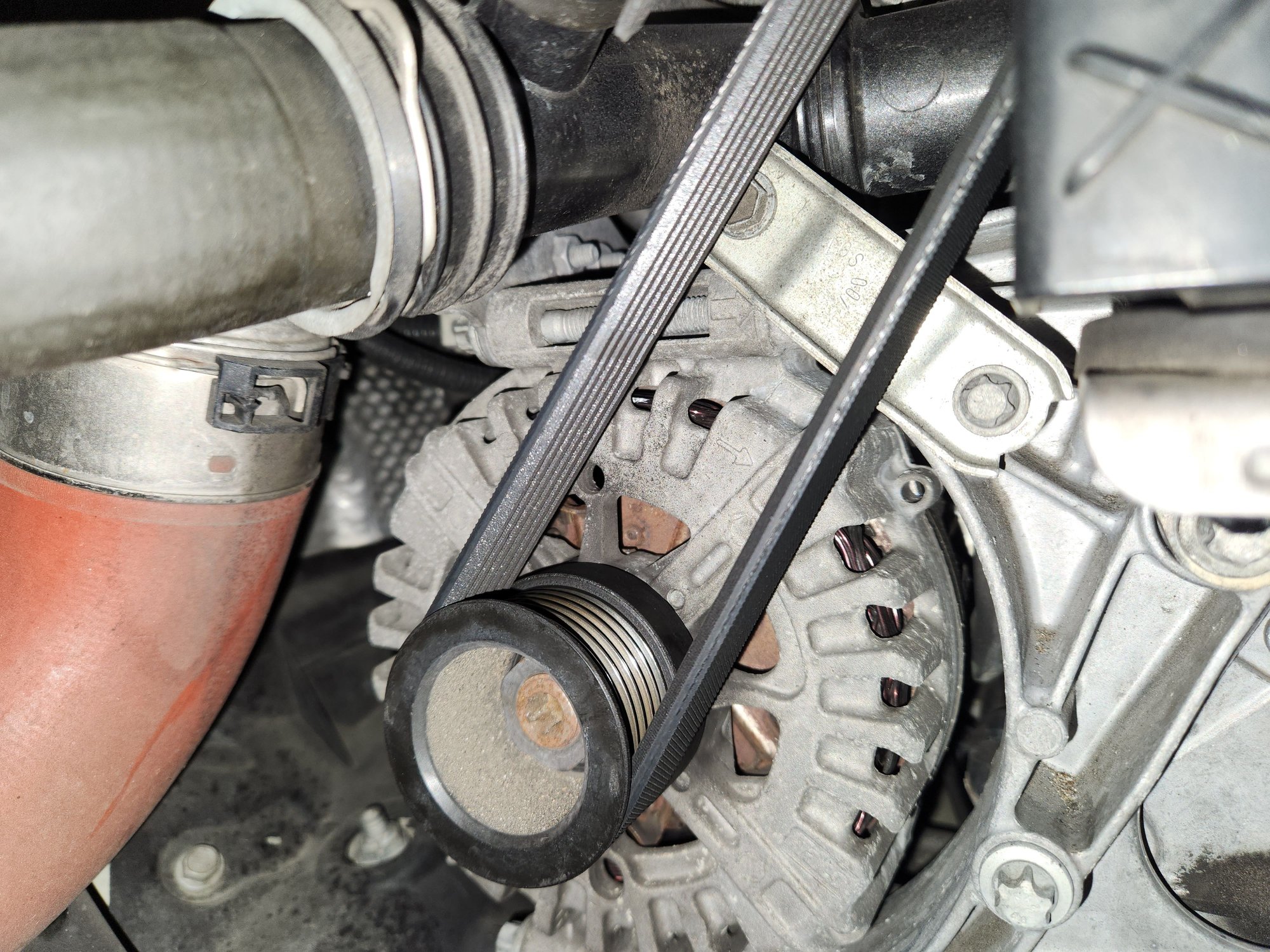

Originally Posted by S-Prihadi
True, but maybe a LIN connected one can do earlier or lower RPM to operate, we do not know the actual cut-in speed of M2721.8 or OM651 alternator
Confirmed 1,000 rpm is the trigger to start charging for OM651. If I do a light blip under 1k rpm nothing happens.

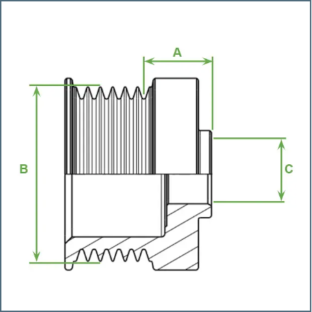

If I may know your VIN, I want to check if this is because of a typical Valeo alternator, or because your alternator has AOP pulley. Overunning pulley.
AOP pulley is being discussed here : https://mbworld.org/forums/e-class-w...ml#post9118647
The AOP pulley P/N for my friend's M271.8 is below : ....................NOTE : A646-xxx the older P/N , there was a diesel engine OM646
The alternator for M271.8 is below : 150 amps valeo

Sargy's Avatar
Joined: Feb 2025
Posts: 75
Likes: 41
Good and important info, thanks
VIN: WDDHFOEBOFB153234
Pulley is fixed/solid piece
From Valeo:
