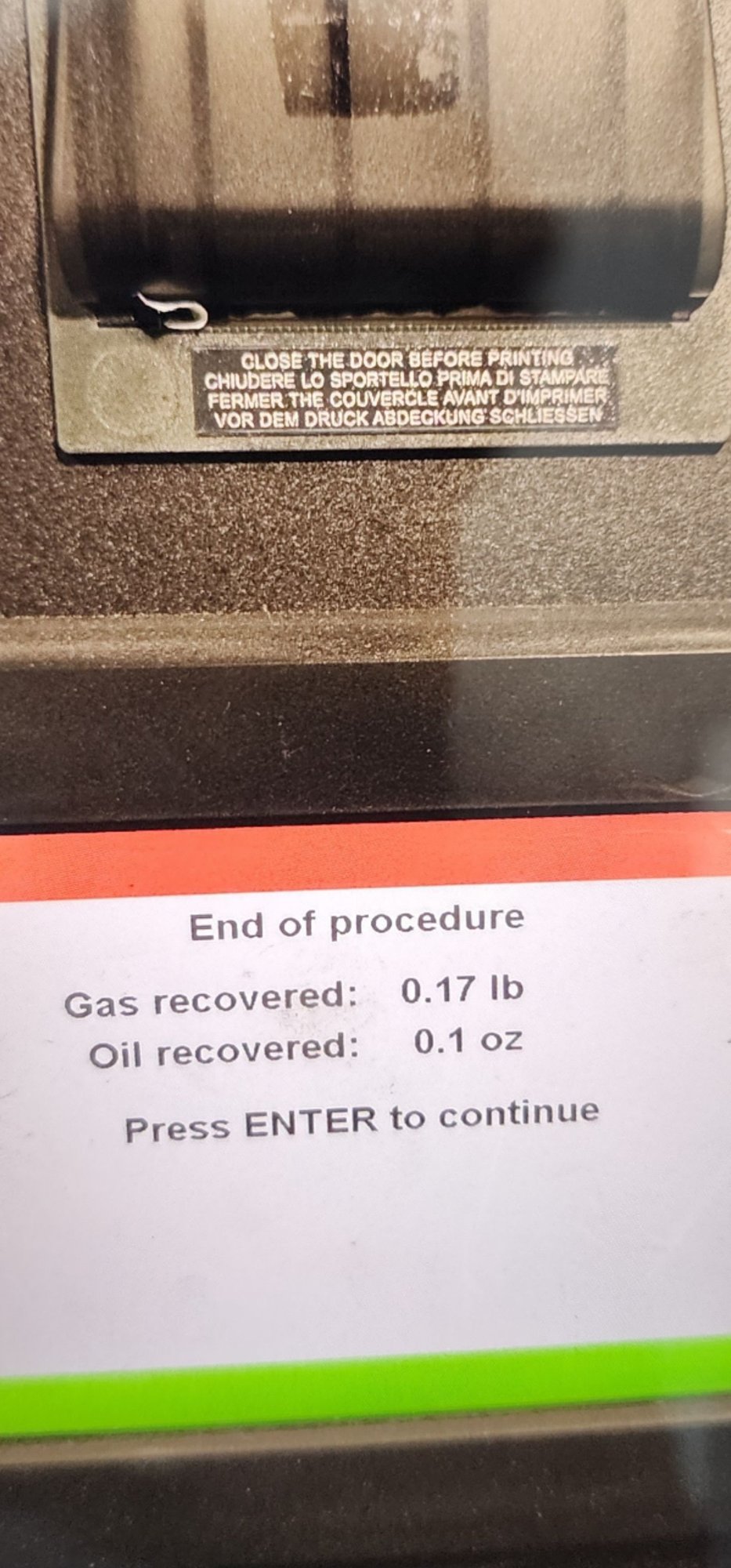

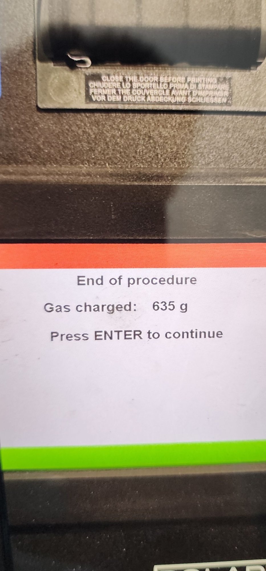

Okie Dokie so an update. was intended to go to a shop tomorrow so Wednesday but I had something to do today and I figured since I needed to go out anyways might as well stop at a shop. So here I am. Turns out the vehicle was very low on refrigerant (I guess we expected that), likely a leak as also expected. I did not ask them to use leak dye filled refrigerant since I really have to get it done quickly at that time. Compressor checked ok, the hissing noise is completely gone or minute to the point I can't hear it anymore at all fan speeds.
I am pretty happy... for now.
Will monitor.
again... Much much appreciate everyone who helped me!

I also said no to stop-leak because I know that stuff is bad in general for the entire system, the seals etc. and those that are used in a/c system wouldn't be better?

This is a perfect bush fix. Nearly charged by weight without scale
Now get on finding your leak:
Condenser pin leak ?
Compressor shaft seal ?
Service ports Hi/Lo side?

R134A RECOVERED .......... Dang 0.17 lb is 77 grams only. You have a leak guaranteed.
Oil accidental sucked out 01. oz is 2.8 grams, no worry.

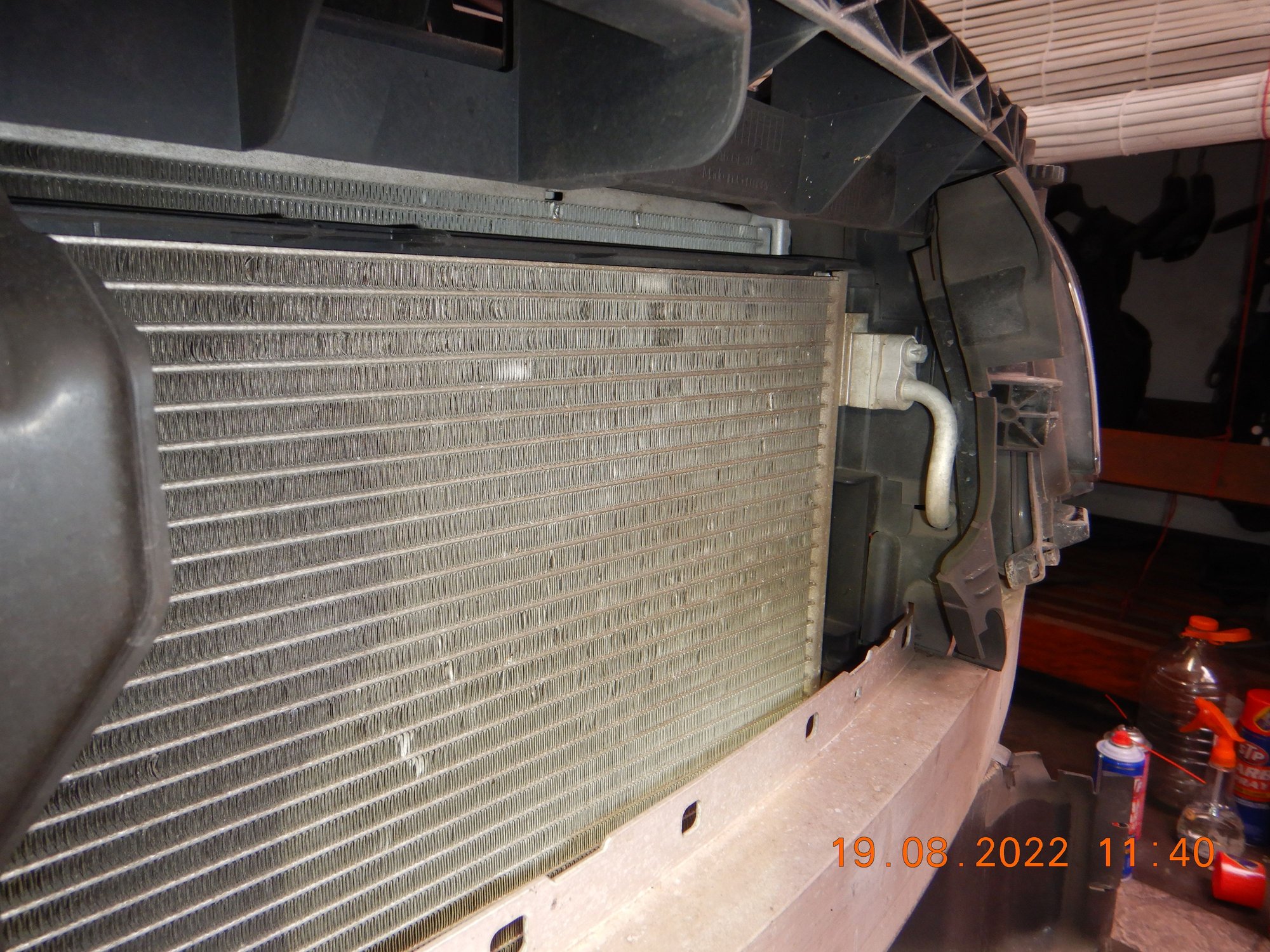

At ACcompressor, IN and OUT pipe-hose. Also has o-ring. This is the hottest region of the HVAC. Subaru often failed its o-ring here.
At IHX mini internal exchanger interface.
At condenser IN and OUT connection and the refrigerant pressure sensor, its rather challenging, but at condenser fins and tubes, you best inspect and spray.

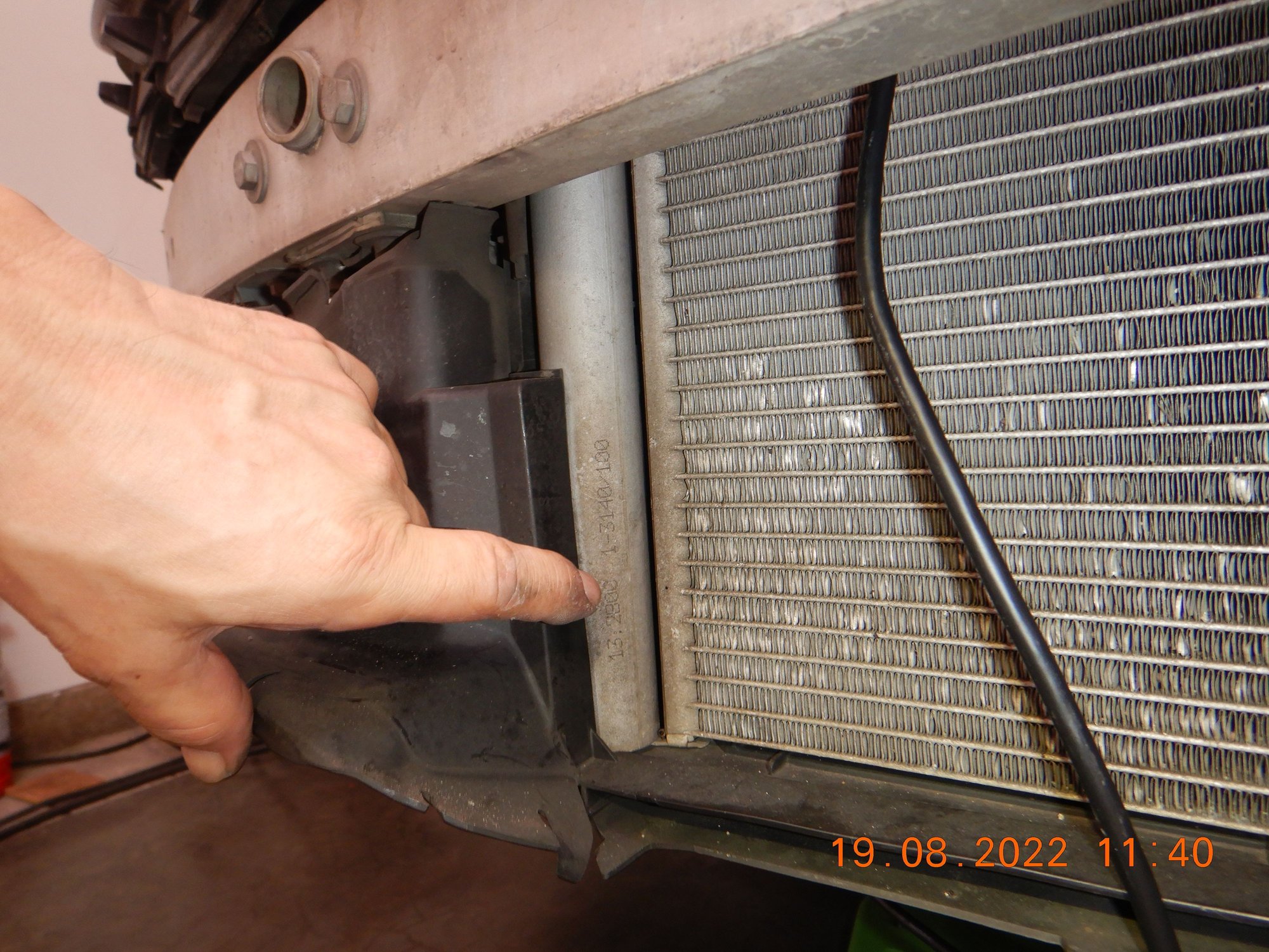

If leaky condenser and is at opposite hidden side ( towards engine ) , not easy to see itsR134A leak out bubble.
Usually front side ( bumper side ) is the one getting stone chipped and leak.
https://cimg0.ibsrv.net/gimg/www.mbw...9e83cc0bbc.jpg
https://cimg8.ibsrv.net/gimg/www.mbw...94eaa1a638.jpg
https://cimg9.ibsrv.net/gimg/www.mbw...5ef132a4f5.jpg
Happy leak hunting...........
