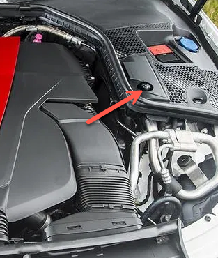

I just realized I might had messed with this at some point, what is this turn knob thing?
Original image: https://images.pistonheads.com/nimg/..._AMG_011-L.jpg
Top left corner.

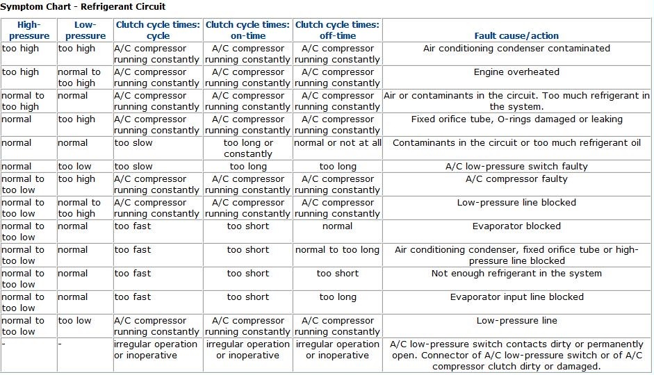

Originally Posted by JettaRed
The Schrader-type valves on the high and low ports could be a source of leaks and it won't be visibly apparent. Low refrigerant can cause the evaporator to freeze up (literally). To much pressure can cause the compressor to turn off (safety issue). Sounds like time for a trip to Harbor Freight (or Canadian equivalent or Amazon) for a set of HVAC gauges. The proper way to diagnose an a/c problem is reading the high and low-side pressures.
https://cimg5.ibsrv.net/gimg/www.mbw...d4e05a8af3.png
https://cimg1.ibsrv.net/gimg/www.mbw...bbd8fd487c.png
https://cimg8.ibsrv.net/gimg/www.mbw...e6885e19e2.png
Thank you forum member JettaRed!

Any idea what that turn knob is though, it seems to be connected to the a/c conduit though.

That turn knob is to recharge refrigerant. I think I am starting to know what happened, I recall messing with this last year curious what it is, maybe I left the cap loose and the refrigerant leaked out. Thanks both for your help.
Top left corner.
Need a bigger picture. Maybe use MS Paint to identify what you are talking about.

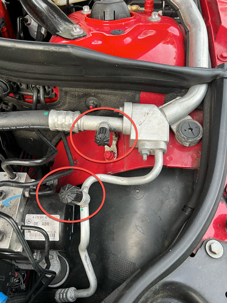

Is this what you are talking about?

Sorry about that yes it is that.

Yes, that is where you recharge refrigerant I figured, I probably left the cap loose last time and it evaporated?
Do you think I still need the full set of professional hvac measuring tools or simply a recharge can with a meter, if so which one do you recommend? Or what is the oem part number by chance? Thank you : )

Those are just caps and the Schrader valves are beneath. Not sure which is the high side and which is the low side, but they are different sizes and the gauges can only connect to the correct line. Here are the caps on my C350 and SL400. On other cars, the caps are sometimes blue and red.
C350
C350
SL400
SL400
Old May 7, 2025 | 07:49 PM

Also, futzing around with the caps doesn't hurt anything. I think they are there to keep dust and dirt out of the valve, not to hold pressure. You may do well to take the car to an A/C specialist if you don't want to mess with it. If any repairs are needed, you need to go to a shop anyway because they collect the refrigerant with special equipment. In the US, it's a violation of federal law to vent the refrigerant to the atmosphere. Plus, you don't want to inadvertantly breathe a lot of that stuff.

If the Schrader vavle is leaking, the cap only slows the leak, it won't stop the leak. I had to replace the valve on my 2000 Ford F150 last year because it had begun to leak. They are like the valve on a car tire or bicycle tire. The valves are replaceable. The problem is that you have to evacuate the system and capture the gas. The after repairs, you need to run a vacuum pump for quite a while to evacuate the system of any air that got in. Once that is done, you then add exactly the amount or R134a that is specified on the sticker in the engine compartment. If you don't want to invest in all the equipment you'll need, then taking to an A/C specialist is the way to go. AND, the problem may be something else. If you want to know for sure, you can get some dye to add into the system and then use a UV light to look for any leaks. Most auto parts stores or Walmart or Amazon have the dye leak detector kits.

there is a special A/C tool to replace schrader valves without opening the circuit. First see if they are leaking.
Big pipe is low pressure cold-return to compressor
Skinny pipe is high pressure hot-side to expended coil.
Feeding is done only on low-side, the compressor suction side.
I think this is had to do with Compressor valve issue (not TXV).
