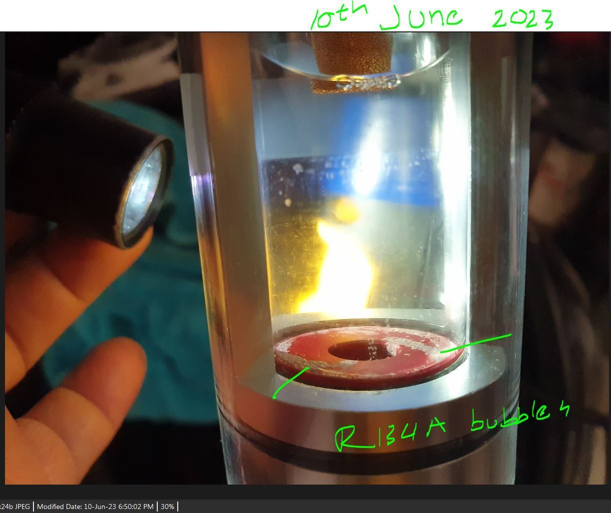

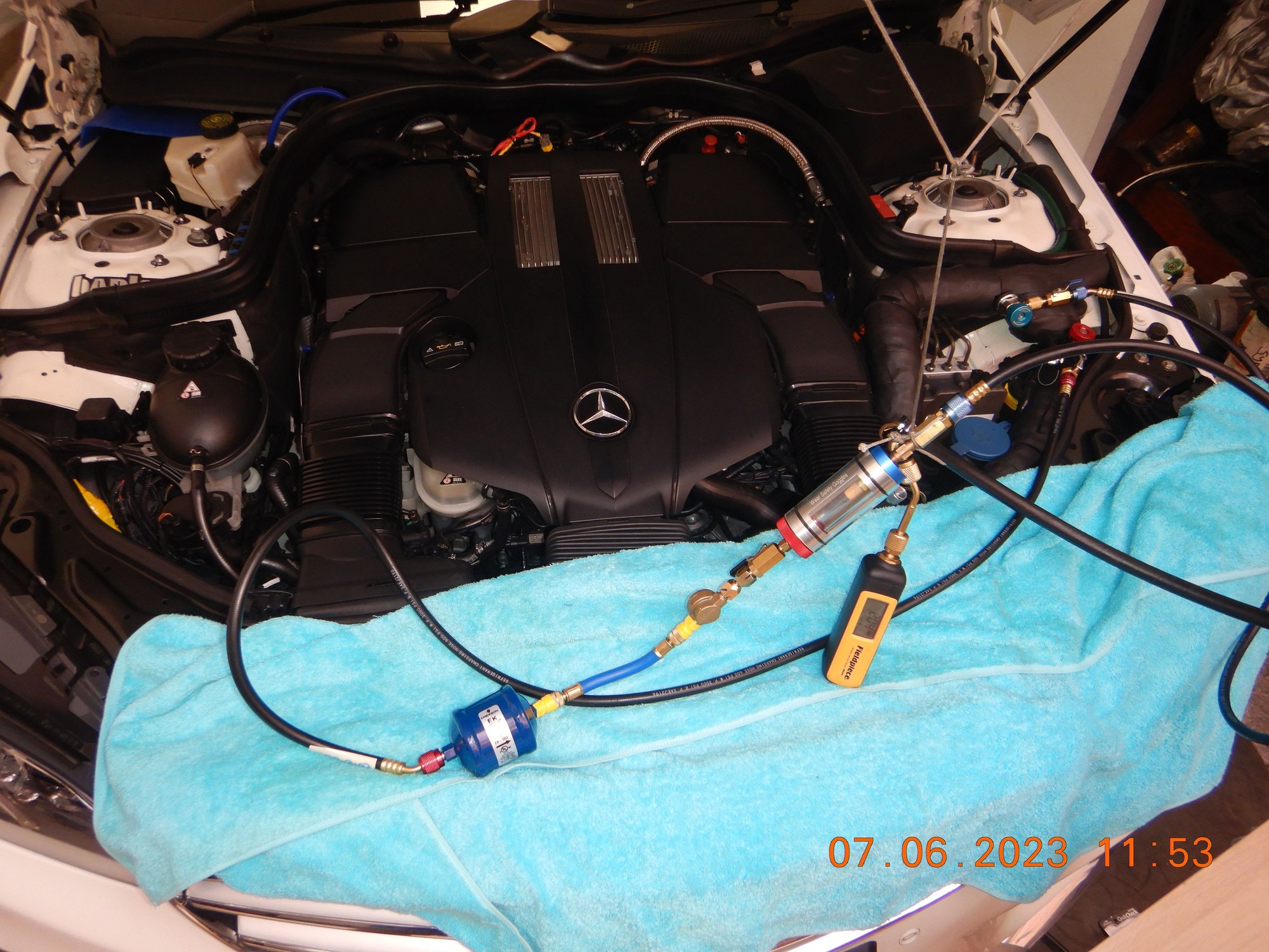

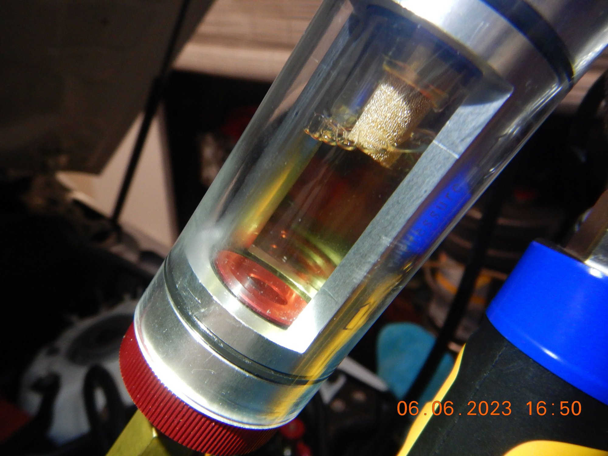

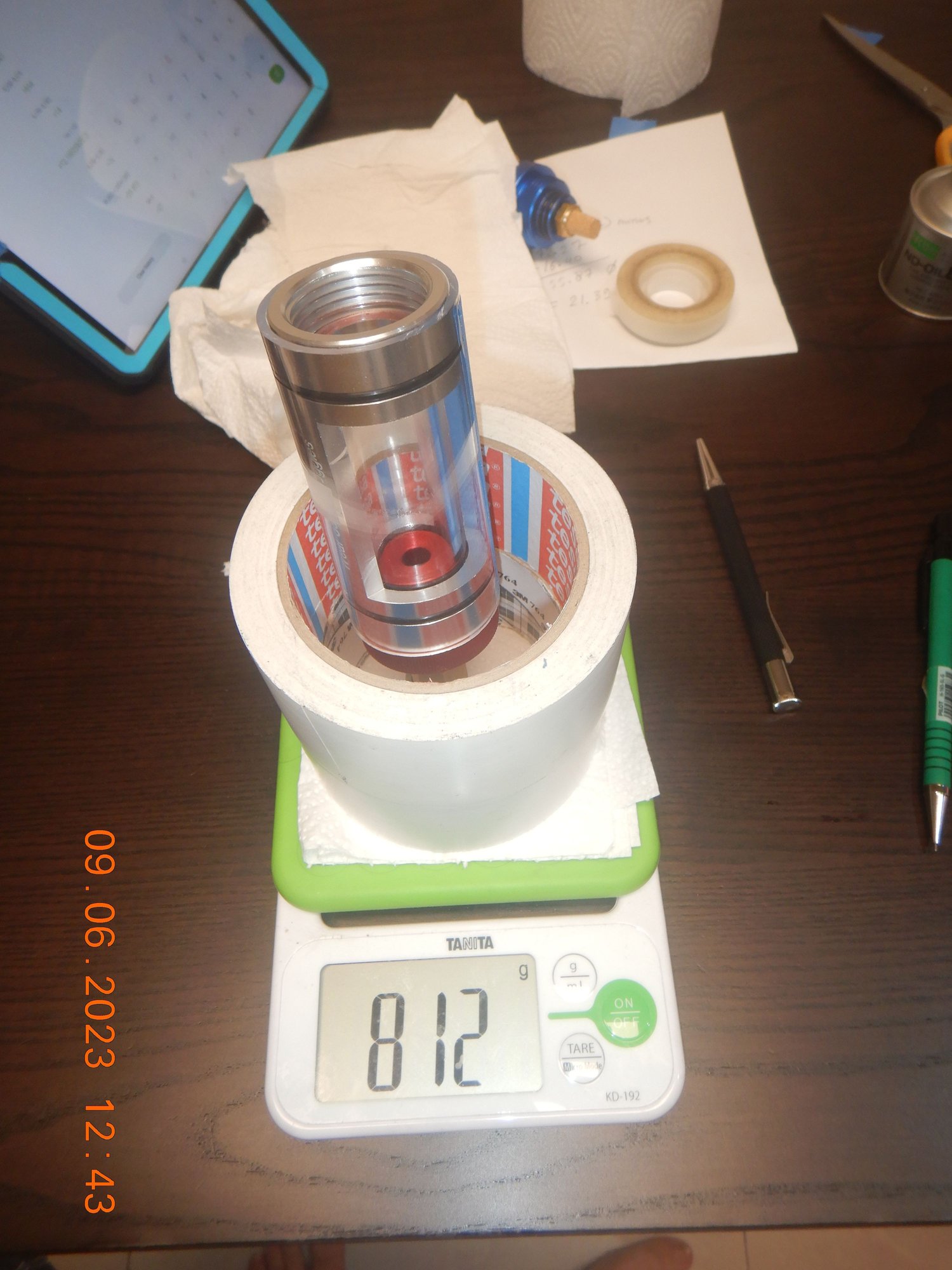

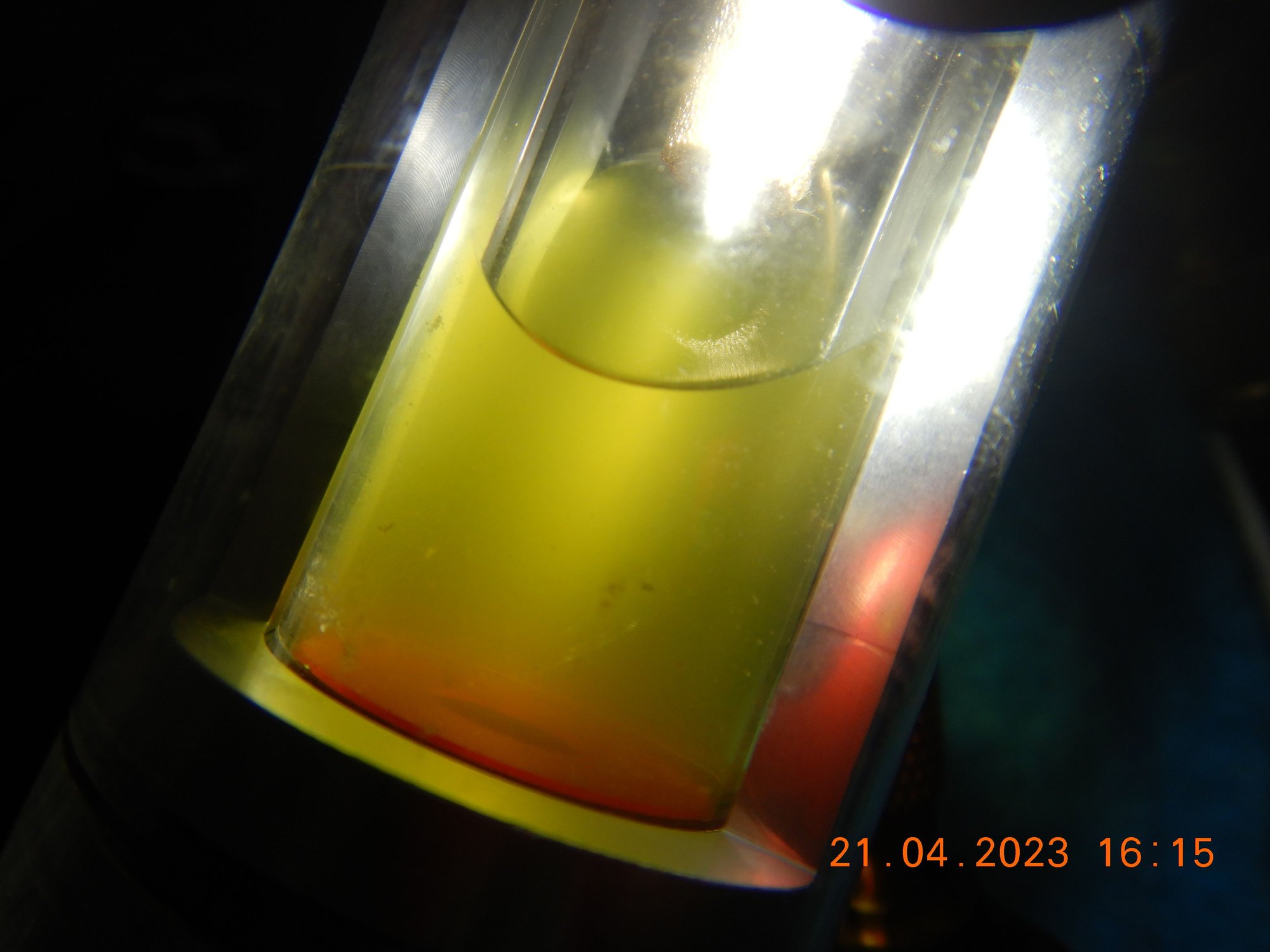

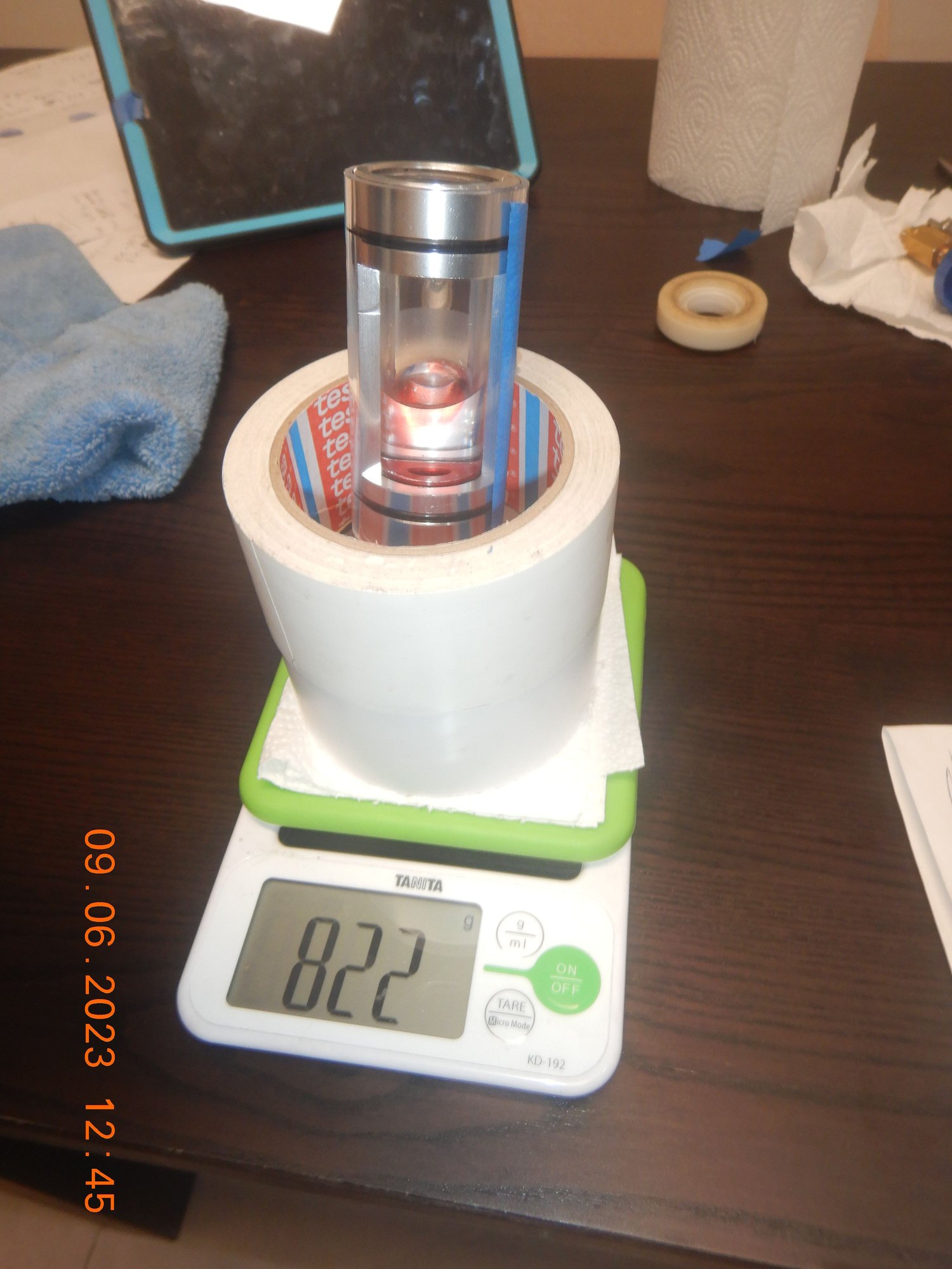

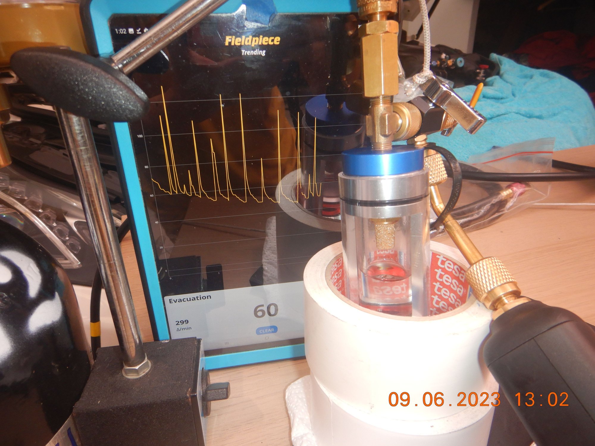

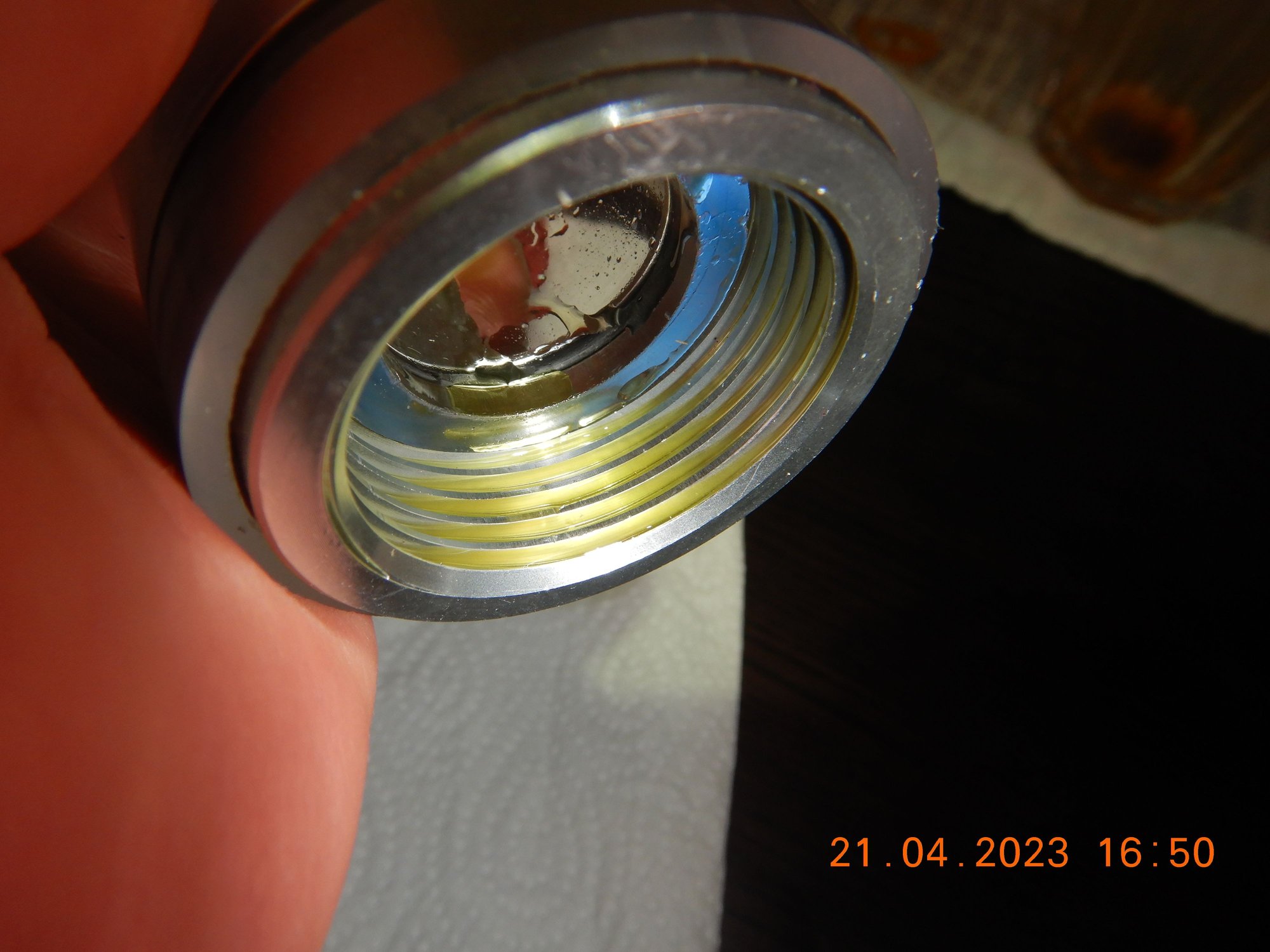

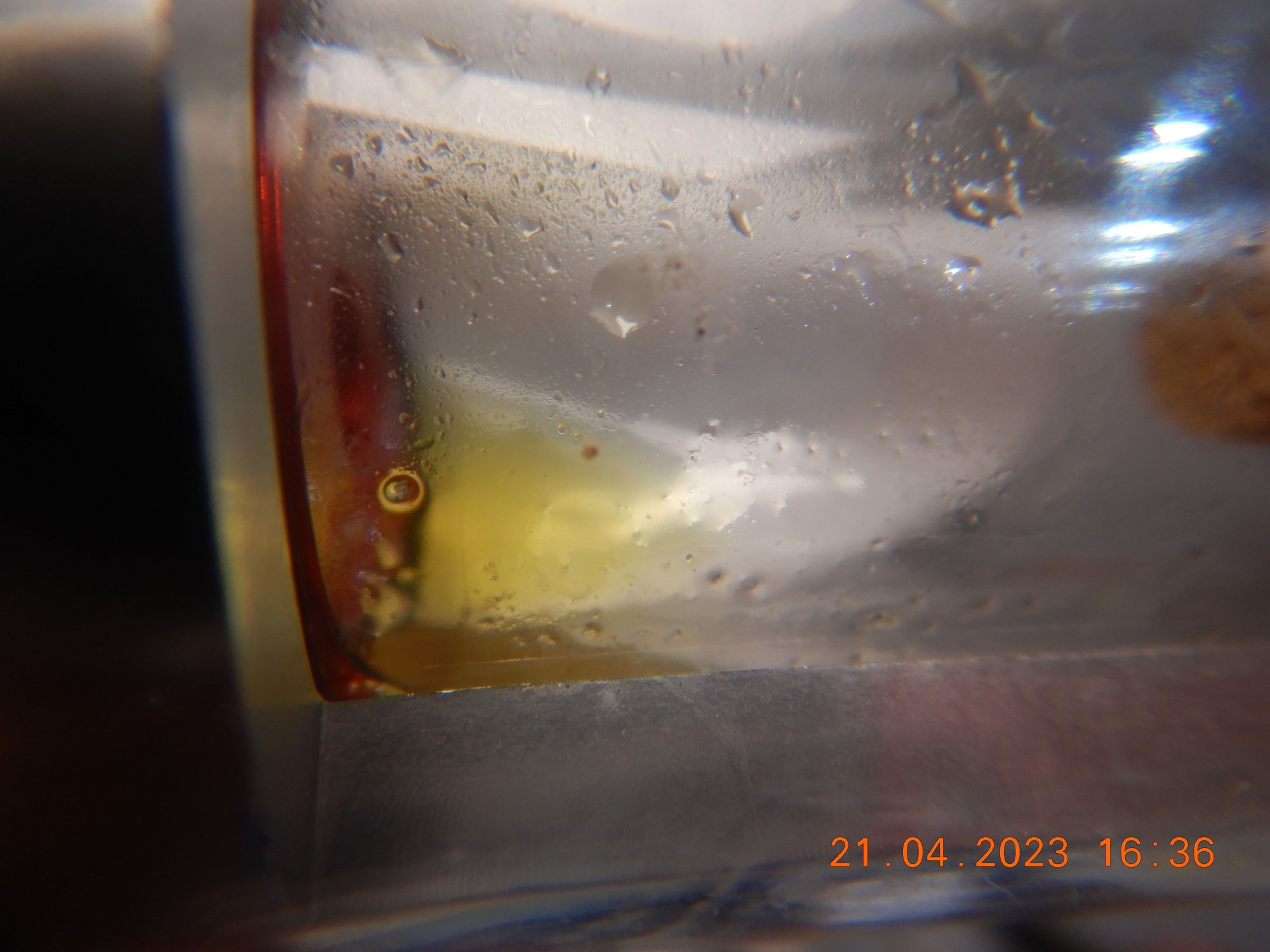

This is my compressor oil and R134A after first RRR of April 2023.
But my RRR is not Recover-Recycle-Recharge, it is Recover-Replace R134a with virgin one as the recharge. No such thing as RECYCLE.
After recover it is always the vacuuming, and I do a long 12+ hours to really dry the system.
Here is much clearer R134A in liquid form, because of the deep vacuuming process, the compressor oil is still yellowish.
Compressor oil
Left, 21st april is before 1st time RRR. This was MB Indonesia crappy work in 2014 when they assembled the car. Right side is after first RRR of 21st April and I inspected it on 6th June.

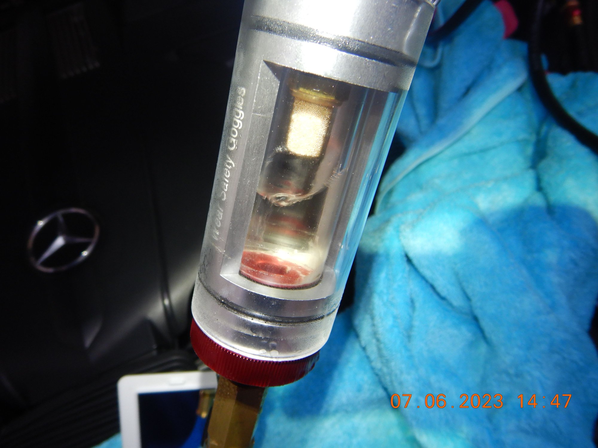

7th June, I tried to "clean" the oil using filter drier and I took out some compressor oil too.
Result

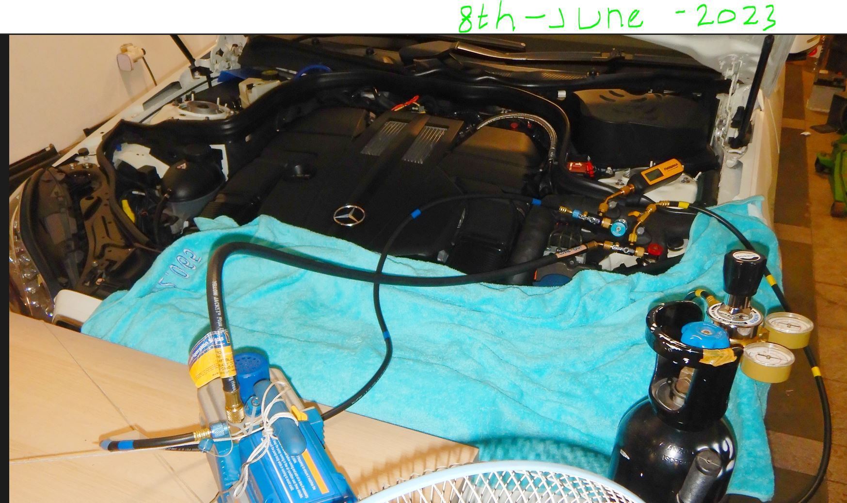

8th June, I recover/suck out my 3 months old R134A of first RRR.
9th June I added new compressor oil, matching the same amount of oil I sucked out. Only 10 grams of oil. Total oil in system is supposedly 120 ml.
This oil is like 1 gram per 1 milliliter, heavy like water.
This is 10 grams or milliliters of ND-8 Denso
I vacuum dry the compressor oil first. See the value 60 microns and the high peak ( moisture explosion ) 100+ microns.
1 Atmosphere at sea level is 14.7 PSI or 29.9213 inch of mercury or 760 millimeters or 760,000 microns.
So 60 microns is super dry and you can't even us analog gauge to measure 1,000 microns which is crazy wet for HVAC system.
1 inch hg is 25,400 microns
0.001 inch hg is 25.4 microns.
0.010 inch hg is 250.4 microns
0.050 inch hg is 1,202 microns
0.100 inch hg us 2,504 microns <<< you can't even see analog gauge 0.1 inch hg resolution
Clean clean clean.....I am so happy.
No more yellowish oil and now super clear R134A.
Soonest next year I will do RRR again, and replace refrigerant drier and 3 HVAC hoses and all o-rings at EVAP ( 4pcs ) and o-rings at compressor which is already
at the new hoses. The only hose set I do not replace is the one with internal heat exchanger IHX. The IHX hose set ( LP and HP ) is not at HOT ZONE true engine bay, it is behind fake firewall.
3 hoses new and refrigerant drier will allow me to replace approx 60 milliliters of compressor oil, out of the 120 ml.
Thus I have the chance to renew my compressor oil too.
Doing this I hope to never ever have to replace my EVAP dues to compressor black death. I do not ever want my entire dashboard be removed !!!
I can track per 2 years my compressor wear and tear and can replace it when it is "weak" but not total loss yet.

https://cimg0.ibsrv.net/gimg/www.mbw...0163c3d2e9.jpg
https://cimg6.ibsrv.net/gimg/www.mbw...6c92b498a8.jpg
https://cimg0.ibsrv.net/gimg/www.mbw...8059bed8fc.jpg
Thanks for the insight, happy to had the opportunity to read about it.

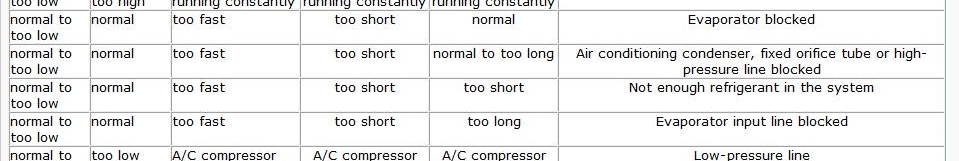

I forgot to ask, is short cycling an issue with car a/c compressors? I understand it is for home a/c units, as the thermostat usually won't let it start again until 5 minutes later.
Check my diagnosing charts above. Specifically, this...
Old May 9, 2025 | 02:42 PM
  #941
W205C43PFL's Avatar
Posts: 32,372
Likes: 6,327
https://cimg5.ibsrv.net/gimg/www.mbw...edf73ead03.png
I understand I have that downloaded on my phone already, my question really was is short cycling an a/c compressor in a car an issue, as in general. I am not talking about the problem I am facing but as in in general. Sorry for the confusion.
