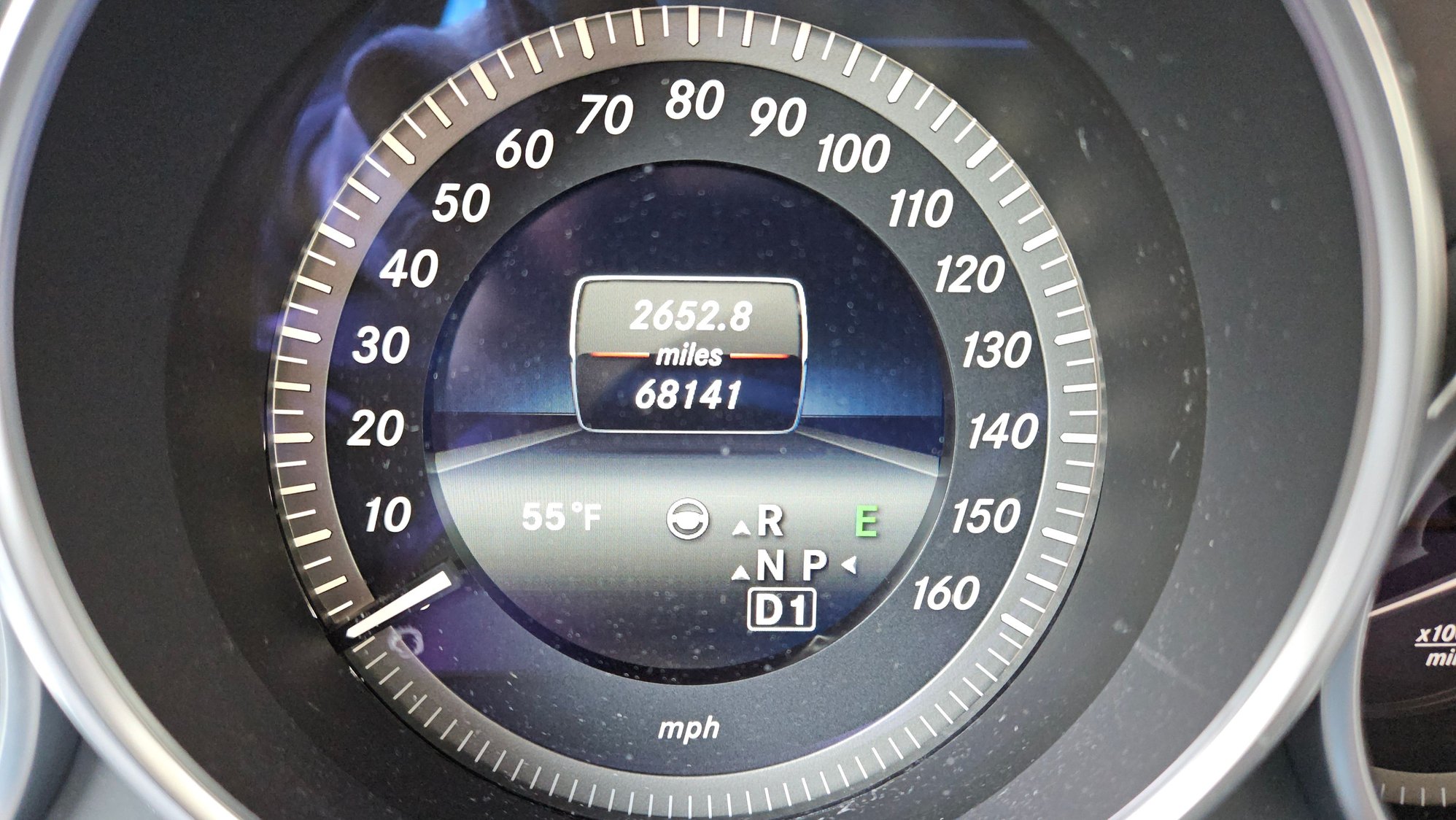

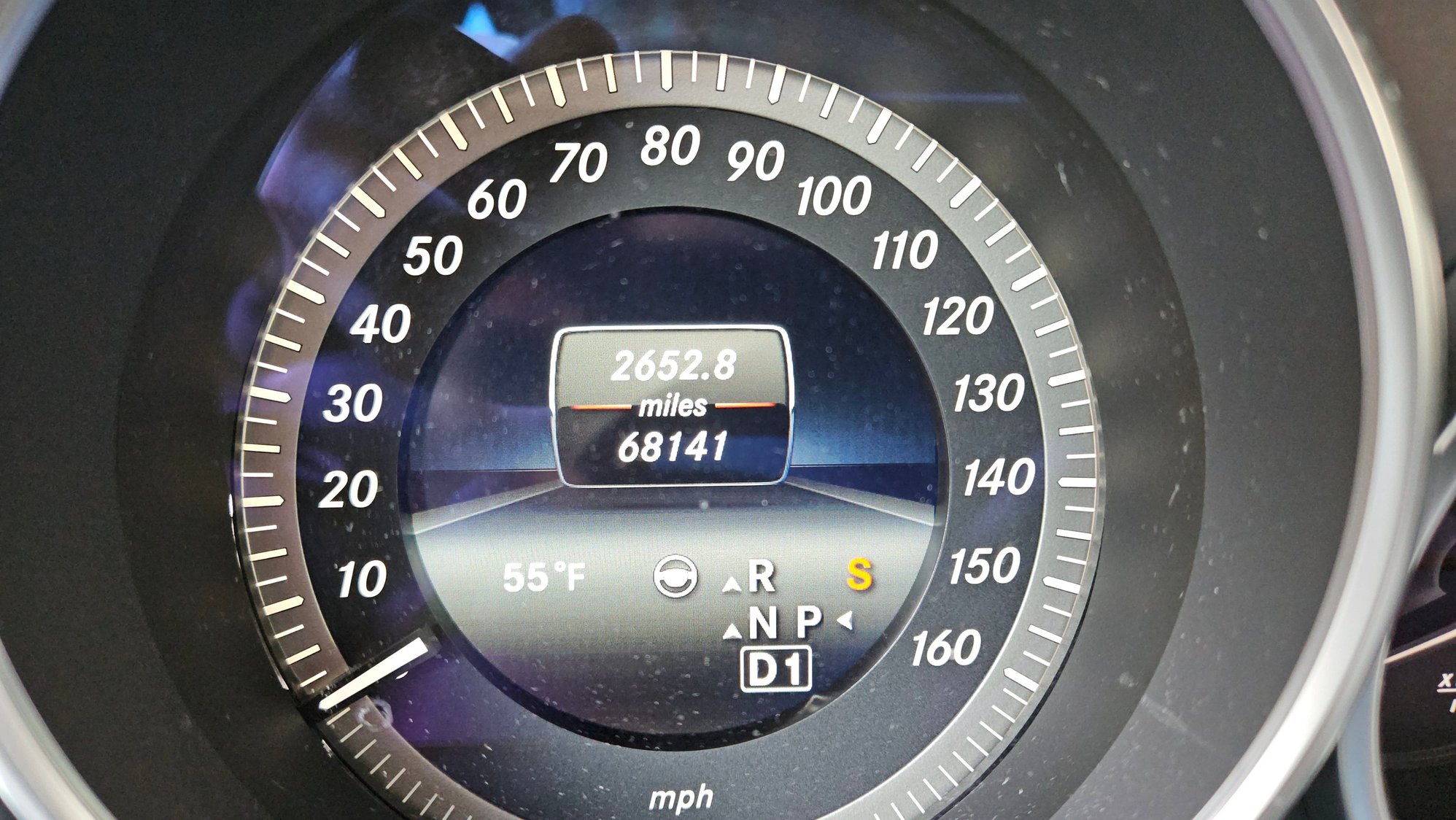

722.9 stop in 1st vs. 2nd gear
TCU stops in gear 1 (E-mode)
TCU stops in D1 gear (E-mode)
-- Does your 722.9-Plus TCU stops in 2nd gear ??
Normally it should stop in 1st gear.
TCU stops in gear 1 (S-mode)
TCU stopped D1 gear in S-mode
-- If TCU adaptations are messed by engine lag, then your powertrain likely also drives in high gear at 20mph, right?
meaning a heavy chassis always in the wrong gear with a laggy throttle = stock!
-- TCU stopping in the wrong gear examplifies poor gear selection.... I used to have this bug since factory!!

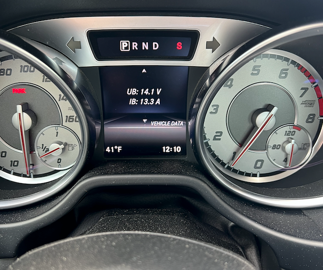

The car held steady at 14.1V +/-0.1V, but mostly at 14.1V. The Amperage did drop down after the car settled down a bit.

FLOAT TIME !!!
14.1V is PERFECT but...
13Amp is still high!!
meaning your battery is not neutral
Go ahead do your [Float + Reboot] steps to get direct rewards... you will notice engine response is really voltage-touchy.
This is why I say chassis is not compliant with dynamic 12.6v/14.9v voltage. Chassis tolerates unstable voltage by detuning engine.
14.1V/13Amp is not like 14.1V/1Amp
I do know this paradox hardly make sense !!
Practically there is dropped voltage in prefuse.
Go ahead test drive the difference: the reality is amazingly rewarding.
+++ Dynamic Resistance is called IMPEDANCE matters !
The coil circuit drawing spike current is much more efficient on low impedance source.
Meaning we get better voltage spikes from low power supply impedance.
> Charged up AGM is a must!!
> Improvement likely all ignitions
+++ INJECTORS vs. COPS !!!
Piezoelectric injectors are also based on voltage (I think around 150V actually).
If injectors were tweaked by ALT-LIN better voltage, the fuel map increase after a while would settle back down to nothing changed like without MOD...
The fact we get stronger response as adaptations improve means engine is burning better and earning richer fuel map from cleaner timings.
So that means ALT-LIN Voltage helps ignition spark factor!!!
+++ Ignition HARNESS UP FOR TWEAKING...
-- If battery impedance is a factor in ignition that means the ignition coil harness circuit needs attention.
-- Goal is a lower impedance to get higher voltage spikes. Wiring AWG needs to pass the spikes not the average.
-- The way this is touchy voltage hungry means it may be in the 20 to 30%... not in the insignificant 5% range.
-- Also electrical circuit distances to (+12V.) supply & (0V.) GND needs to be ALL equal to keep cylinders balanced.
-- I sort of recall MS! showing that indeed the factory ignition circuit was unbalanced because I remember making that comment. This is a serious harness No-No.
-- I wonder if there's a correlation with damaged Cyl near the main pullley (V8:1+5; V6:1+4)
-- Voltage affects Timings + Heat.
The amperage did settle down once the car was running for about a minute. I think it was down to 3A or 4A. I'll check tomorrow and pay closer attention.
oh, okay this is about what we could expect from a good AGM after starting.
Even fully charged up, after cranking battery needs that kind of current to top off again.
Gradually decreasing to below zero current in about 15Mn drive.
Alternators are poor battery chargers because they are only voltage regulated and not current limited.
