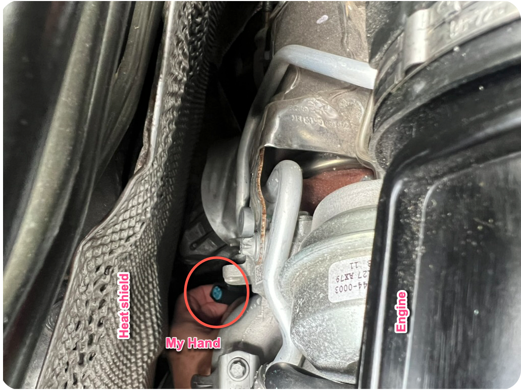

@Manny_c450 Any success? Although I am unable to successfully get it done today, I still hope you were successful.
Old Jan 16, 2025 | 08:20 PM
  #106
Manny_c450's Avatar
Joined: Mar 2022
Posts: 79
C450
Putting son to sleep then I will get to work in the cold -10C garage and report back hahaha
Mine looks identical to yours, hand got to the connector but not able to get enough leverage to really pull anything off .I thought I had the clip by feel but not sure.
Will have to try from the bottom unfortunately.. maybe tomorrow.
Interesting but I don't feel any clip at all, you felt something? Why does our cars' connector look so different to forum member CaliBenzDriver and JettaRed's?
If you do end up going from the bottom tomorrow please kindly do take picture of how it looks from the bottom so we can figure out this mystery. Much appreciated!
Thanks for your update tonight.

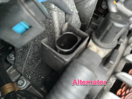

ALT-LIN
similarities
similarities
your connector looks similar except I'm missing a ziptie on the crown.
  • same barrel
  • same lock
  • same harness
  • mounted 90° side vs. rear

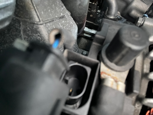

https://cimg6.ibsrv.net/gimg/www.mbworld.org-vbulletin/1080x1105/screenshot_20250116_211317_chrome_b3f4764dbd36fe37 d9e4241d7463a17a1b9355e1.jpg
similarities
  • same barrel
  • same lock
  • same harness
I too wish it was the same thing : ( but how do you explain this cone thing, if it is some rubber protector or something, how do I get it off to reveal the familiar plug? https://cimg2.ibsrv.net/gimg/www.mbw...ea654545a4.png
I think that is just part of the connector and the zip tie is to provide strain relief.
Old Jan 17, 2025 | 10:36 AM
  #118
W205C43PFL's Avatar
Posts: 32,666
Likes: 6,417
I see, but how come yours and everyone elses' is flat and ours is cone shaped?

We see the side mounted connector near ALT +12V OUT-Stud
The "cone hat" is just for harness strain relief on top of exactly the same connector.
As long as it's single wire it's a go for your case!!
(Dual wires need investigation).

Unsuccessful, my back killing me from the top can't imagine crawling down to do this. Can't find tab, can't rid of that protective cone hat you mentioned, I started working on it since noon today till sunset, I am getting nowhere. Hopefully forum member Manny_c450 has better luck. Eager to hear him reporting back.

I am starting to wonder if MB started making it a permanent plug, hopefully not but I am not as optimistic as you : (
trying later today, the temps are way more decent today. Did you try from the bottom this noon?
