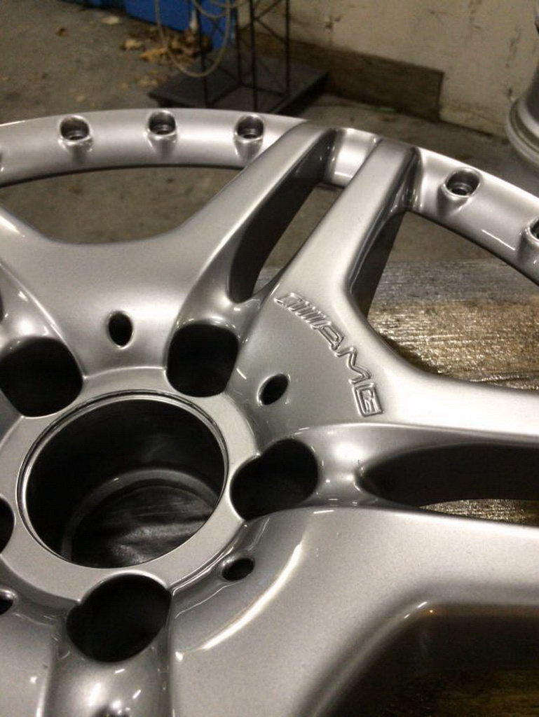

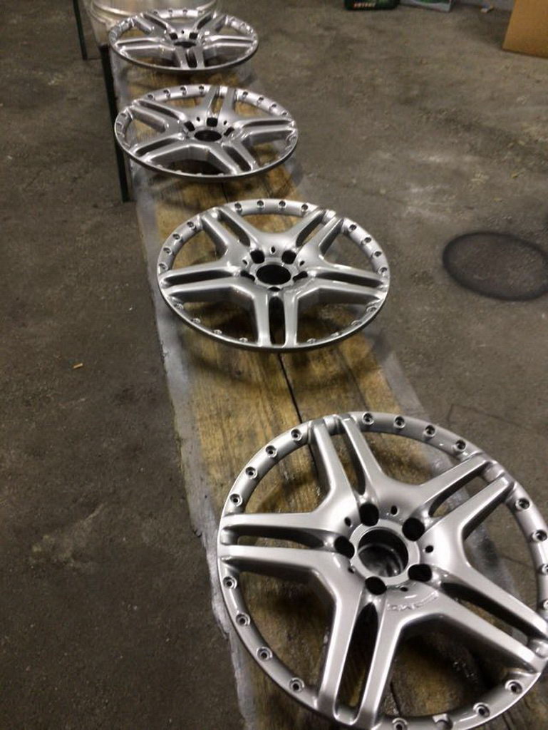

And again ... a "small" update

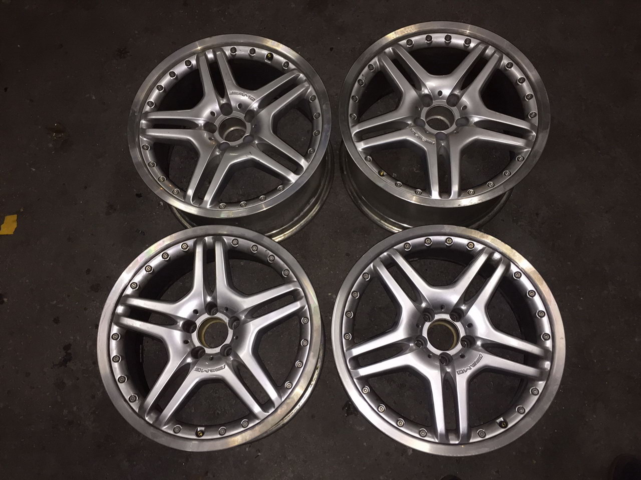

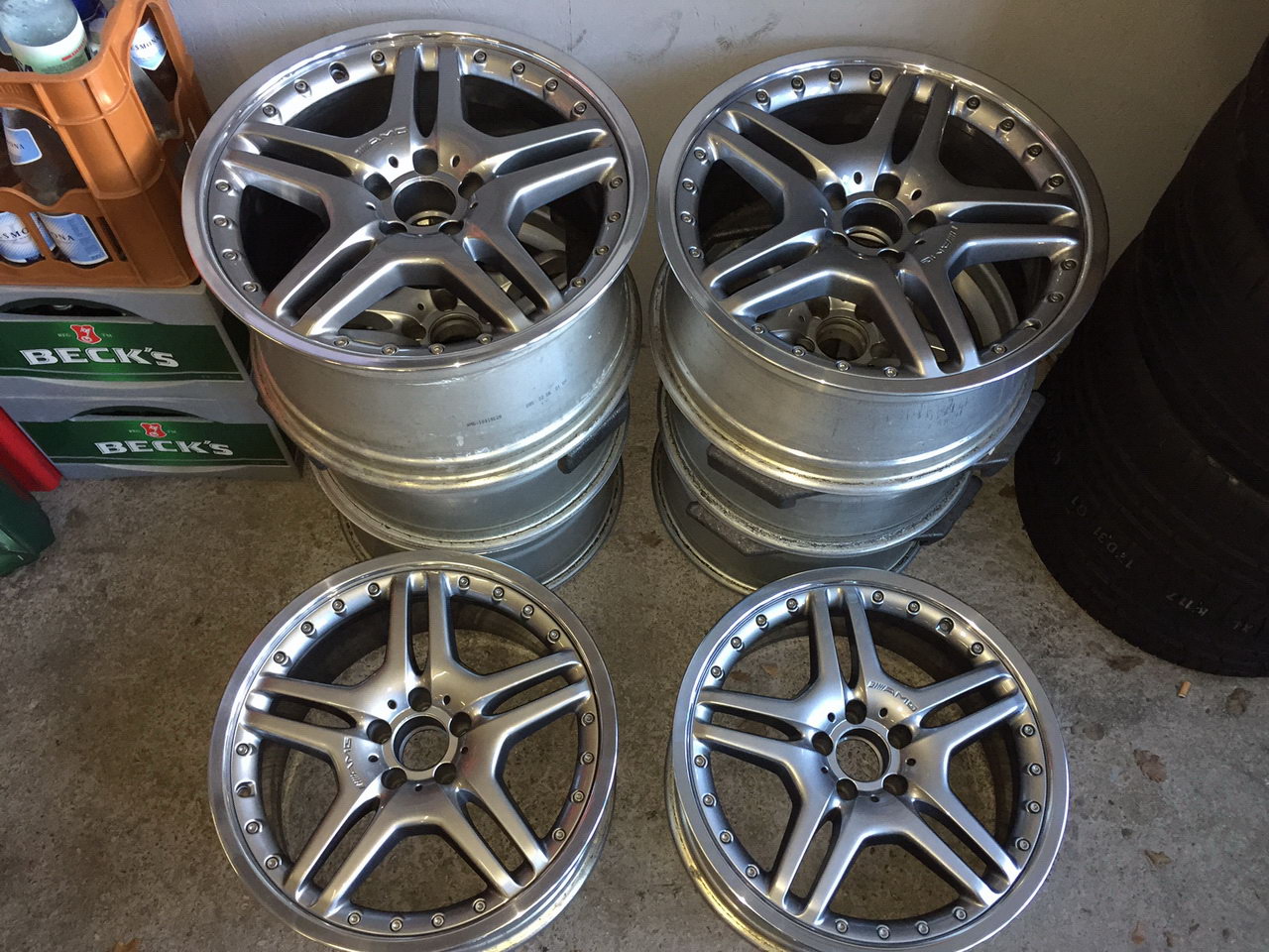

New Rims incoming

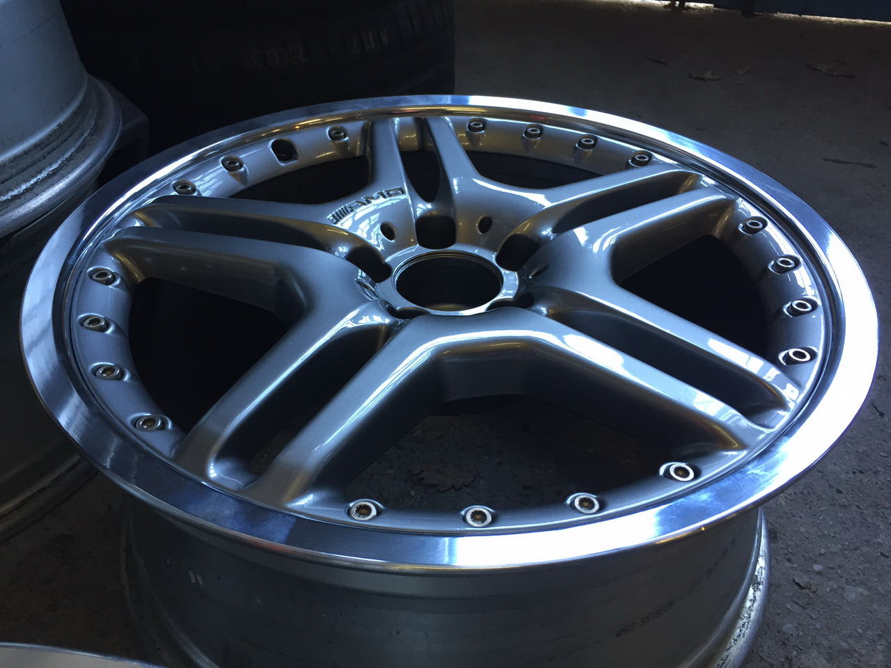

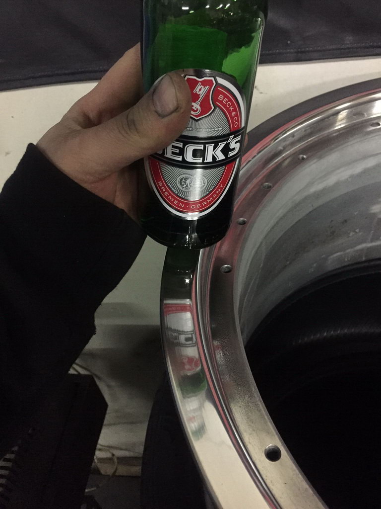

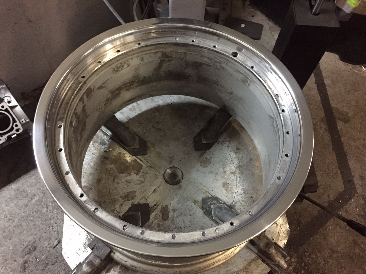

After i received the Rims i checked if they are technicaly ok.
polishing
i did this on our tire mashine, quiete a lot of work but in that case ok for me

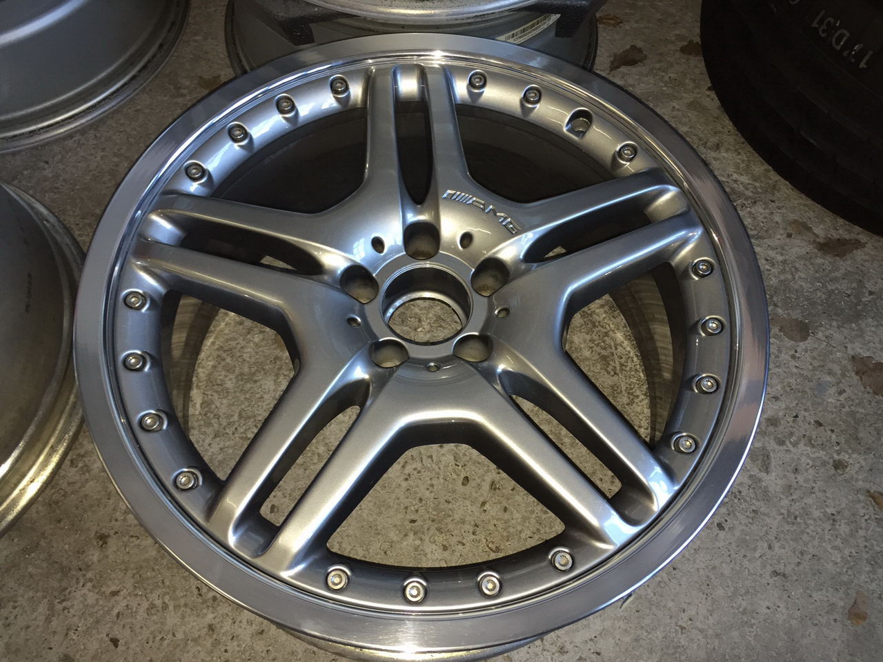

I ordered the original "Titan Grey" Color. i tought it would be a bit darker but at least ... a really nice color for rims. probably the original "titan grey" rims from SL65 where painted in himalaya gray what i a little bit darker then titan grey.
Clearcoat.
nice color
Have to sit there until the paint is really dry. after that i can fit the tires.

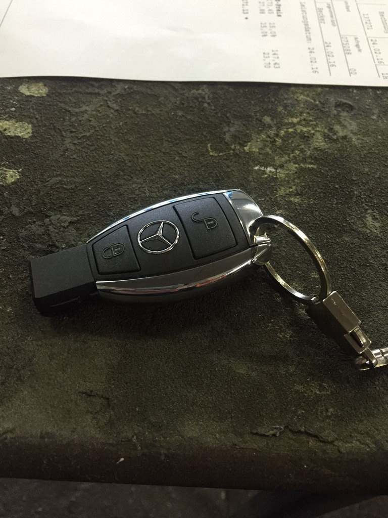

and also i ordered a new key for my baby

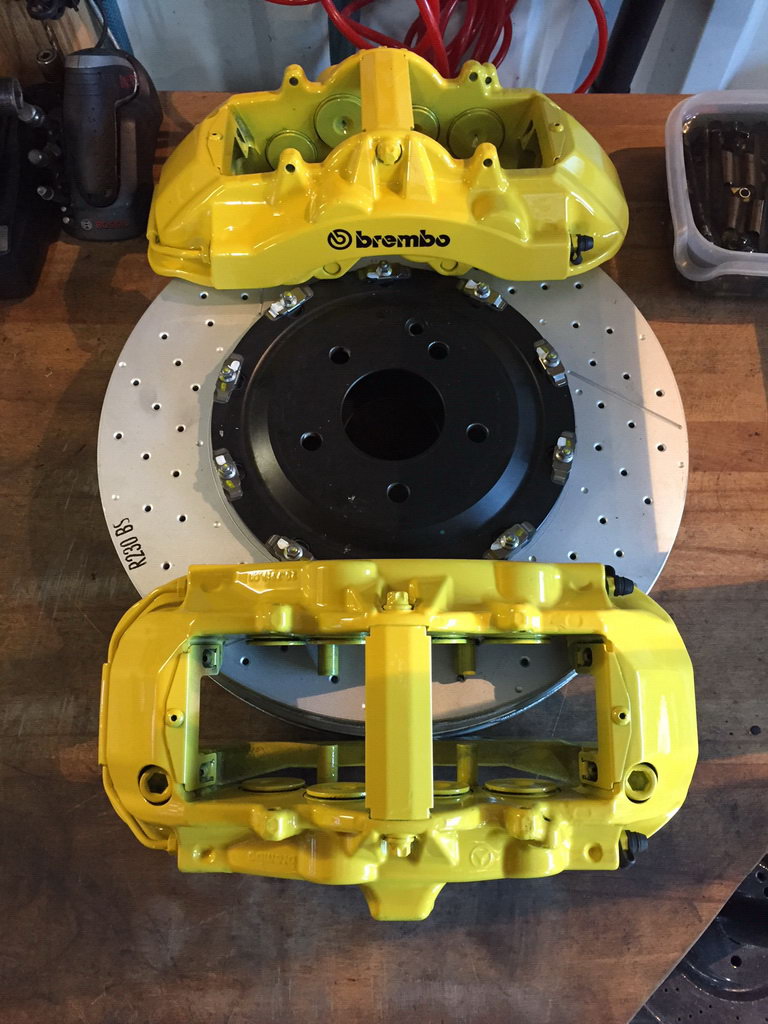

And also a new Brake Setup is planed.
390mm from SL65 with modified 2-piece rotors also from SL65. i used different hats to fit the W210 Axle.
actually i am waiting for the brake pads to arive
greetings, Fabian

C43 w/clk55 Organs
Looks really good Fabian, nice touch on the wheels!
Why change the brakes? are the SL65 superior in any way?
Old Apr 24, 2016 | 06:02 PM
  #483
kaype's Avatar
Joined: Apr 2013
Posts: 343
Likes: 48
W109 300SEL6.3, W123 280TE, W123 200T, W210 E55

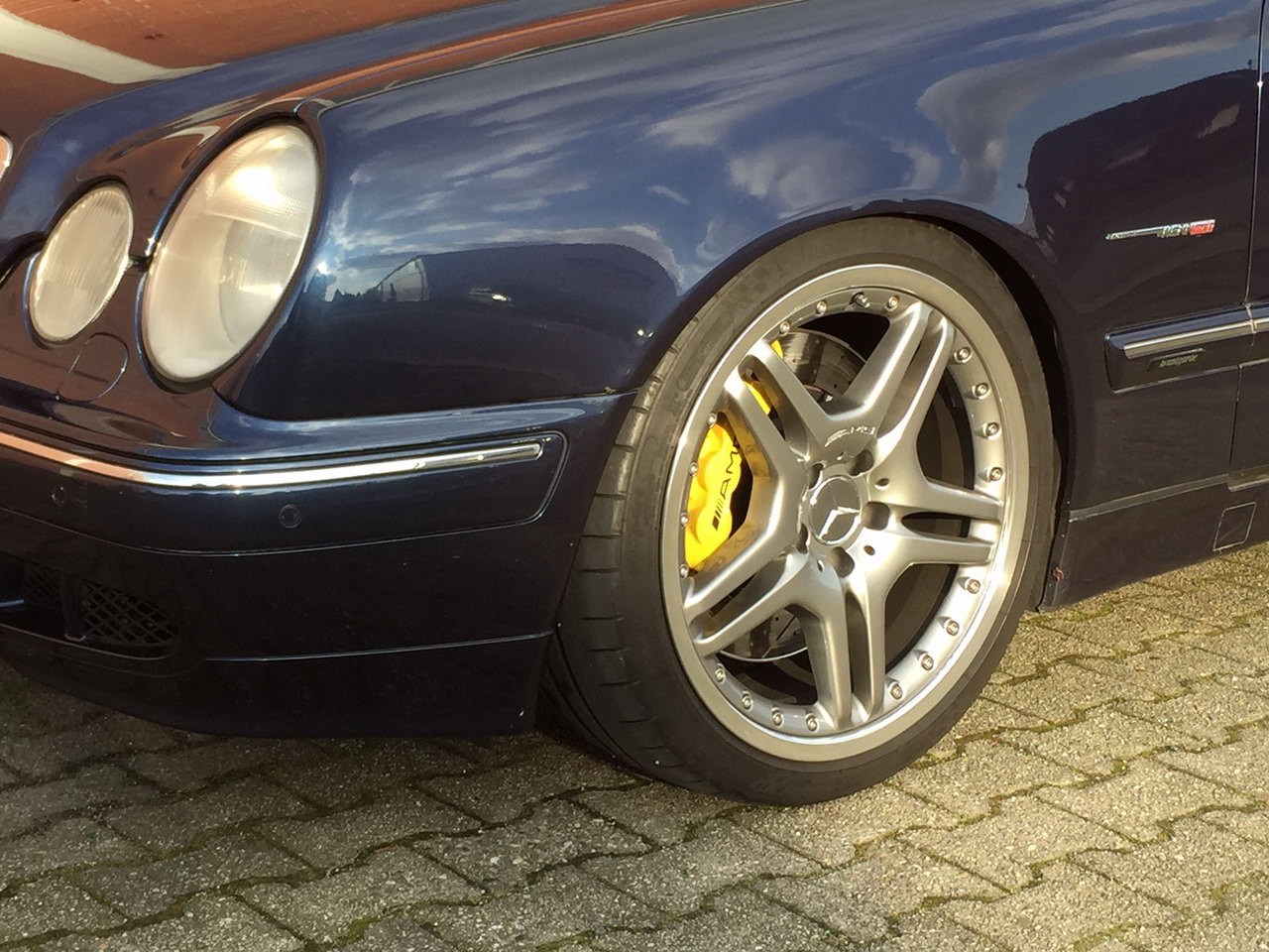

Thanks
they are 8-pot 390x36mm instead of 6-pot 360x32mm :-)
As you can get really fast in germany, germany is the only country in the world without a general speed limit as far as i know, you really need good brakes

And done
Great brakes! Unbelivable stopping power.
Need to say: these are 19" rims

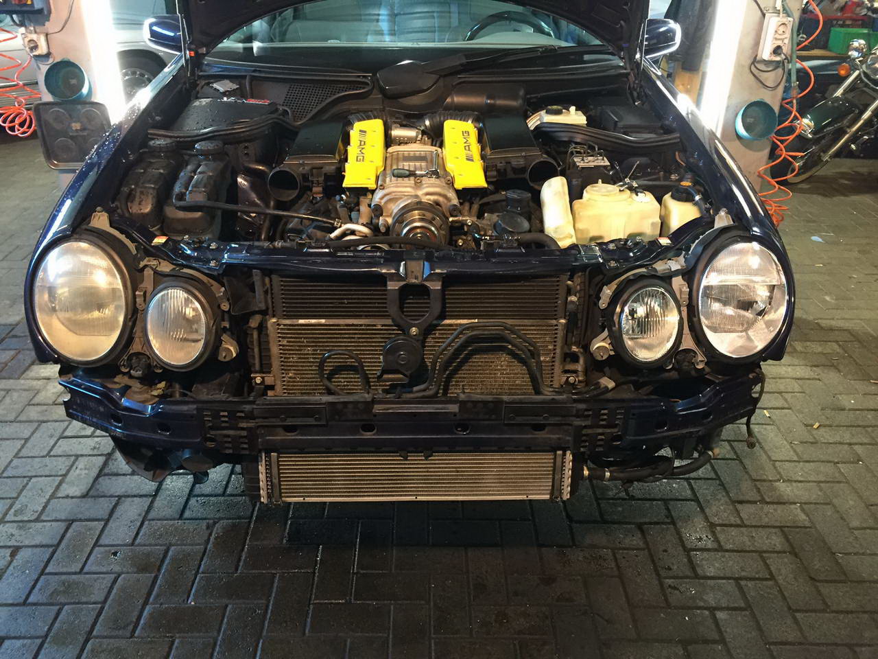

in the middle of the year i scraped down a CL600 with M137 and used the Engine for a nice table in my garage:

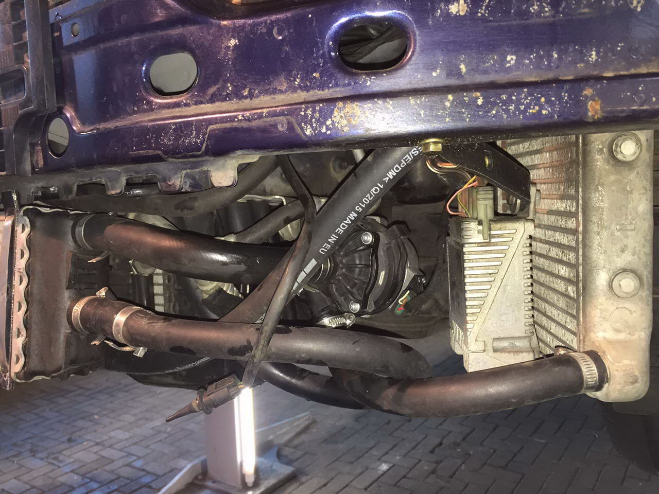

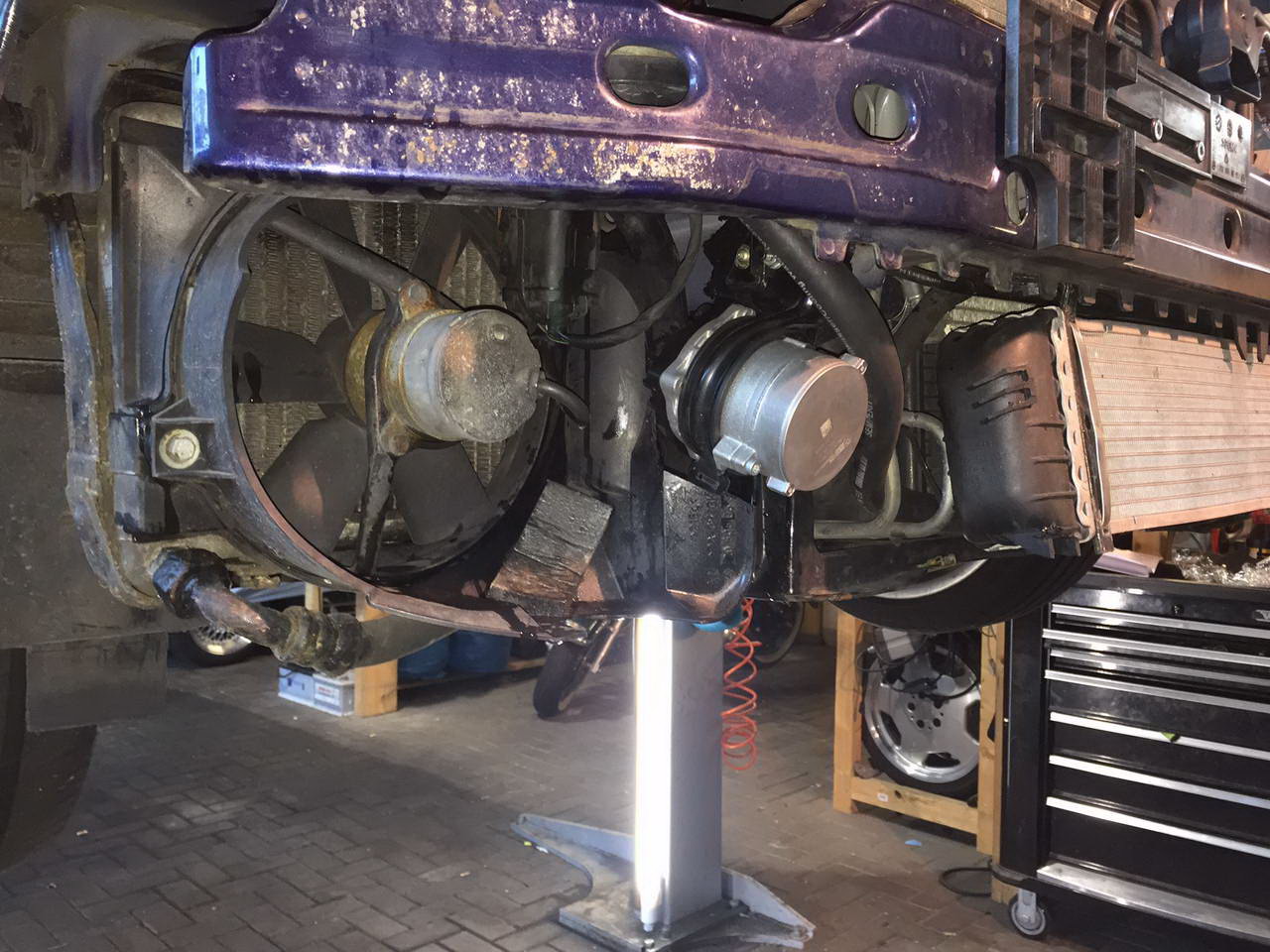

After that i decided to get rid of the 2 CWA50 Pumps and use CWA100 instead. They are much more powerful.
a first test was around 22L/min. ... with 3 Radiators. Original Cooling has 1 Radiator and around 11L/min.

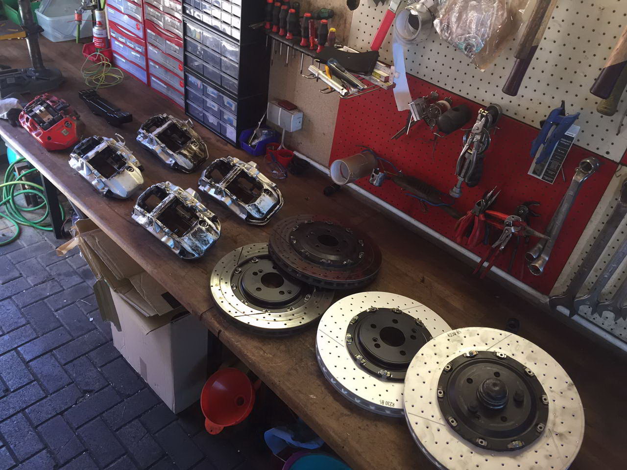

Next step was to get rid of some brakingparts i stored for my recent brakeconversion to 390mm brakes... i had quiete a few AMG Brakeparts

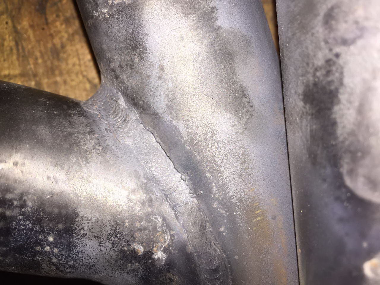

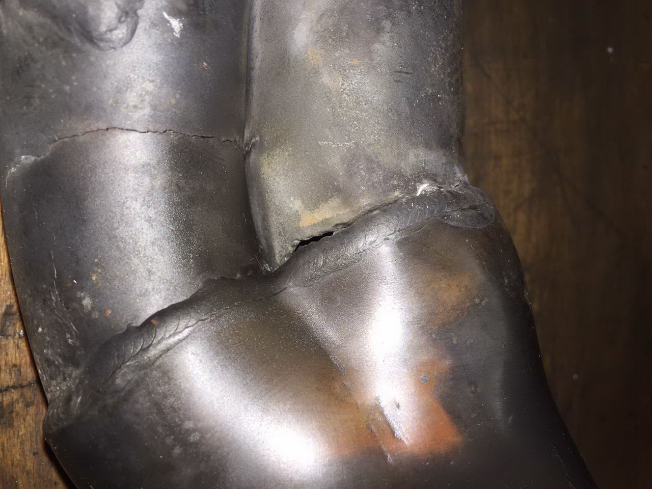

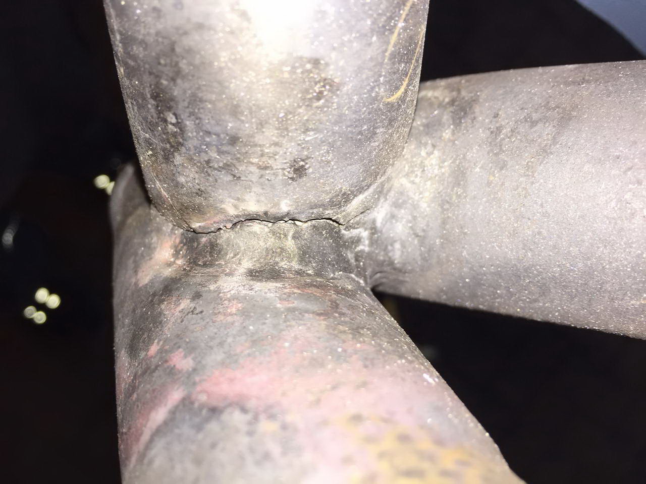

Then came what must come ... my kleemann headers had some "problems".
i welded them and Claus from Kleemann replaced the right one. But i must say ... i wasnt happy with kleemann headers so i started to search for another set.
to be continued...
