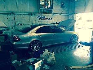

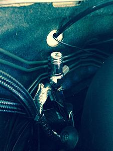

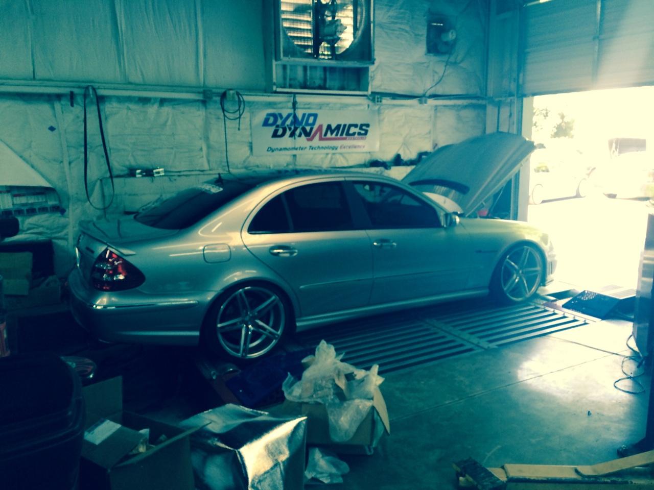

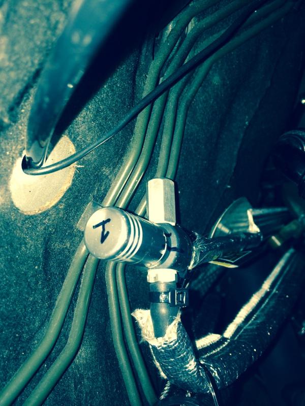

back on the dyno this morning with the manual boost controller installed.

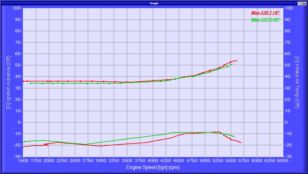

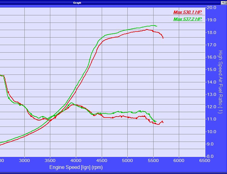

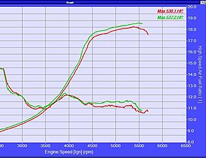

back to square 1, breaking up again. does it at 14,15,16,17lbs does not matter what the boost is.
at this point, I don't know what else to do. extremely aggrevating!!!
graphs from today.....
Attached Thumbnails another twin turbo e55 amg is born at BIP-boost-hp-tq.jpg   another twin turbo e55 amg is born at BIP-boost-ign-iat.jpg   another twin turbo e55 amg is born at BIP-2014-07-28-18.54.29.jpg

Man, that sucks. Look at how hard that line is taking off before the breaking up.
What part number is on your MAP sensor?
