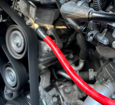

Holy crap that scares the poop out of Me. I will stare at that wire for 2 hours before I get guts to cut. lol

Originally Posted by QuadTurboPrius
Yeah - same. I see on the BATT-LIN topic that disconnecting this can disable the start/stop -- is that true?
...And, while that does look like the right schematic for my car, I would never cut into anything without being 100% sure of what it is .
I've decided to go back to basics and just monitor the voltage for now. If it doesn't cycle, I suppose I can infer from this thread that I am not having issues? I suppose this doesn't mean the CAN isn't having errors/retransmissions, but it seems like voltage fluctuations is the signal that something should be addressed.
1 - ALT-LIN does disable the amazin' ECO Start/Stop. No programming necessary.
2- By design Voltage swings at least from float to bulk.
That is what's being solved here.
If you don't have engine lag, tranny issues or extreme heat then no reason at all to sway from stock.
If you have weak engine throttle driveability then that is motivation to act.
Be sure to match chassis VIN for good color/pin No.
Pulling Alternator plug is a PITA on TT
You have options.

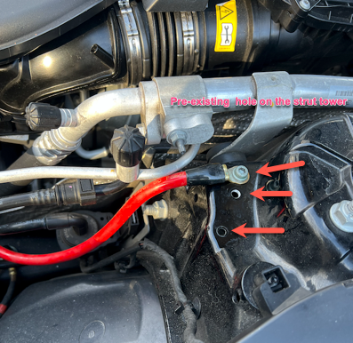

Just for Cali, I made a modification today. I added a chassis to engine ground strap.
On the strut tower, there are three little holes that I have no idea what they are for. So, I took a 6mmx1.0 tap and threaded one of the holes. I had a 6mm bolt that I used to attached one end of the cable to strut tower and the other end to the timing case near the oil filter. This was a quick job and I may need to change the connections, but I thought for now I would do it and see what happens.
and for Mstr Surya too...
We enjoy reliable GND circuits - Tons of weird electronic problems never to be had
Underated capacitors won't get overheated by significant ripples.
> Fun testing:
During installation... before closing the circuit see if you can light up a sensitive test-light between chassis and engine GND or use a DVM.
