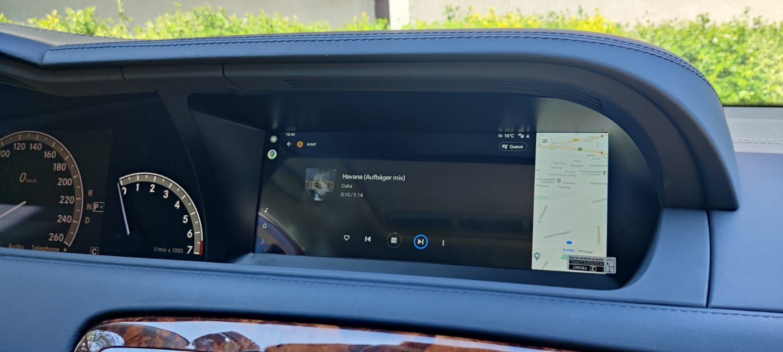

+1 on the audio quality downgrade here, unfortunately. Android seems a bit better, but not as good/clear and crisp as the OE hardware (e.g. when playing CD or even a ripped track from HDD). But to be honest, this is really not the issue when you are cruising over 50km/h when road noise covers up any sound deficiencies you normally hear when the car is stationary and the engine is off...
One distinct difference between box and Android screen is the implementation of knob controls:
The Android is weird when it comes to the integration with the OE control knob: you can still "scroll" left/right between icons when in native Android mode or when in Carplay/AA, but when you try to switch display segments in Carplay/AA mode, it just does not work as expected. So when your google maps is showing, you cannot simply press "right" to move over to the Spotify app (or switch the google to spotify without pressing the screen)... it's not a big annoyance, since it's a touch screen, but it is something that box users don't have to struggle with. Also, 1 in 5 times, the knob does not work at all until you switch back and forth between OE and Android mode... (press back 3 secs for OE mode, touch the screen to go back in). Never happened to me on the box.
On the positive note, Android unit has the "next/back" controls implemented, when you push/pull the knob forward/backward - this allows for the music controls regardless of the place you are within the interface - to get to the next song in the player you are currently using simply pull the knob towards you... Box does not have this up&down thing implemented, but instead allows to naturally switch between split-screen apps (left/right) and scrolling navigating to controls you look for by simply scrolling and confirming the selected control by pressing it down...
Neither box nor android allows for full left/right/up/down map scroll when using google maps... which is a shame. Android is clearly winning here since you have the touch.
Having said that - my choice is always to go with Android with NTG3, and stick with the box for NTG4+. I had W221 and W216, both equipped with two different generations of 10.25" screen (android 10 - post 399 and 422 and recently newer unit with Android 11 in my late CL), and for E and CLS and W222 I decided to go with the box, mainly because I don't mind the small screen (which TBH on W212 and W218 looks cute when fully implemented - screens here).

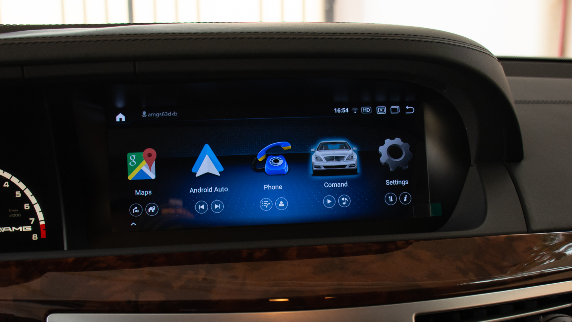

I keep reading about gaps. Not sure what you guys are doing but there should be no gaps. Granted this is in a 216 but if you’re having gaps, you need to double check your install.
Old Jun 11, 2022 | 07:02 PM
  #612
conmee's Avatar
Joined: Nov 2013
Posts: 39
Likes: 23
2013 S550
Thanks for those detailed photos. That install looks great. I'd be perfectly happy with that install.
